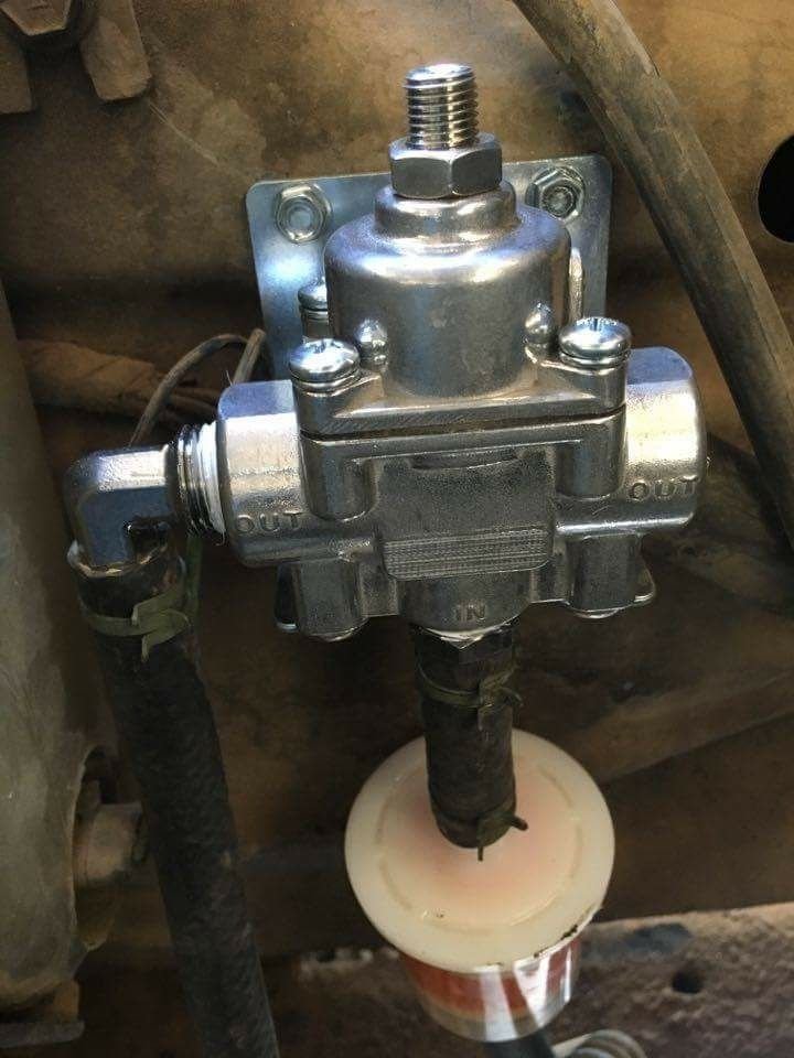

I ordered the Summit regulator, and enough hardware to actually install the darn thing. Hardest part was picking out a spot for the regulator, but I settled on the inner fender, drivers side, ahead of the window washer solvent reservoir - pretty much in-line with the former mechanical pump. Used my handy punch to make two dents, then drilled a couple holes...

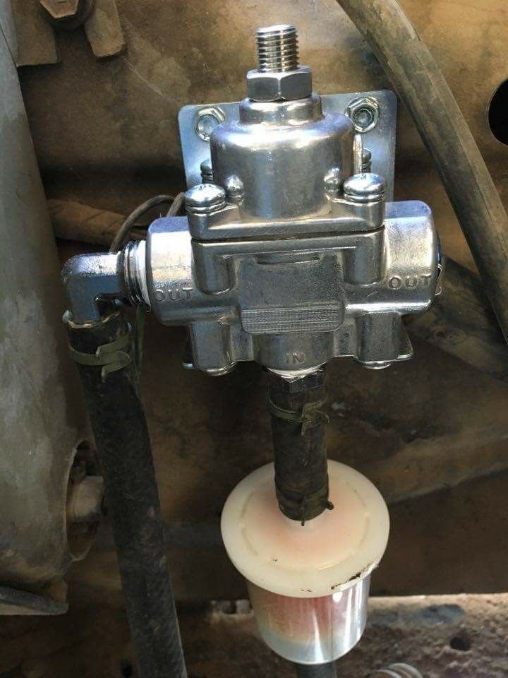

Assembled the components to the regulator. A barb fitting for the inlet, an elbow for the outlet, and a plug for the other outlet. Mounted the regulator in the bracket, then mounted the bracket to the fender...

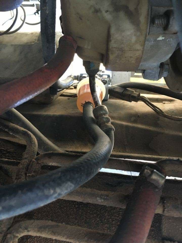

I thought I had done a fine job, until I reviewed the photos. The hose feeding the regulator was rubbing against the pressure line for the power steering...

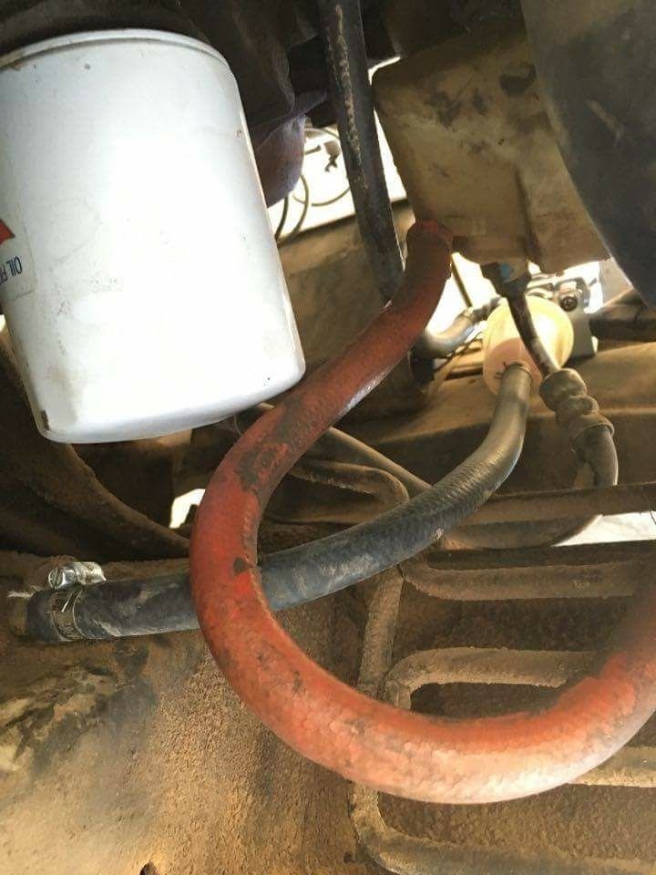

So I trimmed the excess from the hose, and now it has a nice smooth and unobstructed curve to the fuel filter...
I used a right angle 3/8" npt to 3/8" barb to send the fuel back to the carburetor without introducing another bend to the hose. This way, the hose lays flat (well, in the same plane) as the rest of the assembly

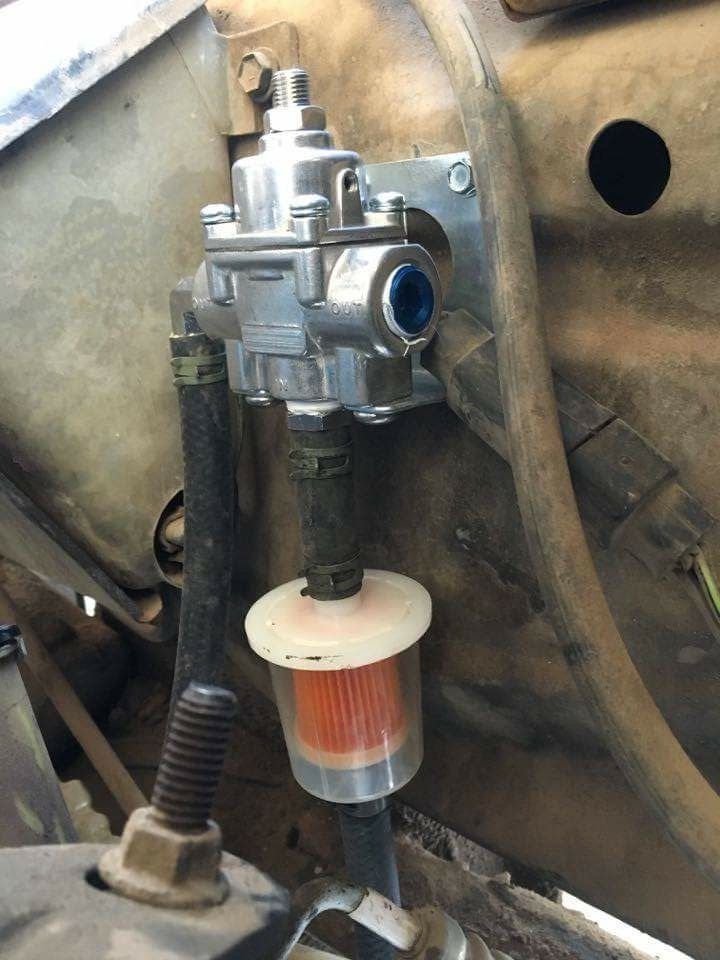

The regulator has two outlets, so I plugged the second with a nice anodized aluminum plug from Summit. I bought the package of four so I could use the others in the intake manifold or thermostat housing. Or in another regulator for another truck...
The entire assembly looks pretty good, I think

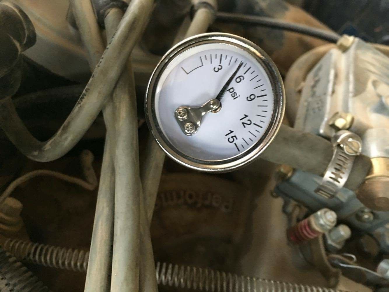

And the pressure at the carb looks good too.
