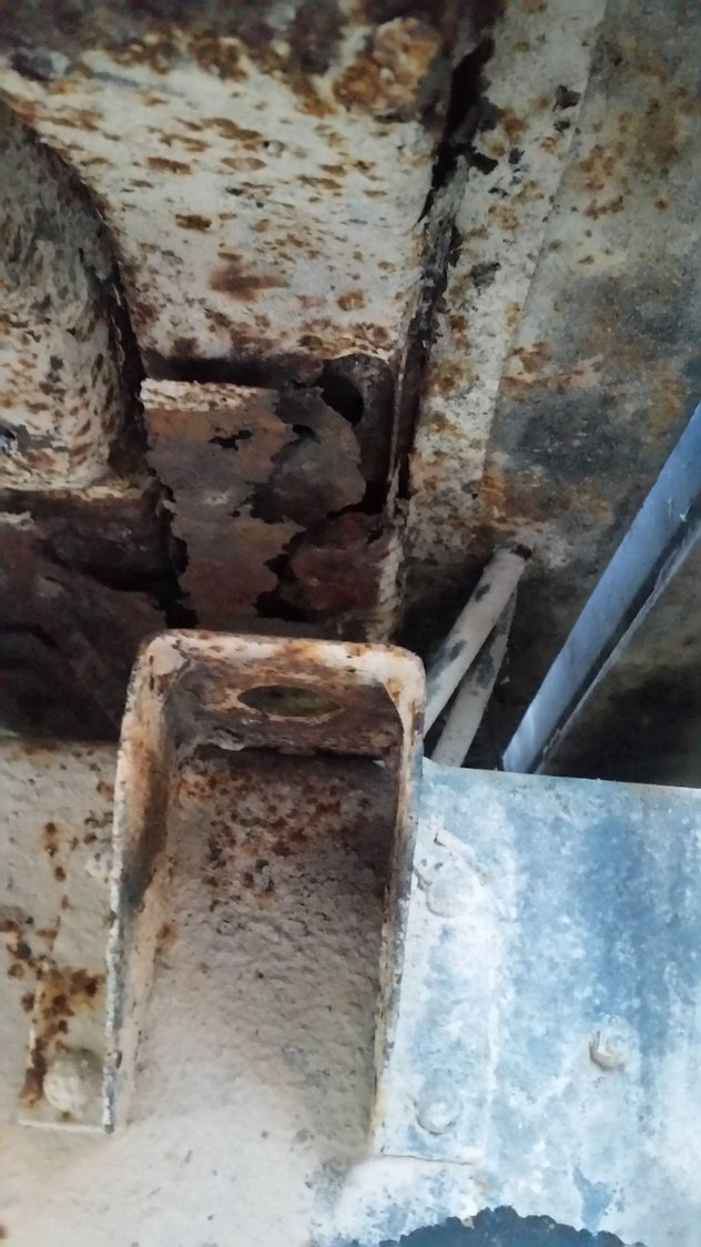

I've read this entire thread like 4 times and I still can't ascertain what the original poster is asking for.
Instead of posting a picture of the rust, why not just post a picture of what is leaking, then we can help you better.
This is the pump with the weak line connection that is sitting in the frame rail under the spot I'm doing the rust repair. The 90° fitting is the culprit, that line runs up to the tank. I noticed this while playing with the rust. When I get to the fuel systems check I'll need to deal with this. Thank you for your input and helping me to keep on point with my questions 😉
