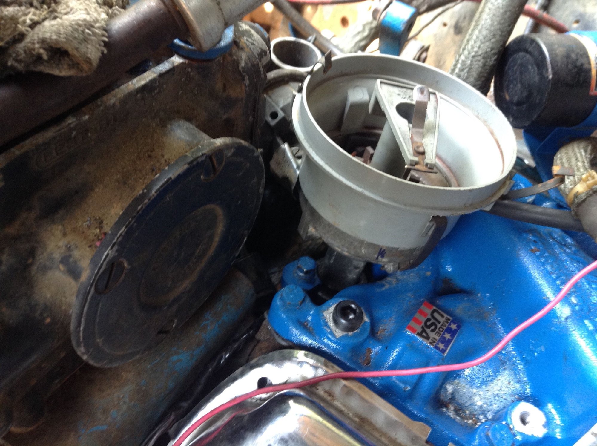

Here are some pics of my distributor when inserted. It seems to only line up withy mark of #1 plug when as far clockwise as it will go.
Old Aug 5, 2016 | 12:56 PM
  #45
hharris8's Avatar
hharris8
Joined: Dec 2015
Posts: 816
The first pic is as far as it can go clockwise and the second is in the middle of its range.
