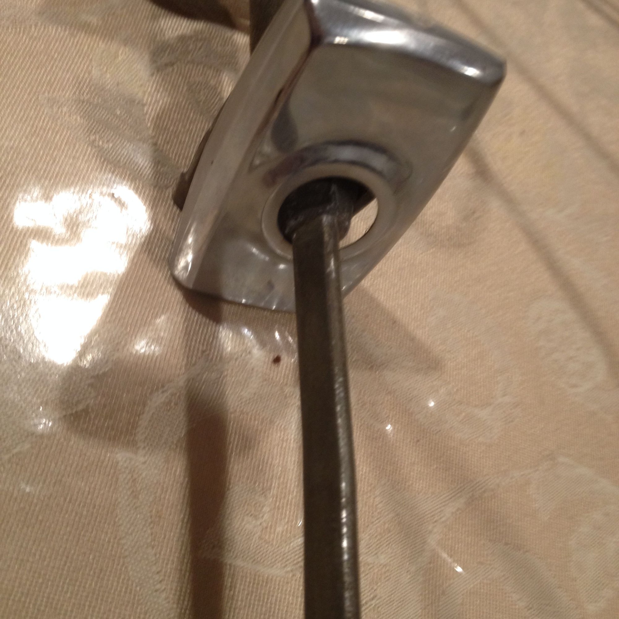

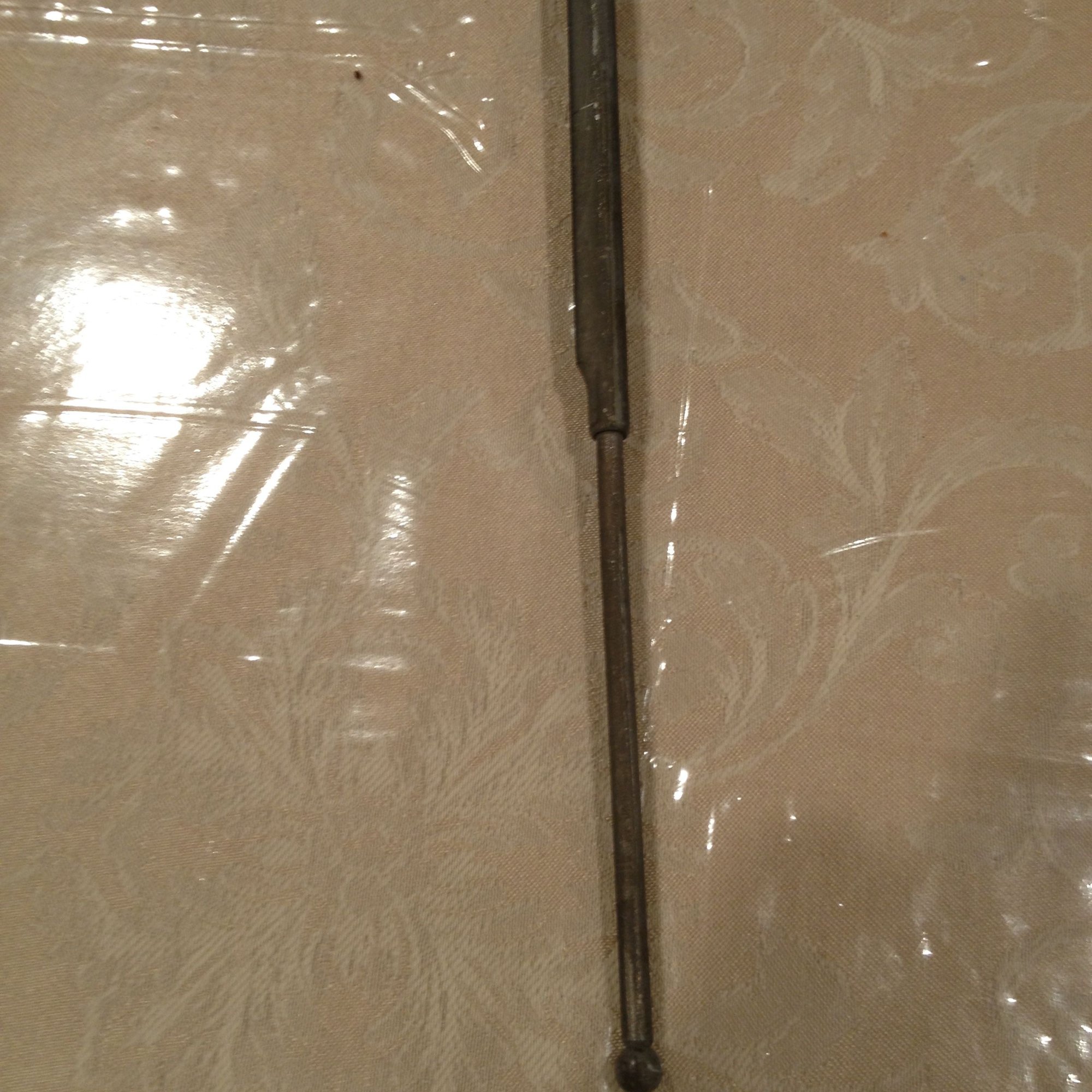

It may have been awhile since you looked up antenna stuff. Did you err when you said that the 67-72 truck have the airfoil? Or, does the 1973-1977 have the airfoil mast as you indicated in the old thread with the change being to the 1978 and 1979 model years (changed over to a round mast)?
If I can weed through this stuff... What I think is cool is the airfoil design was used on 68 Mustang and the same antenna was brought back 5 years later to be used on the Ford trucks in 1973 through 1977.
Further clarity is greatly appreciated. I recently found a 1974 F350 with what I believe is an airfoil mast. You guys will know better since I have never seen one. The base was rectangular. Now I know why I thought I had seen round antennas (mast) with rectangular base in the 73-79 generation trucks--they were probably installed on 78-79 trucks or possibly aftermarket or dealer installed . I'll see if I can post a picture or two of what I believe may be the correct antenna for 1973-1977 Ford trucks and the 1968 Mustang (Simply cool). Ford is a funny company when it came to parts.

Here they are:

Originally Posted by Sam's1967
Bill, please bear with me for a moment. I saw an old thread and want to get some clarity here. You commented on the airfoil antenna in the following thread:
https://www.ford-trucks.com/forums/6...o-antenna.html
This post was typed 1/2/2008, had nothing to do with 1967/72's.
It may have been awhile since you looked up antenna stuff. Did you err when you said that the 67-72 truck have the airfoil? NO!
Both my 1968 F250 Ranger & 1971 F100 Ranger XLT had airfoil antenna's. I bought both of these trucks new, plus I passed out these antenna's and masts to mechanics at the back parts counter.
The airfoil antenna is C6AZ-18813-E = 1966 Fairlane / 1966/68 Galaxie/LTD / 1967/72 F100/350.
The airfoil antenna mast is C6AZ-18A886-A
Pic: Scroll down to 18A886 .. Here's the only parts catalog reference (from the car parts catalog) that lists this mast as an airfoil.
The thing is, FoMoCo is infamous for replacing/updating part numbers more often then women change their minds!
1973: Ford replaced the C6AZ-18813-E airfoil antenna with D3AZ-18813-B (round w/rectangular base) for use as a "service part replacement."

There is a lot of information here and I am more confused than ever.
The photo that I posted in Post 10, is that of an airfoil antenna? If so, was it intended for a 1967-1972 truck or was it original to the 1973-1979 (or 1973-1977 trucks). All I know is that the one that I posted in post 10, was picked from a 1974 F350

The airfoil antenna is shaped like a triangle.
The one that came off of the 74 appears to have a triangular shape.
In Dennis Carpenter's 1967/79 online catalog, he shows an antenna for a 1967/72: His Ford part number: C7TZ-18813-A
In Dennis Carpenter's 1967/79 bound paper catalog (2011 edition), it says for this same antenna: AIR FOIL SHAPED - MADE EXACTLY LIKE THE ORIGINAL
