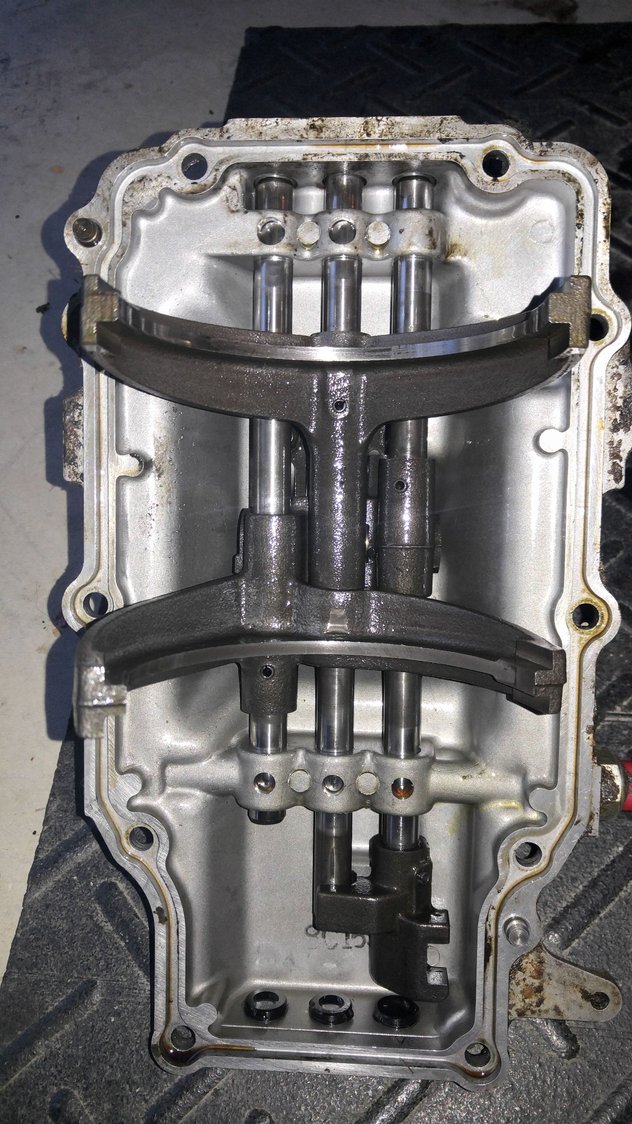

Took my cover off today and unless I don't understand what I'm looking for, these forks don't look bad to me... Maybe I'm lost though

The 1st/2nd and 3rd/4th shift collars appear to be in the neutral position, so I would look at the rear of the transmission, and see if something is up with the 5th/R shift assembly. The 5th/R shift fork is down inside the case.

Those forks appear to be wiped out. I would replace those. You will see the difference in the new ones. Not an uncommon problem with these.

The forks look fine to me. They need to be about 1/4" thick to fit the sliders. If you look at the nub at the end of the fork you can see it is thick(about 1/4"), where the rest of the fork is narrower. If it was worn out that nub on the end would not be there. When I replaced mine, that nub was about 1/16" thick and near almost gone.
Yes, the shaft area looks okay. 1-2 slider and 3/4 slider appear in neutral and not damaged. FYI: 3/4 is in the front of the box (near input shaft).
The 5-R fork is in the rear housing, that lever sticking up near the case moves it. A wrench should be able to move it back/forth. It appears to be in neutral(looks like it is straight up).
Now I would start investigating the shifter itself. The gates where the shifter bolts in may be out of whack and that is giving you the problem of not being in neutral or two gears at once.
Clamp the lid in a vise and carefully shift it through the gears watching the forks.
