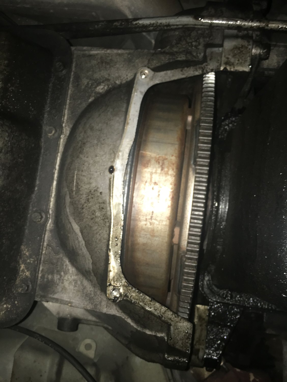

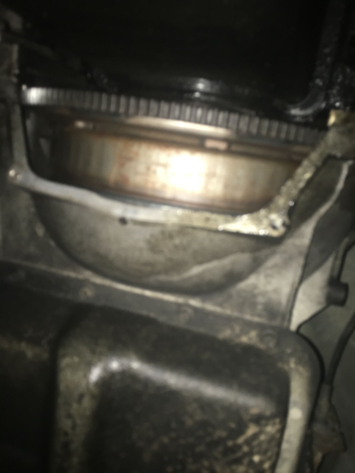

My power steering is only working when i turn it to the left. When I turn it to the right i have to get a 1/4 of a turn in untill the power steering takes over. So i get under my truck to descover what seems to be a peice of my tranny missing. How screwed am I ???

The only thing I see in the picture is the inspection cover isn't there. It would be a good idea to get a new one.
It also looks like your missing one of the nuts that bolt the torque converter to the flex plate (last picture). I would spin it over and check them all and replace/ tighten as needed. Are you having any other transmission issues?

You're not "Screwed" at all.
You should (IMO) replace the Dust Cover to protect the Converter from damage.
The plug shown is the Drain Plug.
The last pic is a pic I found offline to get a better visual
Ok,
forget about the missing nut on the TC then.
Ok,
I did not see that. Change the Subject to something with 4R100 or Transmission and Mark K will chime in as he was an Engineer for Ford and can tell you the specifics of the Bolt needed.
