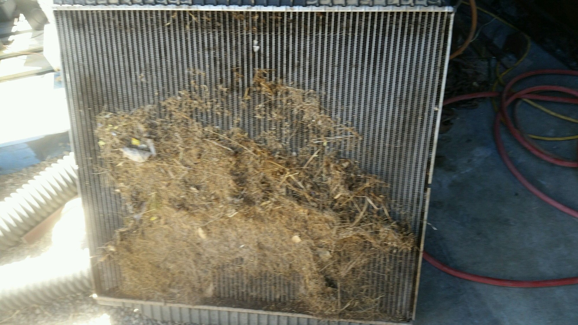

Originally Posted by TNstroker
Been fighting a coolant issue on '02 F250 4x4 with 7.3. Truck runs hot when under load (ie towing, or ac running on a hot day going down the road). Will sit and idle all day with ac on high and 100° outside. I hear my fan at cold start as normal but that's the only time I hear it. Still has original water pump, fan clutch and radiator. I know all three could stand to be replaced with 340,000 on it. But can't afford to do it all at once. What are your thoughts?
Btw New to posting, I have always been able to search and find the solution.
had an 02 last week same symptoms. ended up replacing a/c condenser, radiator, thermostat, water pump, serpentine belt, tensioner, idler, upper hose (ambulance hose) and cooling system flush.
ac fins were about 75% flat, water pump squeaking, both pulleys on tensioner squeaking, idler grinding, radiator 90% plugged between fins and about 75% covered with debris. calcium build up internally at about 0.020"
