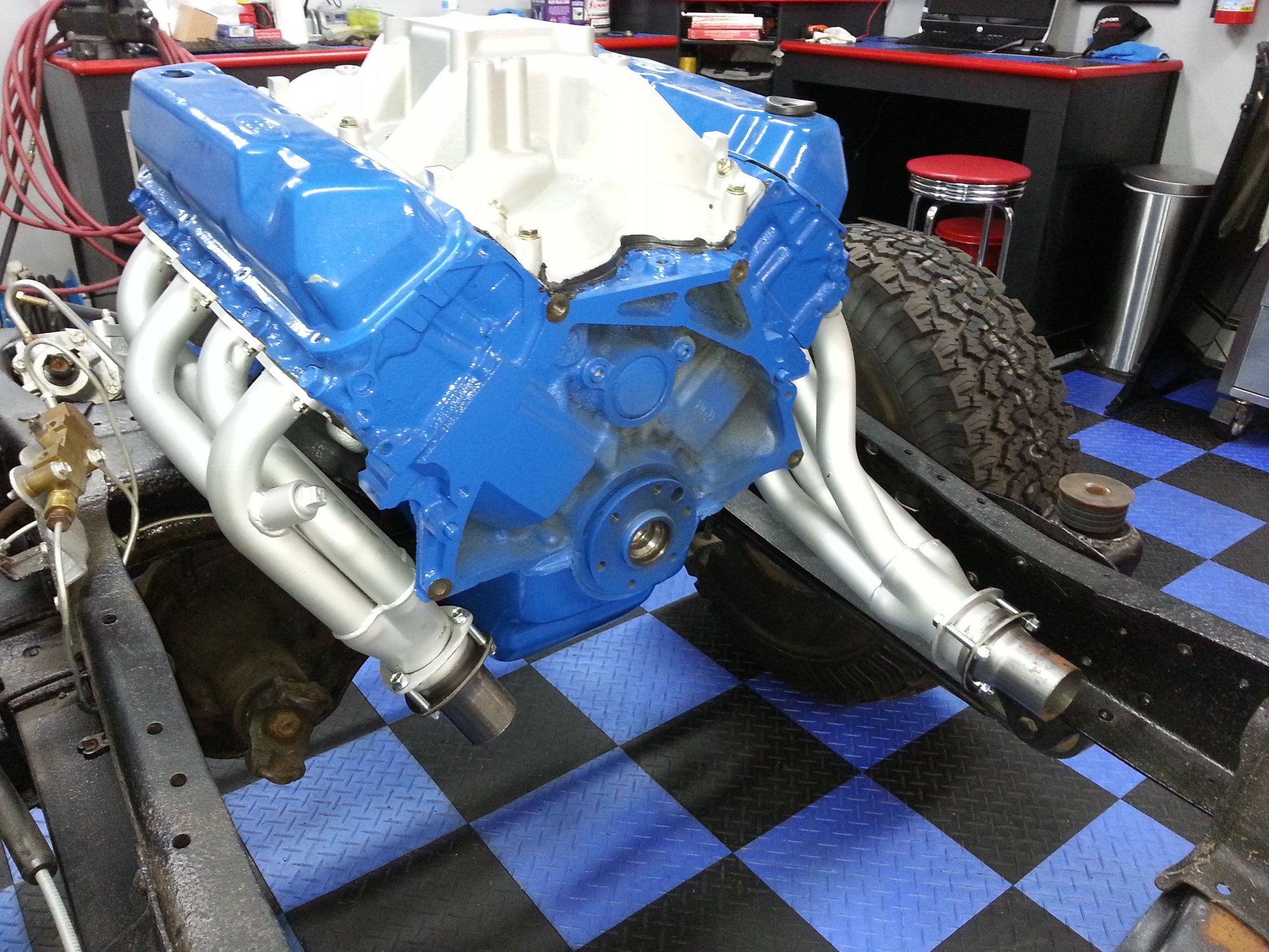

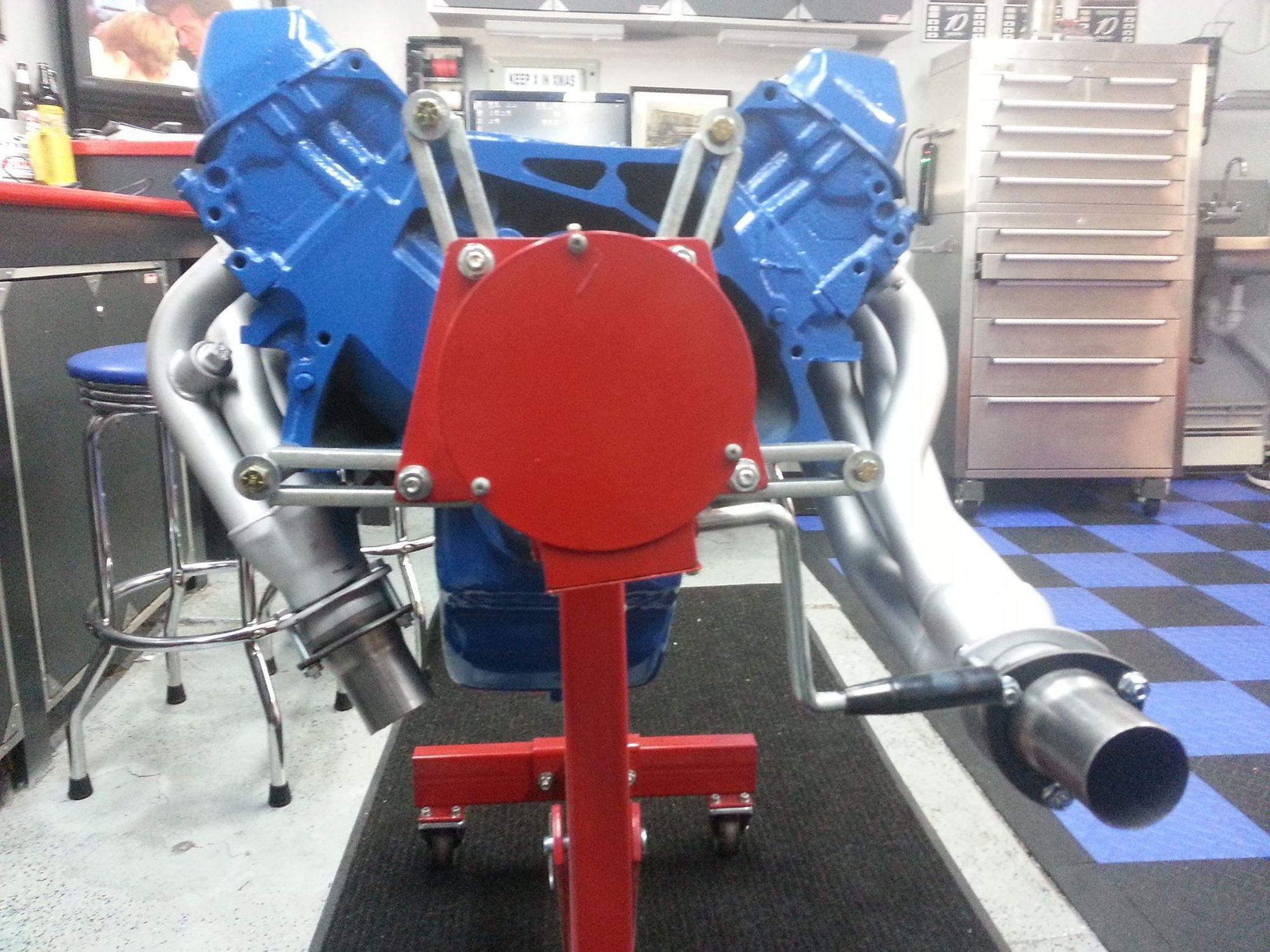

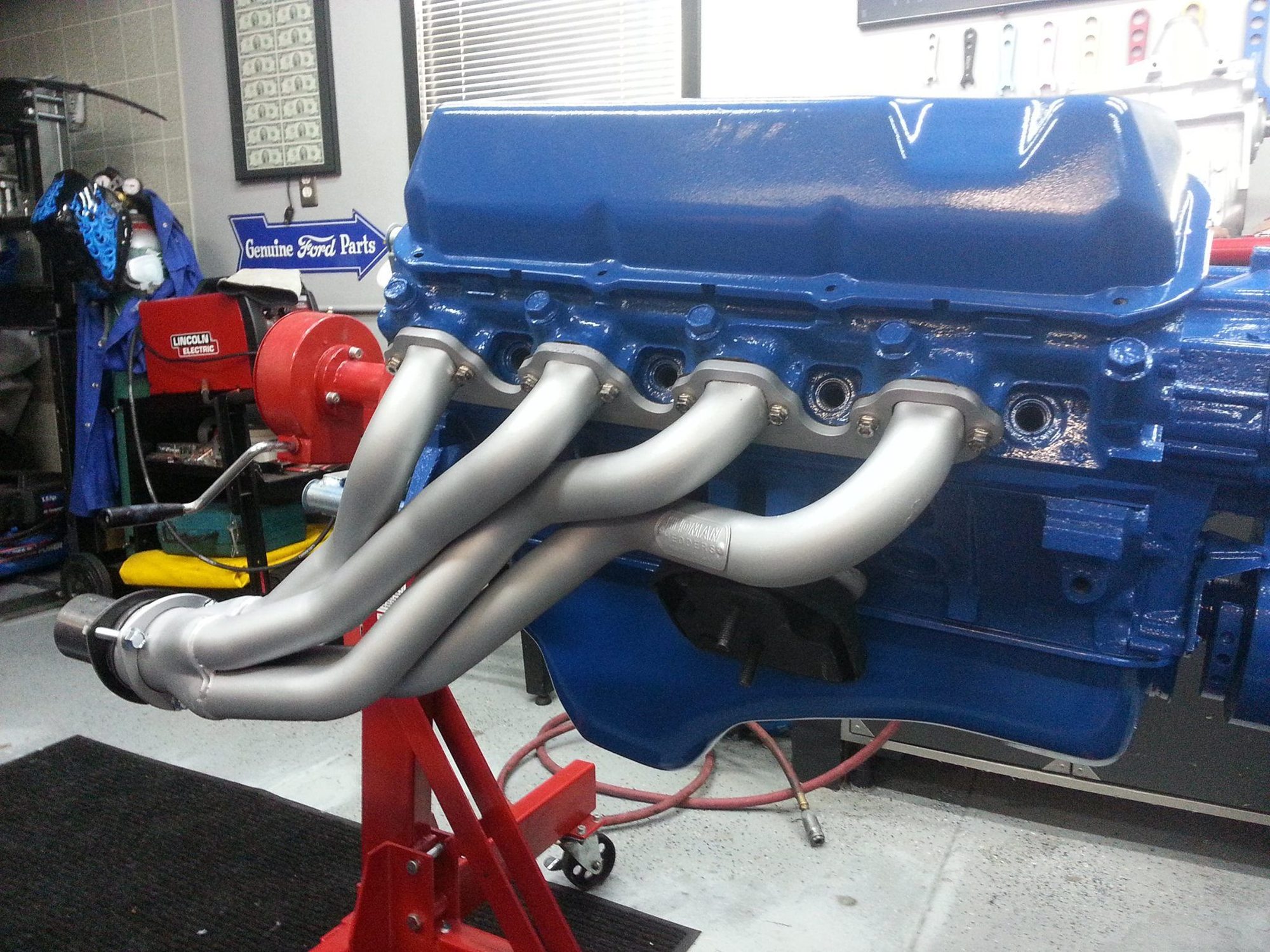

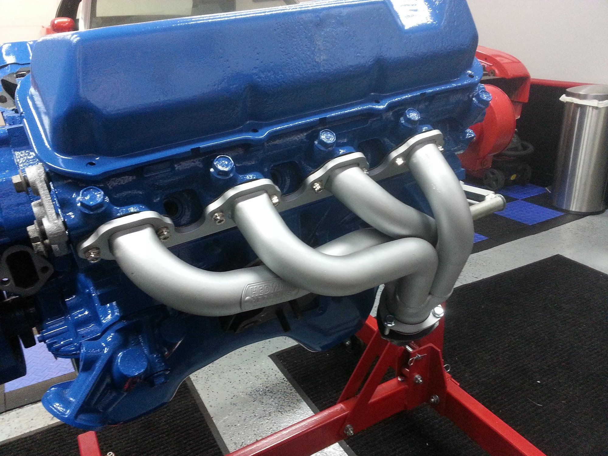

Old Sep 6, 2016 | 06:39 PM
AlbraiNYa's Avatar
AlbraiNYa
Joined: Nov 2005
Posts: 57
These are marketed by Hedman as shortys but I would call them mid length. . 1984 F250 chassis. Hedmans, got them from Summit. 460, I dropped the engine into the chassis the other day and they fit perfectly. I am going to fabricate my own full dual exhaust system using flowmaster super 40s, and going to incorporate an x pipe. Part number on Summit is 89460 if you're interested. They sell for about 280 and they come with the ball flange not the flat 3 bolt type.
