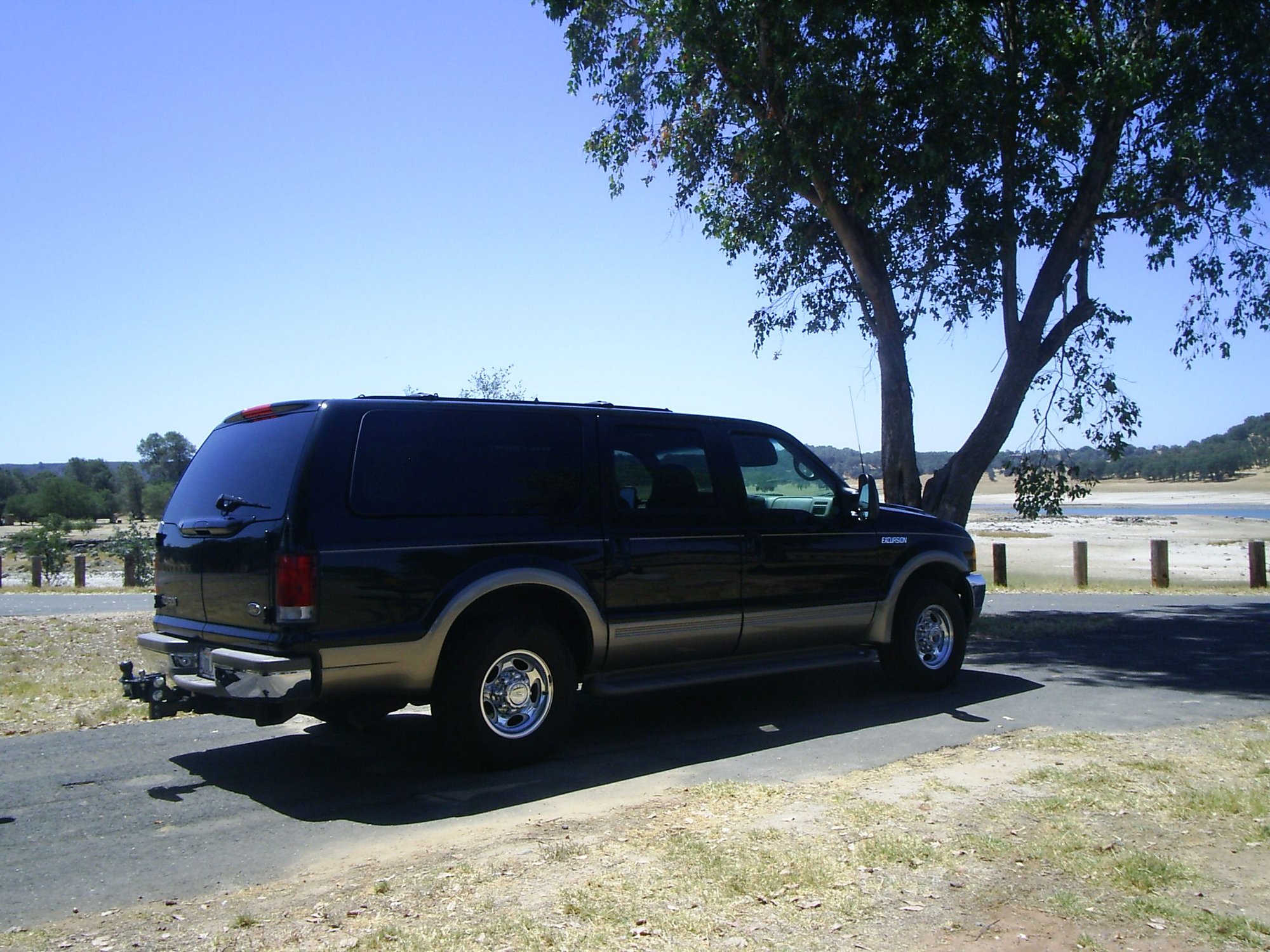

Got the brake controler, wd hitch too. We have a call in to Camping World to get air bags installed. My picture of the Big E that you see here was taken at Lake Camanche. Yes, that is pretty low water. Looks a little better this year.
