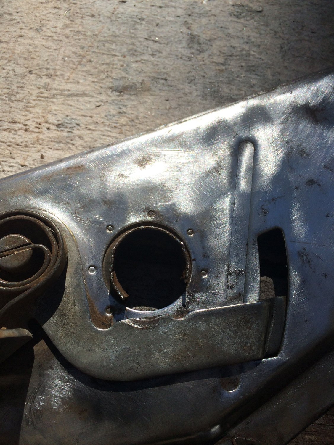

Any body repair the female on the hood latch 49 f1
This is the bottom side <br/>Maybe a collar or?

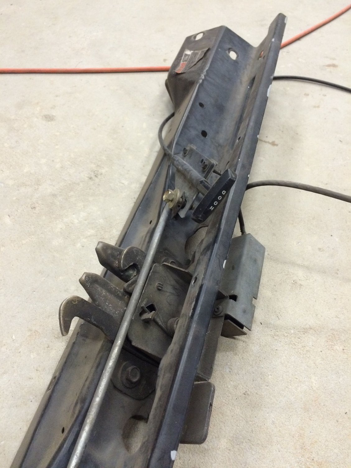

Tom that is plan B
Off my 1989 E250 parts donor

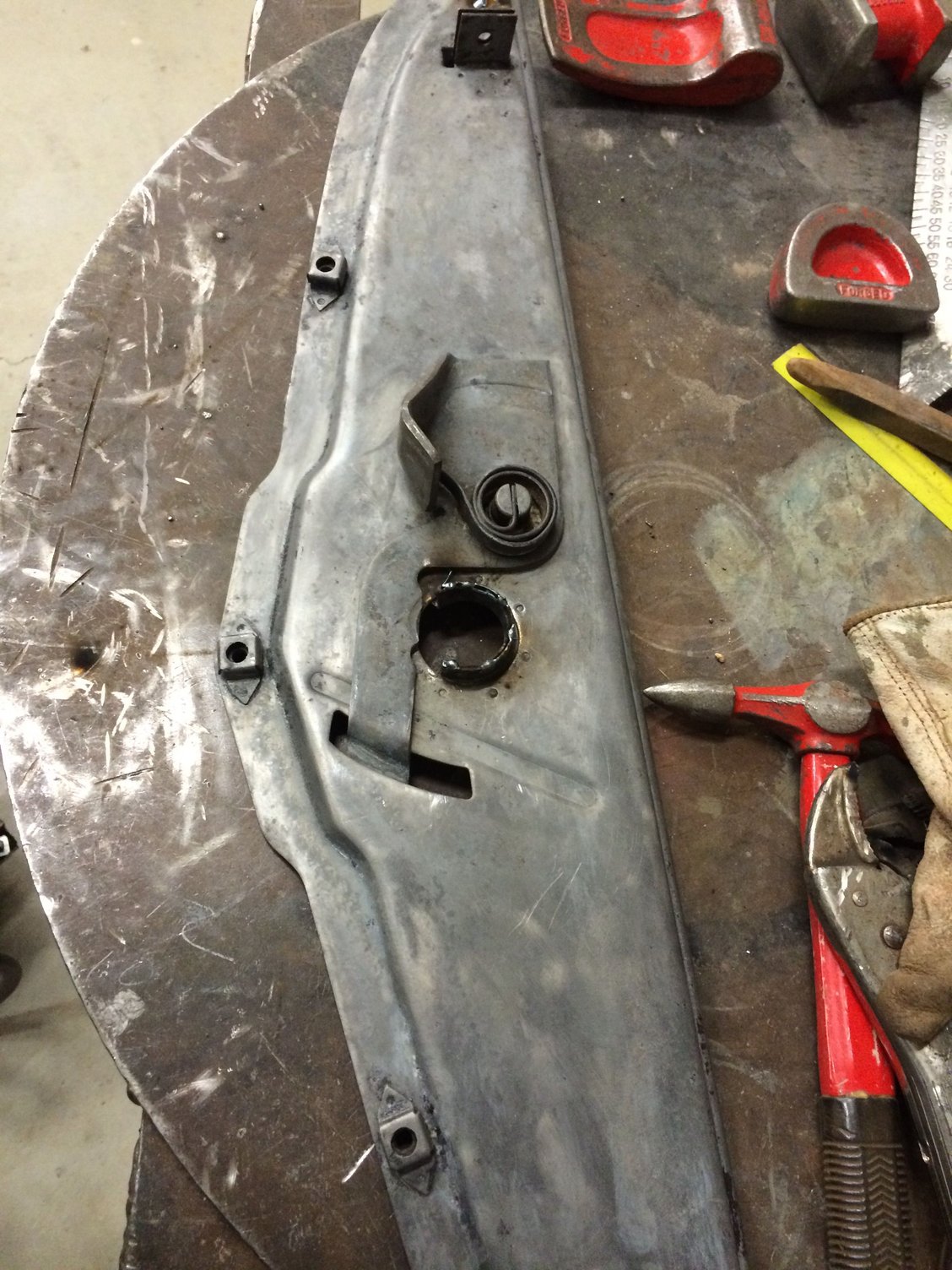

Thanks for the info Jim I'm going to try and repare the stock set up and maybe add another aftermarket latch to it see how it goes, both my primary and my parts trucks had rope to hold the hood down when I bought them so those reverse hoods may also have a place in this truck
The female receiver had tear so I cut a band around it and clean it up some. The latch has a little ware that I'll try to fill with weld

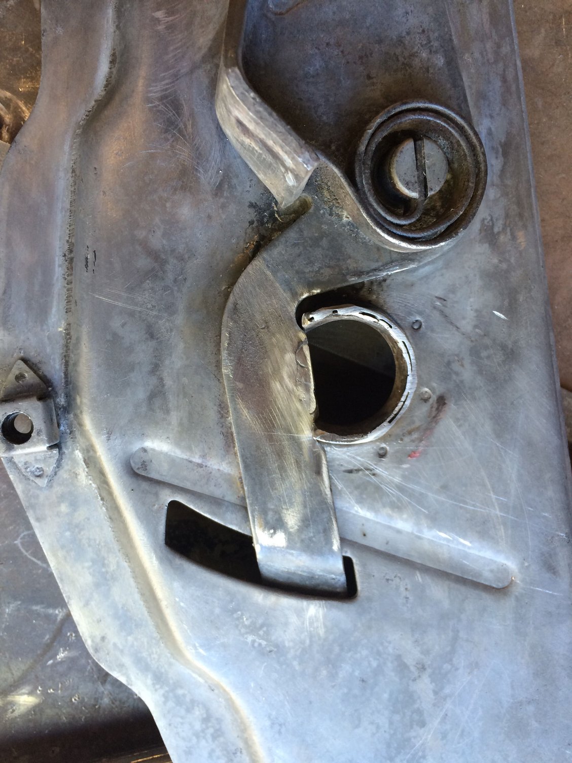

Hope this works for latch repare
There is very little support at the strike/latch just sheet metal
