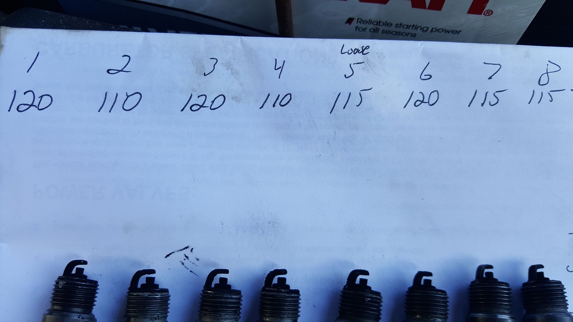

The latest. I did a dry compression test and these are the numbers. 110 to 120. All plugs black with soot. I cleaned the plugs and reinstalled. Brand new carburetor, I can turn the fuel mixture screws in all the way, and nothing changes. Timing is set.
