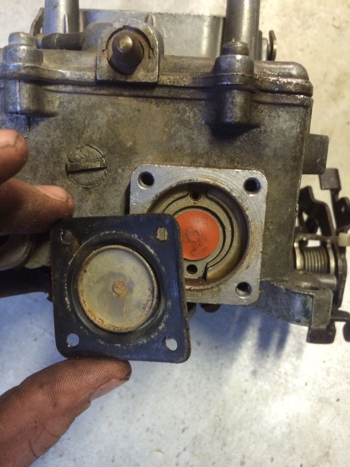

I fixed the YouTube video
And I changed this part

That's the accelerator pump. It shouldn't make a difference which carb it cam off as long as the linkage is hooked up the same as it came off.
When you pump the pedal, you move the lever on the pump which causes it to send gas straight down the venturis. If you look straight down the carb while working the throttle linkage, you can see it squirt out a little tube, either in the center or on one side of the venturi. When you hit the key, the engine is running on the vapors in the carb.
