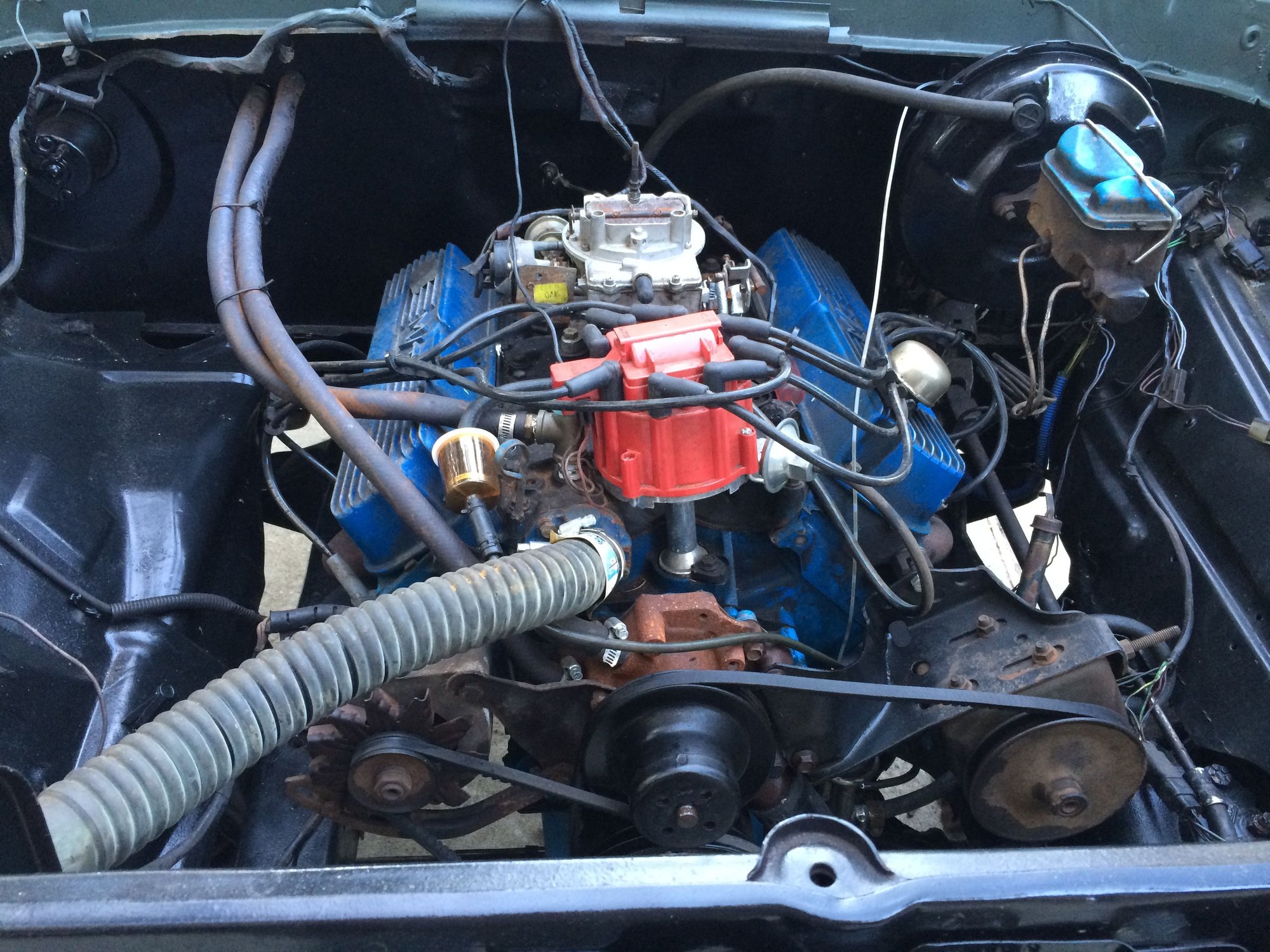

I have found this page very helpful while I have been while restoring my 76 ford
But I created this account because I can't seem to find an answer to this problem
I bought a running, newly rebuilt 351w with a 4 speed to replace my tired 360
Problem is I can get the engine to run by pushing the gas or spraying starting fluid in the carb
But the truck won't idle
And it won't start till I hit the gas
I'm 18 years old and this is my first truck. So I'm not completely up to speed on most things and it's probably something simple I'm not seeing but I'm trying to learn
Thanks!

x3 on the fuel filter (#1) - that looks like bad gas has passed through that filter. did that filter come with the engine or leftover from the previous engine? It can sure mess the carb up. Replace it with another one that you can see the filter/gas to see if the ugly comes back (which would indicate a problem with the tank)
Vacuum - I can't see the manifold port (#2) to know if there is a vacuum tree on it. Check/replace caps if there are. I see a cap on the front of the carb (#3) that looks good, check to see if it's too big for the outlet. Next, in the back where the vacuum hose from the brake booster connects to the back of the manifold (#4) may be another tree, check those to make sure they are closed/covered. (#5) Distributor vacuum, is that running to the carb? Are there any other hoses running to the carb? (if so, where from?)
Lastly (#6), This is a usually a PCV to the air cleaner or intake/carb depending on engine (one on the other side doesn't look like it goes anywhere but is open at least). Might remove the tape to let the crankcase breath a little.

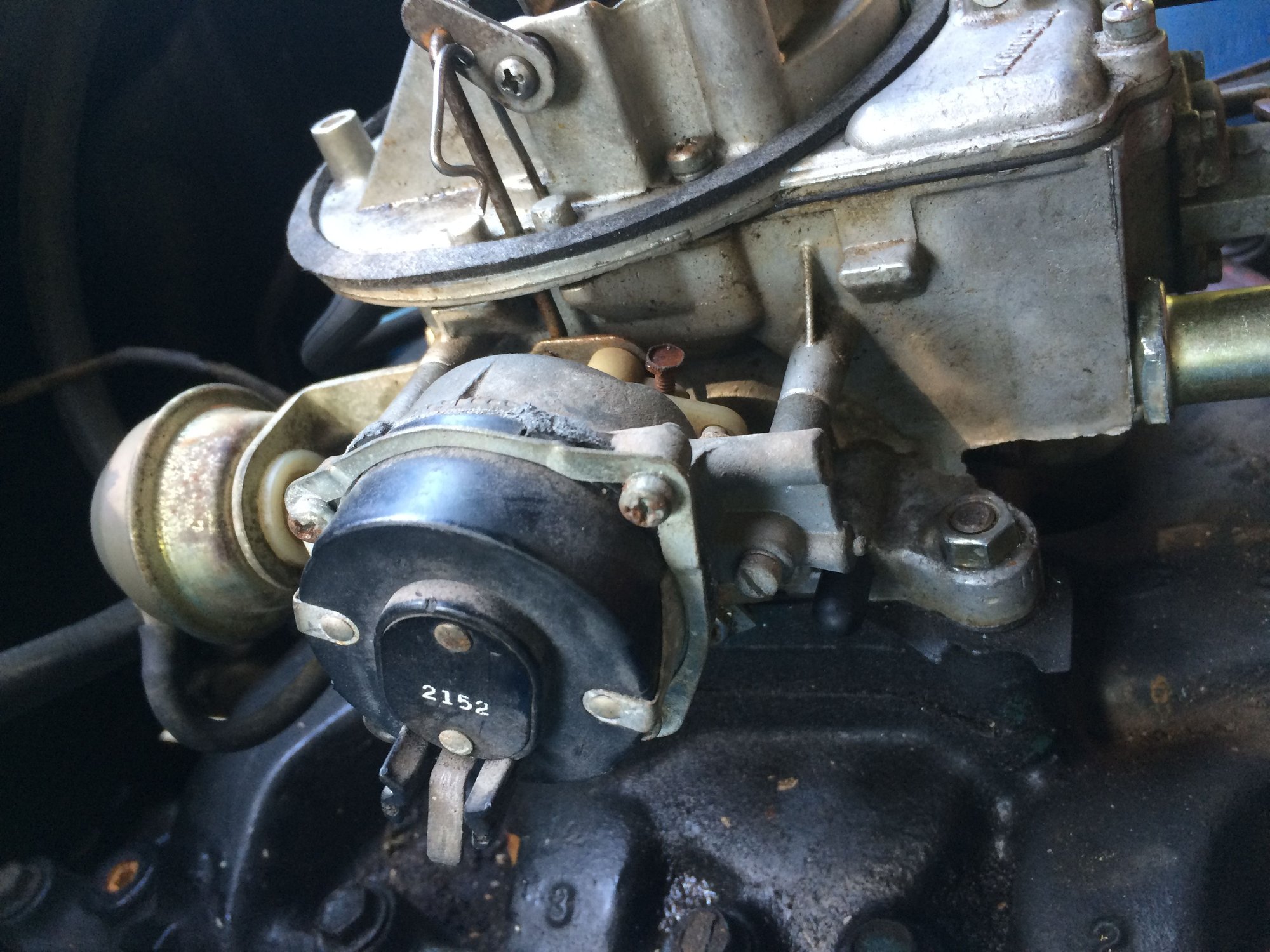

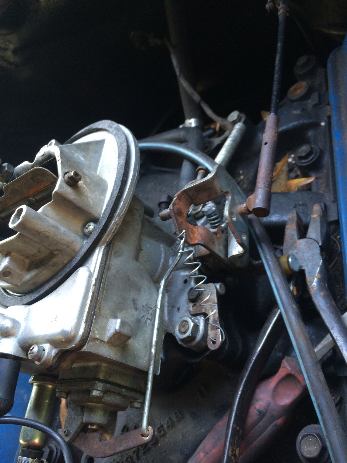

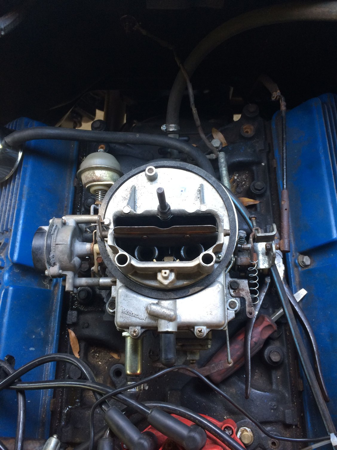

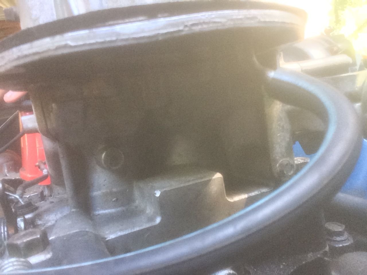

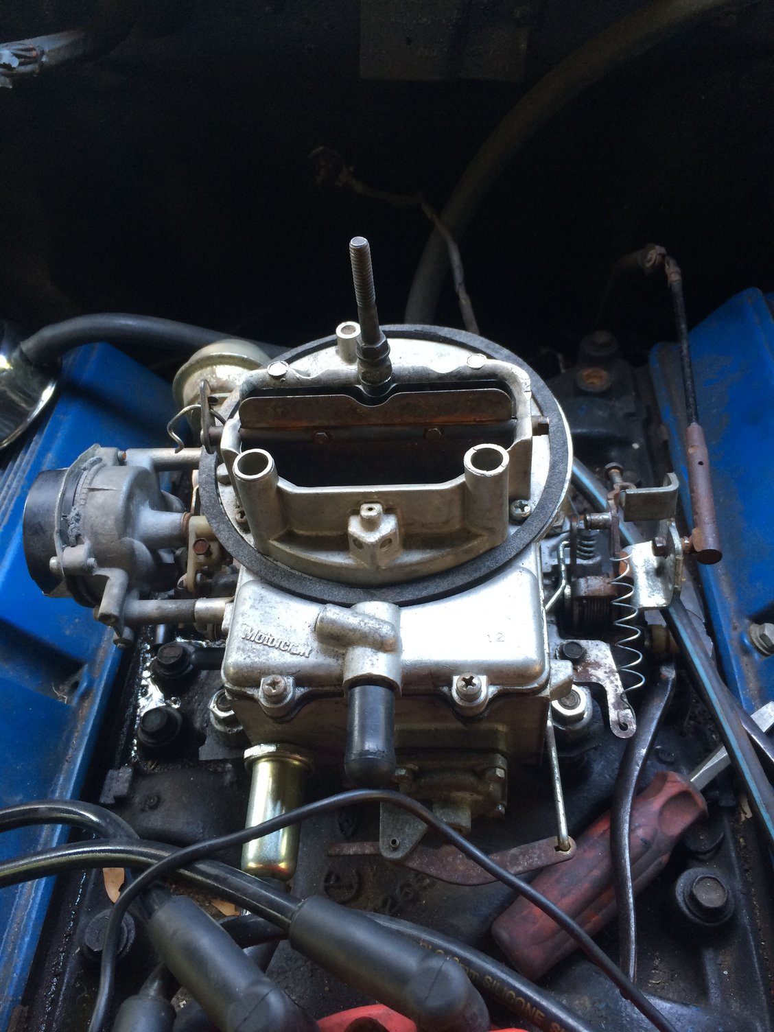

update
I have changed the filter played with the adjustment screws
And still same result
I took some pictures to help
Old Jul 3, 2016 | 04:46 PM
kegger66's Avatar
kegger66
Joined: Jun 2015
Posts: 534
Likes: 27
From: North Texas
Glad to see you taking on a project like this - I had a '78 w/302 for my first truck when I was a teenager. Great experiences working on it.
Idle screw adjustment made no difference...well I think it's the carb but the next cheapest thing to rule out is the vacuum (BigCountry1978's vacuum check).
If carb you might be looking at a rebuild. only other thing I can think of is bad gas (since that didn't come with the "new" engine). Could run some from a gas can to see if any different.
When it's running (with your foot on the gas), whats the lowest RPM you can hold it to before it dies?
