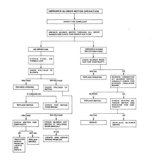

Hello guys, I'm in need of yall's help again. I got the sanden conversion kit from classic air auto in my house waiting to be installed. Problem I am having is the dash controls were not working. Fixed all but one. The blower is not engaging. The pig tail was melted a bit and I changed that. I also went and put a new switch, still nothing. I'm not much of a electrician. But I did buy the chilton book. But doesn't really help much. If I could get suggestions on how I would diagnose the problem. Where to start,what part is wrong. What tools I need.... I also checked the fuses. They seem to be good. Thanks for your attention.

Is the blower not working a new problem or you've had no heat/vent for some time?
If you have a multimeter you could see if you're getting voltage to the blower which would rule out a wiring/switch issue (or not). Since you found some melted wiring it might have taken out the other end (blower).

And when the compressor seized up the blower stopped working as well?
ah ok, you're doing the same thing i'm going through to get AC working again (kit). Looks like you'll need to get at the blower (at least the wiring for it) to see if locked up or just not getting the signal.

Does the blower work on any position? Or is it just the AC? If it works at all, I would suspect the switch. If it doesn't work at all, the blower motor itself could be bad. Since you are swapping out your evaporator core I think you will be in optimum position to physically check the blower motor. Might also be helpful to know whicj AC you have - factory economy, factory deluxe, or aftermarket (there are numerous posts telling how to tell the difference.)

Thanks number dummy. And thanks Kregger66 for the diagnose graph. Hopefully I'll have this resolved today

Ok so now I'm in the middle of changing out the resistor. I seems to be local part suppliers don't sell that very resistor. Would y'all know where I could buy one?
D3TZ-19706-A .. Blower Motor Resistor / Obsolete ~ Last MSRP: $17.15 - Dealer net cost: $10.29.
1973/79 F100/350 & 1978/79 Bronco with Factory Installed Integral A/C or Hi/Lo Comfort Vent System.
NOS PARTS SOURCE in Olathe KS has 1 = 913-220-5746.
DAN COLLINS FORD in Lakeview OR has 1 = 541-947-4965.
NOS PARTS LTD in Waxahachie TX has 4 = 972-937-2201.
GREEN SALES CO. in Cincinnati OH has 4 = 800-543-4959.

Thanks numberdummy! I ordered the resistor for 55$. A little more than I wanted but I needed it. Not only did I have to order the resistor, but I ordered the evaporator core from LMC for 350$. Putting AC in my truck has now put me 1300$ behind. But at least everything is new... this week I should be rolling with cool air!
Thanks everyone with your help!
