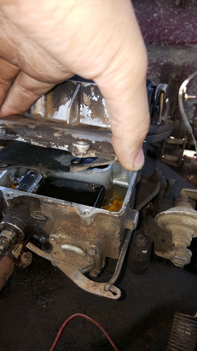

Yuck
Well as it turns out, I'm kicking myself for not checking this sooner. You can't even see the bottom of the can! What am I looking at to clean out the carb without disassembling the carb?

Carb spray can clean old build up but nothing will clean it like what you need to do by soaking in carb cleaner.
Or just put it all back together and live with it you gota pull it apart.

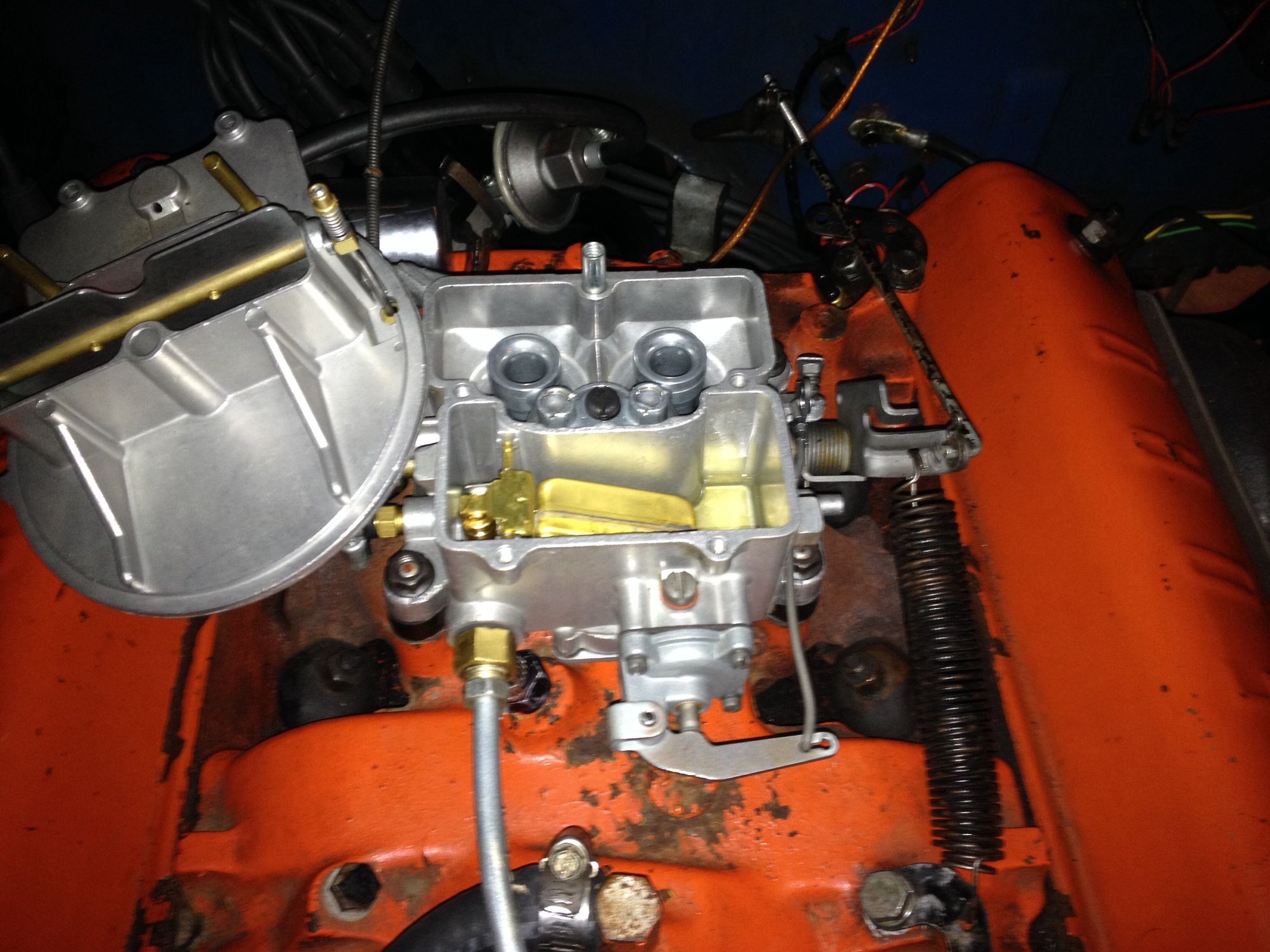

The fuel level in the bowl should be 29/32" from the flat machined surface at the top of the bowl, down to the surface of the fuel. You probably don't always have a machinist rule with you, but you probably have a quarter, this happens to be very close to 29/32" In this photo the fuel height is very low, after maybe a month without starting the fuel evaporates.
The idea though is to adjust the _float height_ up, or down, as required to reach 29/32" _fuel height_ in the bowl from the top of the fuel to the machined surface flat at the carb top. Let the engine idle for a few minutes and shut the engine OFF. Then check fuel height. Later on if you are super careful you can let the engine idle with the carb horn removed and observe that the fuel height maintains the proper height.
That thing needs a rebuild. Clean everything thoroughly with carb dip and carb cleaner and blow out all the passages with compressed (shop) air. Get it zeroed in, new gaskets, spacer, and no vacuum leaks. They are one of the best carbs ever made. But they need to be clean inside. Mike @ Mike's Carburetors recommends replacing that style of float with brass, btw. He says the plastic floats are prone to getting fuel logged and sinking iirc.
