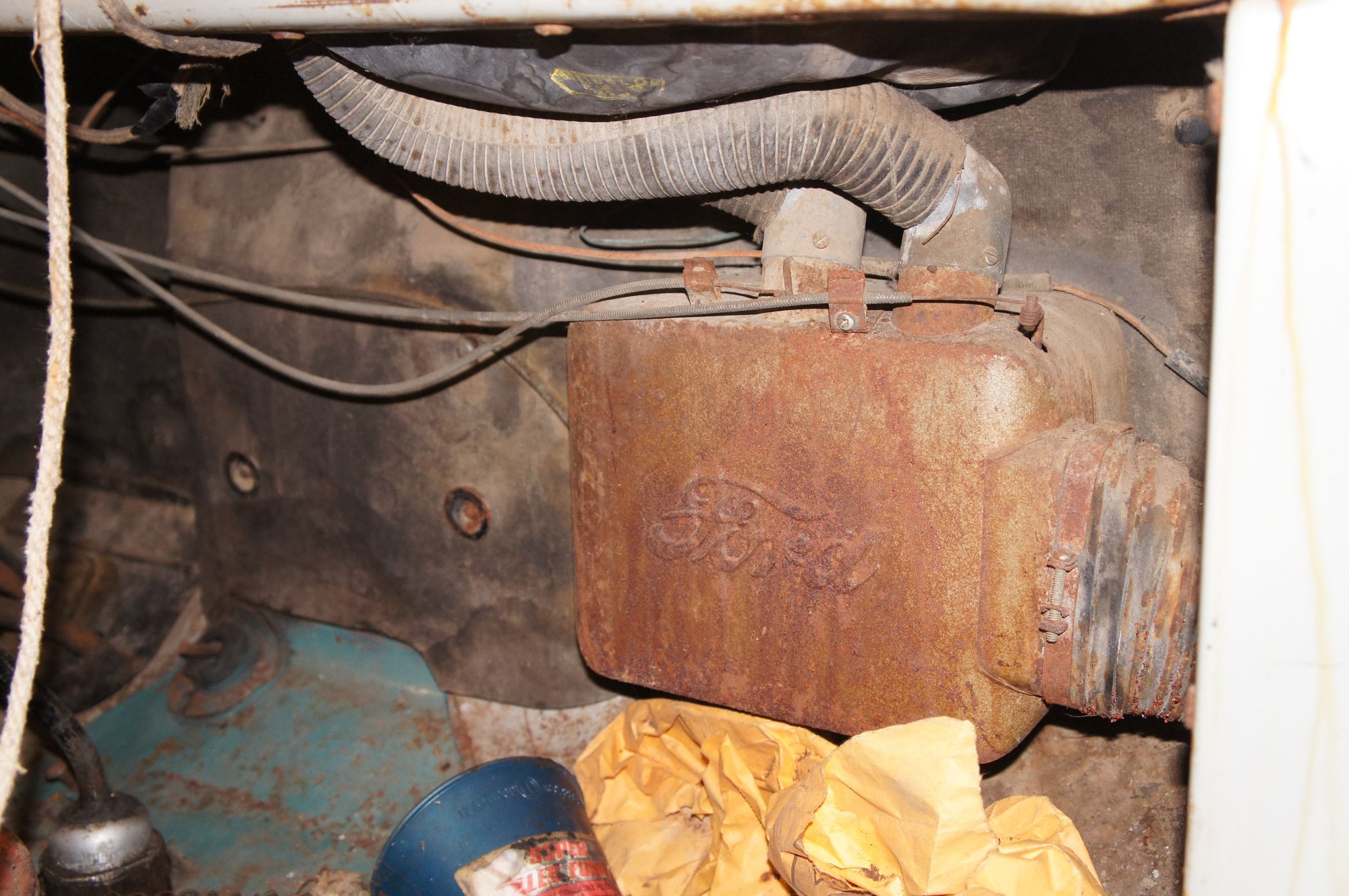

Originally Posted by schoo
your truck looks like a nice stock resto project to me to hot rod or sport it up would be a lot more than 5K
When it comes time to make your heater system right let me know .

@firstrider you got it, I will! What do you have in mind?
