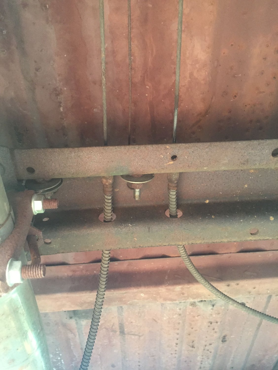

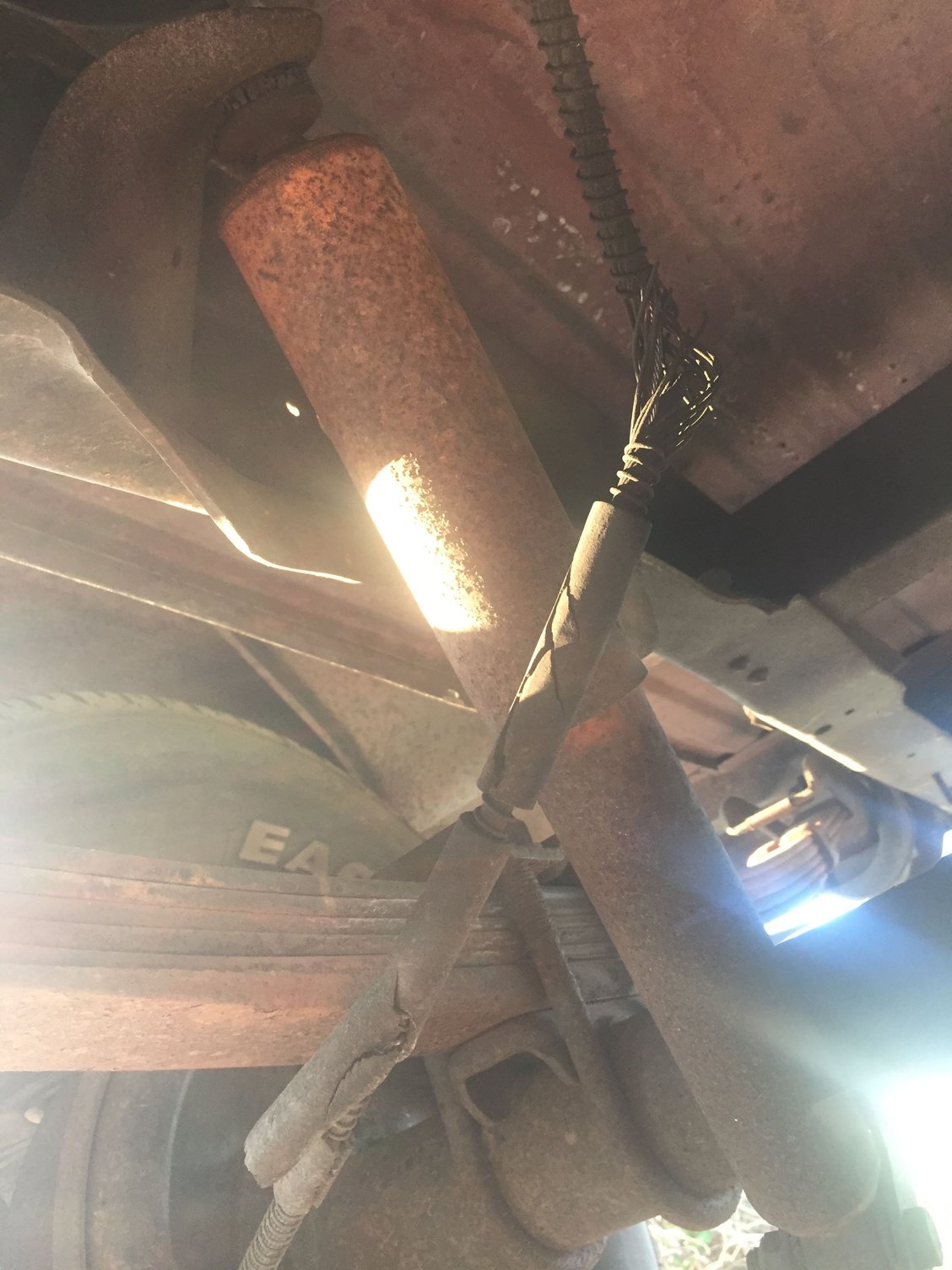

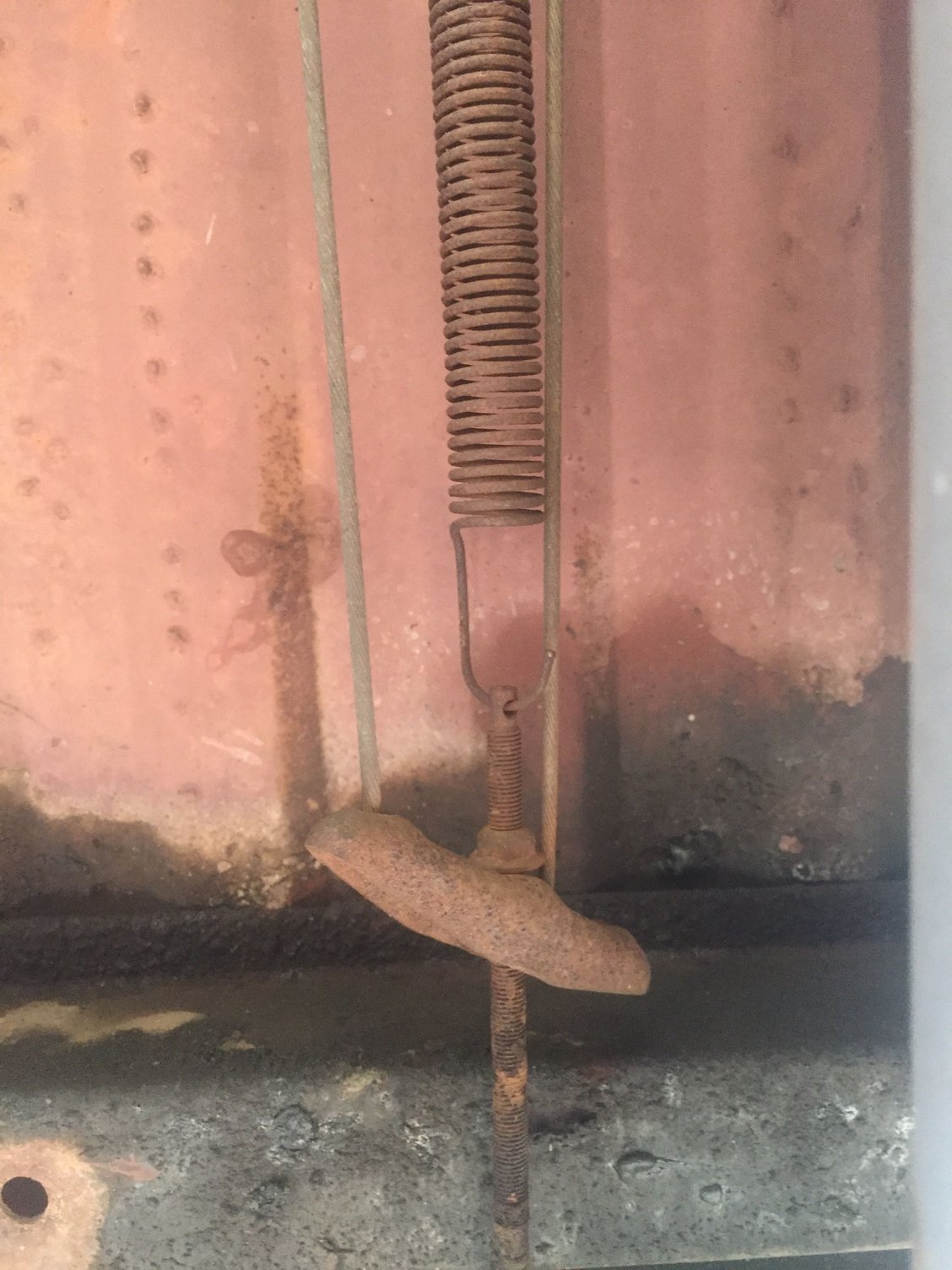

im no mechanic by any means, but I tried to get some pictures of the parking break lines. Maybe someone can point me in the right direction.
Not sure if this would cause the whole system not to work but I can tell it's not great haha.

Sourcing a new (or good used) rear cable for the park/emergency brake would be a good idea. It cannot apply even pressure to both rear drums with that kink. They're not hard to replace, but a little time consuming.
The shift collar and tube are bad about wear on these trucks. They are a little more trouble to replace, but well worth the effort. Some forgo the repair and install a floor shift. Not my thing, but to each their own. As nice as that truck looks, I'm guessing you'll opt to keep it original. As for my earlier comment on the color: My dad always thought it best to keep the original color. Even though I'm not real fond of green, I've owned (and still own one) several, one which I drove for 17 years. Stick around and you'll get some great help from these guys
