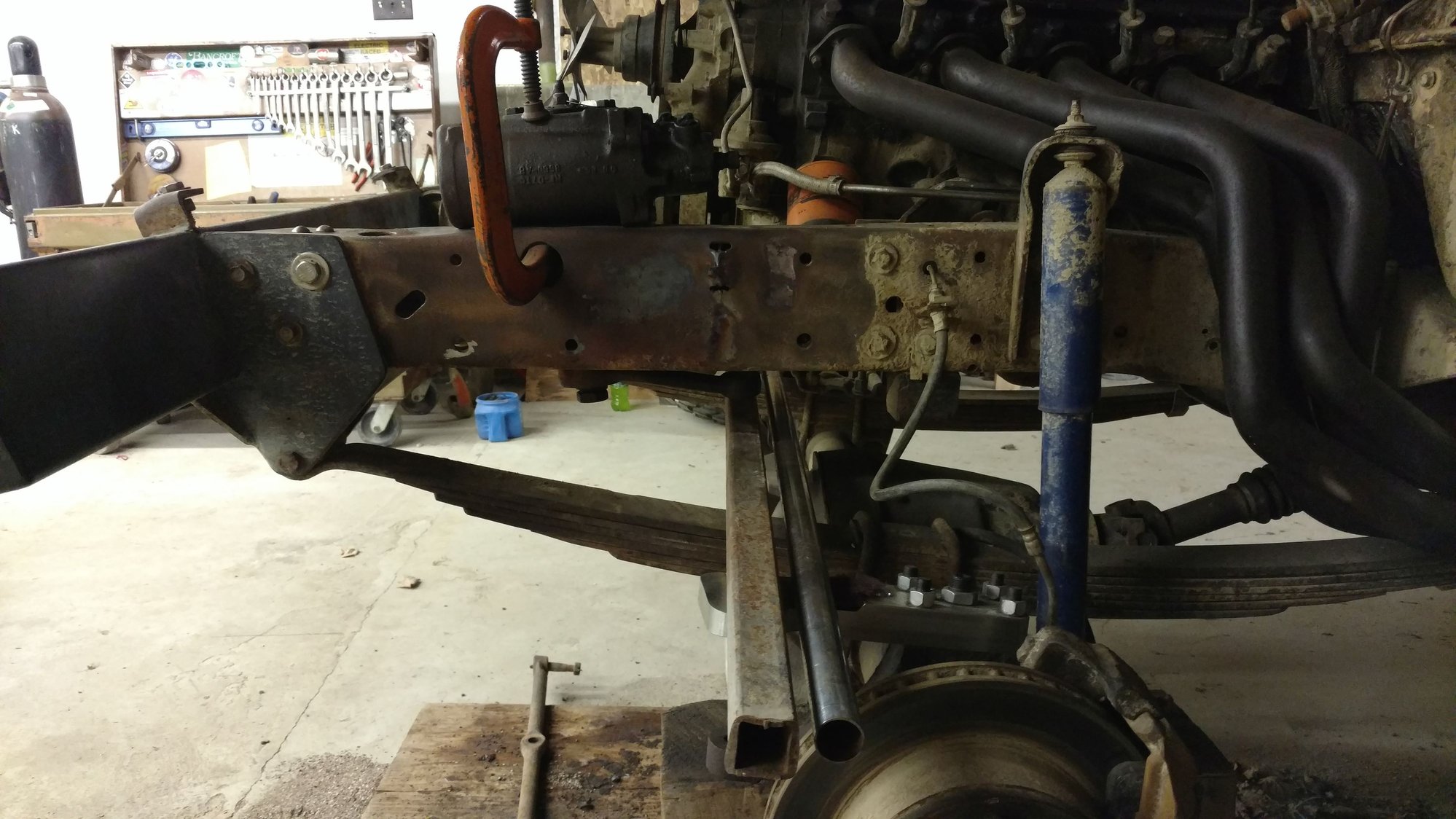

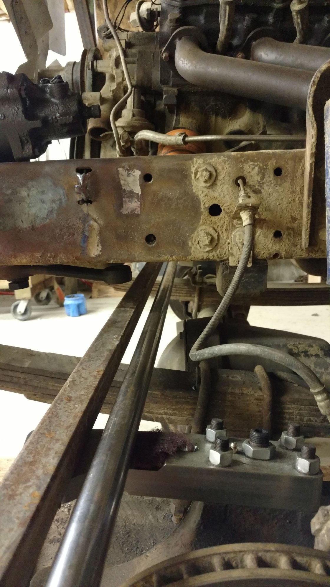

Here is a mockup if you will, just using whatever i had around to take place of the tie rod and drag link, and a C-clamp to hold the box in place
In case anyone was wondering, fender exit headers are the answer...
I had to cut up the engine crossmember a little to set the steering box back where i wabted, and to make room for the pitman arm. This truck only has 1 3/4" lift so its all tight
Started plating it back in this job is no fun with the engine installed
