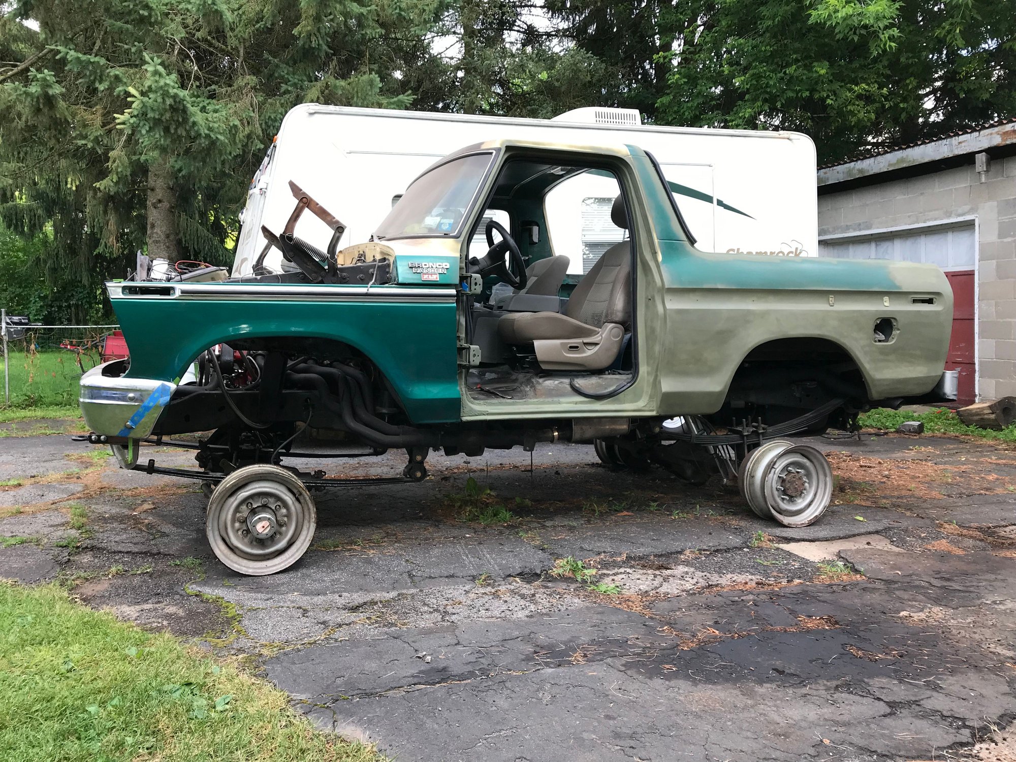

Outside and running. But I can't post a clip of it here for some reason. Guess pictures will have to do.
Still have a lot to do, not sure if I'll get it on the road this year. Just getting it done enough to put it outside and install the wheels and tires is a big win for me. I had to drive it out of my garage like this. lol
