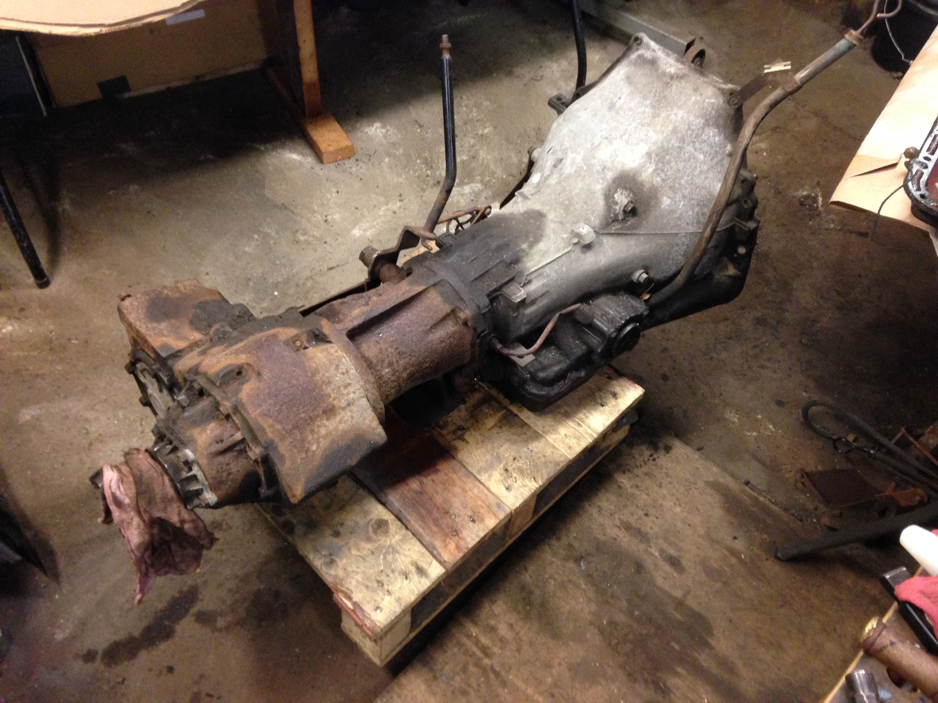

Been a while since I did an update. I pulled the stockish 460 that came with my bronco out today and set the 545 in place. The cam is getting reground right now. I can add cam specs later if anyone is interested. Basically it's a hydraulic roller cam lobe profile that I will be using solid roller lifters on, much less spring pressure should make the lifters last much longer.
I got this heavy SOB out.

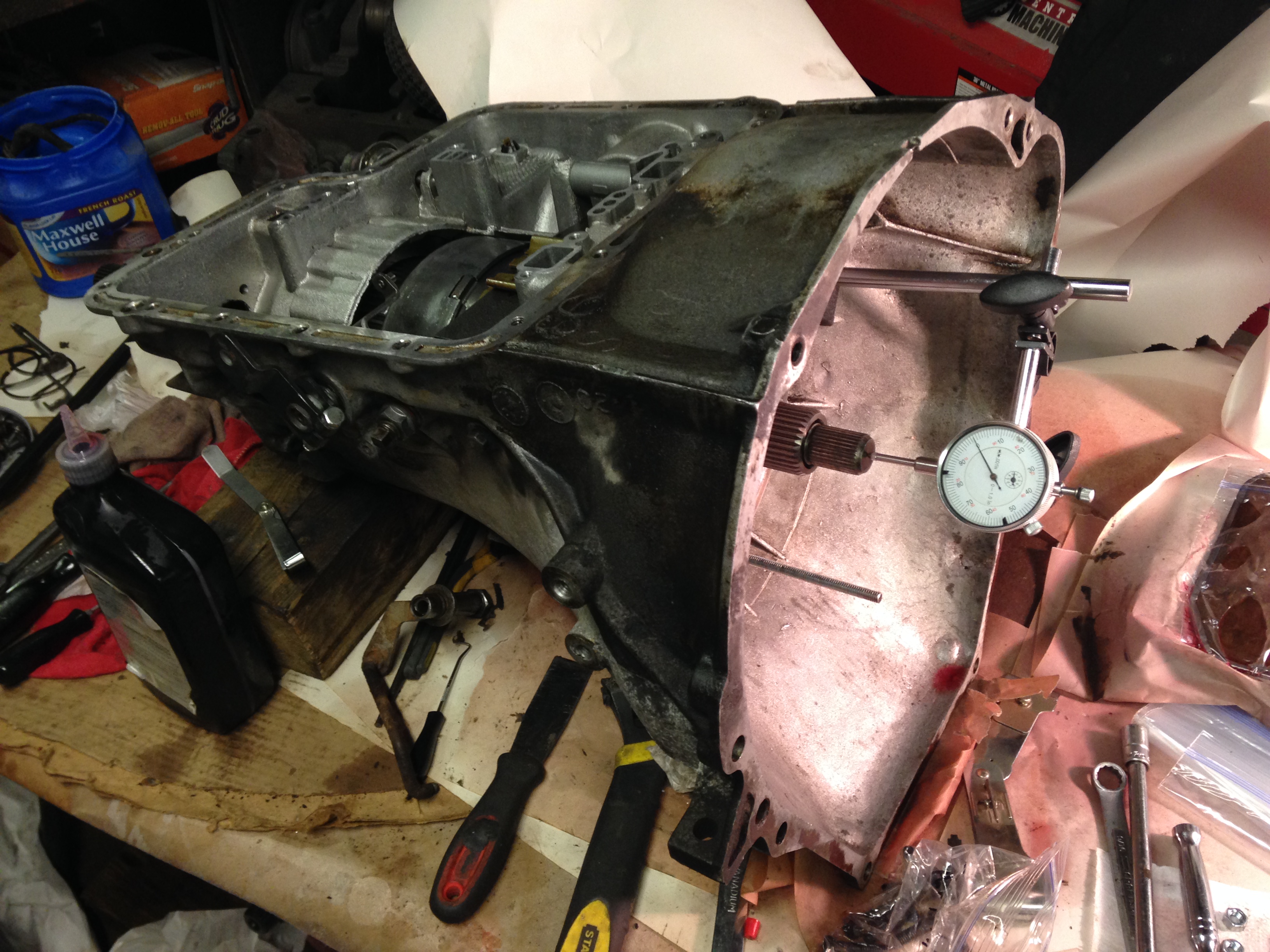

It won't be going back in like this, probably the trans and then the adapter and transfer case. I took three C-6's apart to make one hopefully good one. Checking end play here. Once I finish up the valve body tomorrow, I can air check and if all is okay, install the trans. I got a 3000rpm stall converter from Edge.

Maybe I'll get the trans in by the end of the week if I don't run into any problems.
