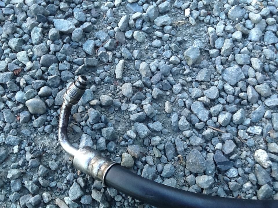

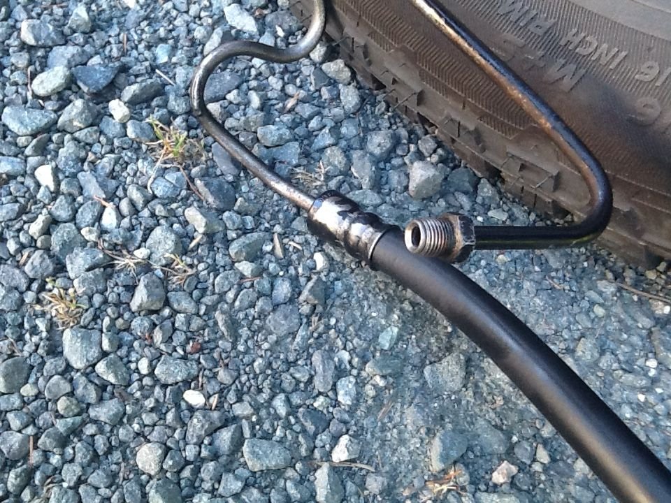

Ive got a pwer steering pump and box out of 1978 f250 4x4 in my truck, im trying to make a power steering line. Does anyone know what size the fitting on the pump is, the one with the o ring and the double flare on the steering box. Im going to get adapters to make a line with AN fittings. Thanks

These are the ends that are on the stock line. It can't be quick release. The stock replacement wont work in this application the the truck is a 64 the steering box is a 78 and the motor is a 7.3 so nothing is in the right location for the stock line. Im figured this area of the forum was most appropriate being that its the parta off the 78 im inquiring about.
