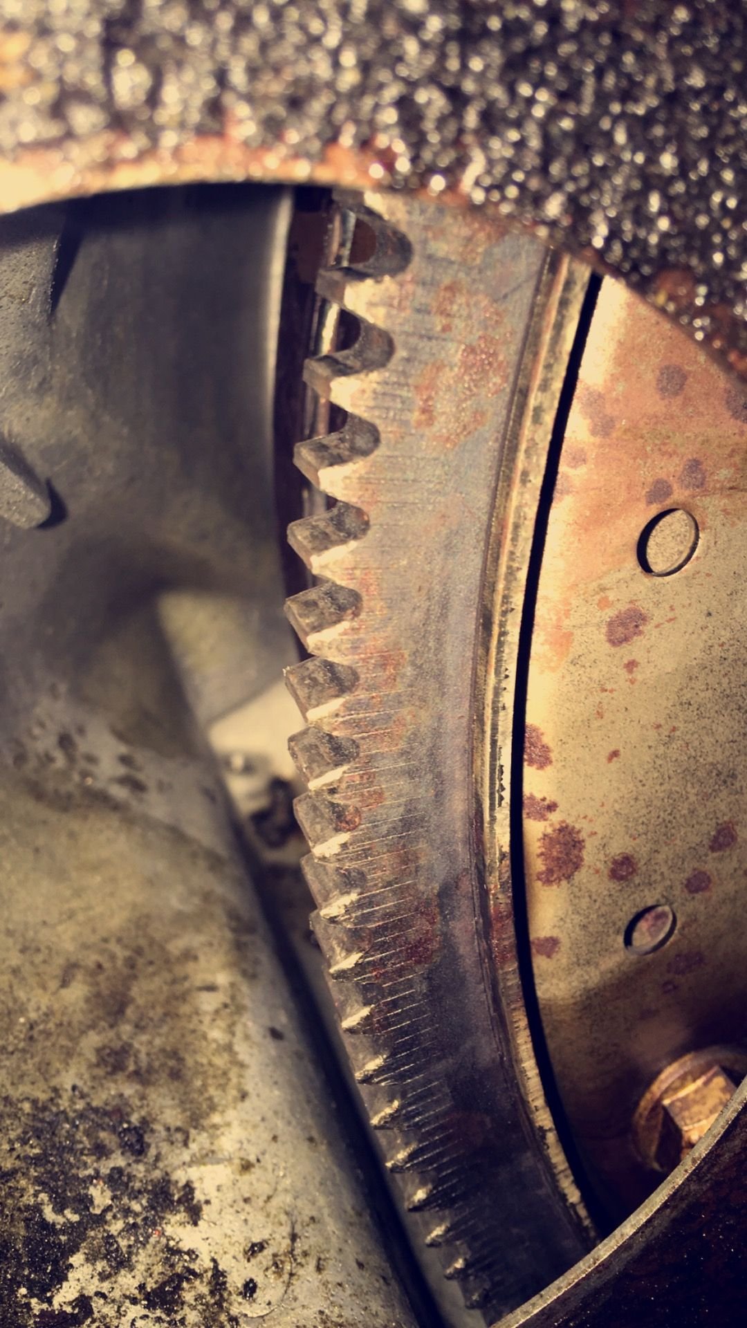

Ok I pulled the starter, and from the outside it looks fine. It's a remanufactured part so could just be faulty... It was getting dark so I just pulled the starter and didn't get a chance to look at anything else.
Here's a pic of the starter gear:
And a pic I got of the flywheel:
