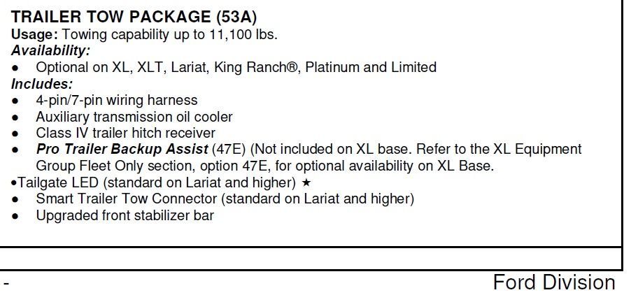

Good post, but one caveat:
Originally Posted by GMC to Ford
Here is what you lose without the trailer tow package:
1. Upgraded front stabilizer bar (does not cost much ~$60)
2. Heavy duty radiator (not mentioned in the tow package literature)
3. Auxiliary transmission cooler
The radiators are the same. This is from the '16 Order Guide:
There is only one radiator listed for the F150, and it goes into all engines with all towing packages, and that's FL3Z-8005-A.
Two different radiators FL3Z-8005-A (~$280) and HL3Z-8005-C (~$450) online. I have the second one on order right now after several weeks of waiting for Ford to make a decision on my truck's setup. I have crawled under 7 different trucks on dealer lots to verify the setup and take pictures of engineering part numbers from the factory for cross reference.
Here is the parts list to add towing package to my truck:
HL3Z-8005-C HD Trailer Tow Package Radiator
FL3Z-5482-B Upgraded front stabilizer bar
FL3Z-7A095-A Auxiliary transmission cooler
FL3Z-7B142-A Bracket
FL3Z-7B028-P Aux. transmission cooler tubing
FL3Z-7B028-K Aux. transmission cooler tubing

I can't find anything on that part number, nor anything to back up the claim that the radiator is different. Not saying you're wrong, but this isn't making any sense to me. That part is showing no applications on any of the sites I've checked, including Official Ford Parts Site | Buy Motorcraft & OEM Ford Parts Online | FordParts.com.
Curious to see what this thing looks like when it arrives. If you tell me where to find the part number I'll take a look at mine.

The difference between the two radiators is:
Regular: Two transmission cooler lines run from the transmission cooler (6" x 6") and thermostat located on the cross member across the lower back side of the radiator to the driver's side.
HD: Two transmission cooler line run under the radiator and up in front through the splash shield cutouts to connect to the auxiliary transmission cooler.
