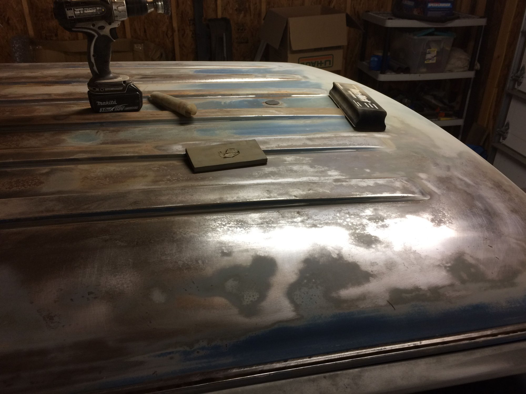

So I think the bed, fenders and other assorted pieces are ready for their final 400 grit wet sand and then color. Now it's time to start on the cab and doors. The rain we've been having, and the threat of rain is really slowing me down since I've got the cab outside and it's missing some glass. So I think it's time to roll it back in and tackle the surface rust on the roof of the cab. I may need to build a scoffold to get up that high to reach all of it!

Ordered 2 gallons of paint this morning. Been doing some more sanding, but the surface rust is really slowing me down so I also ordered a stripper disc. Hoping to spray the color this month, and start bolting it back together, then to redo maintenance items like fluids and filters and some wiring to get past state inspection.

In the photo above, there is a rubber plug in the roof. Anyone know what that is for, or where to get a replacement?
Is it stock.

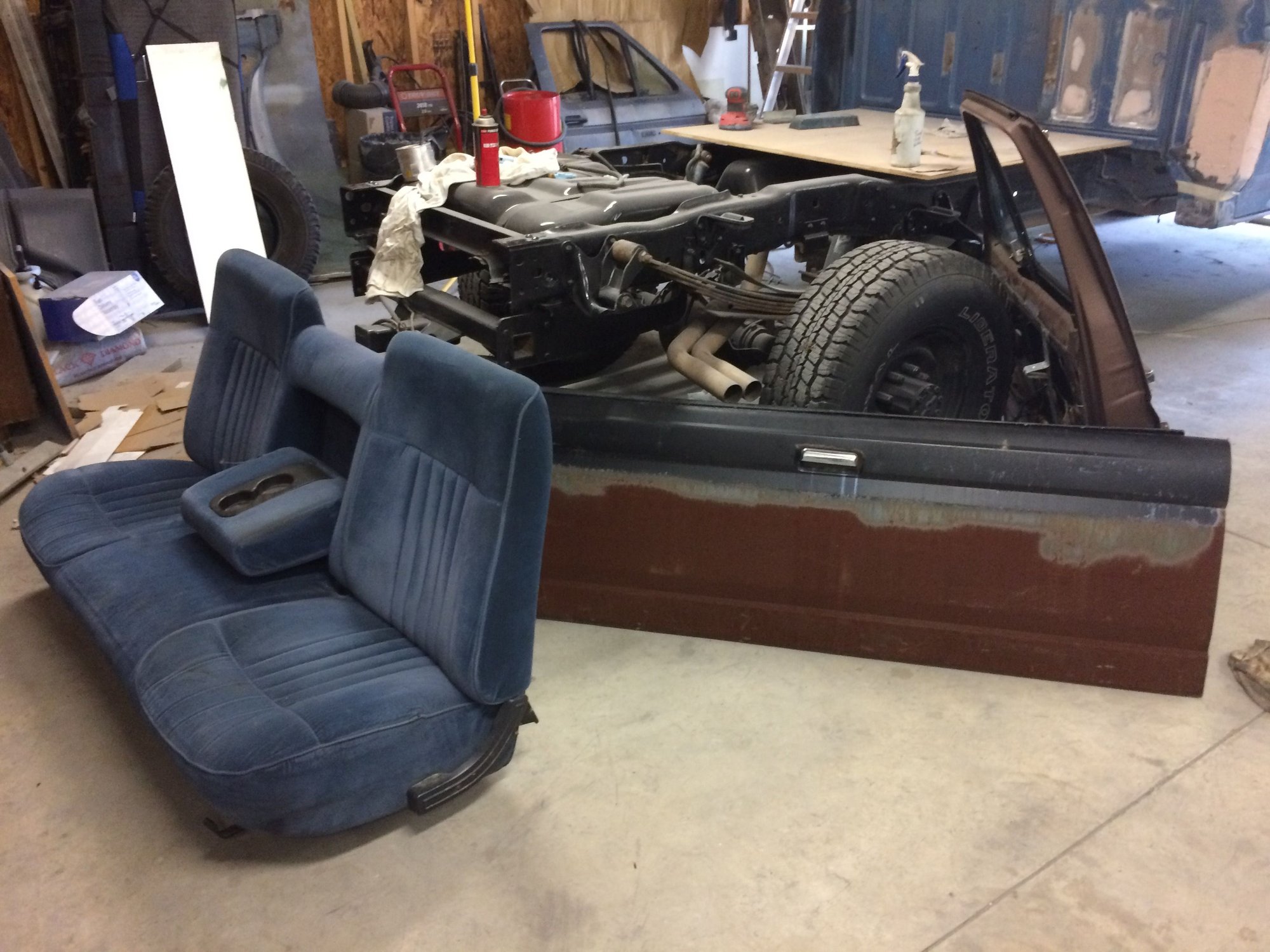

ADHD kicked in, went on a junk yard run today.

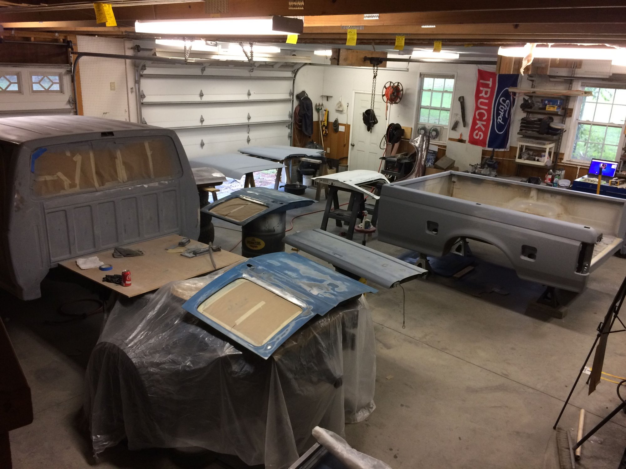

Everything is almost primed completely, and I am hoping to be able to spray some color this weekend. Assuming everything goes fine.

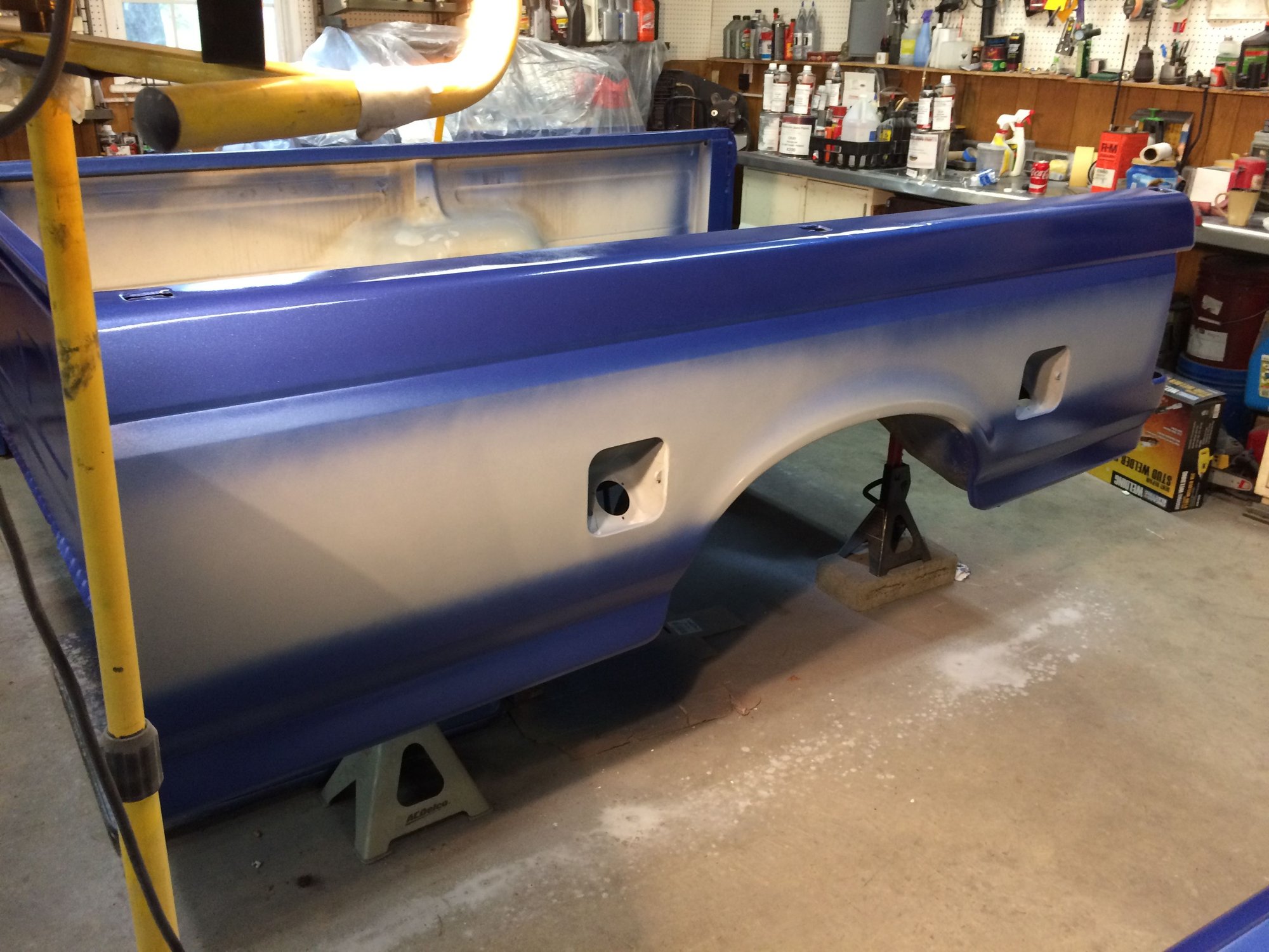

More done this weekend:

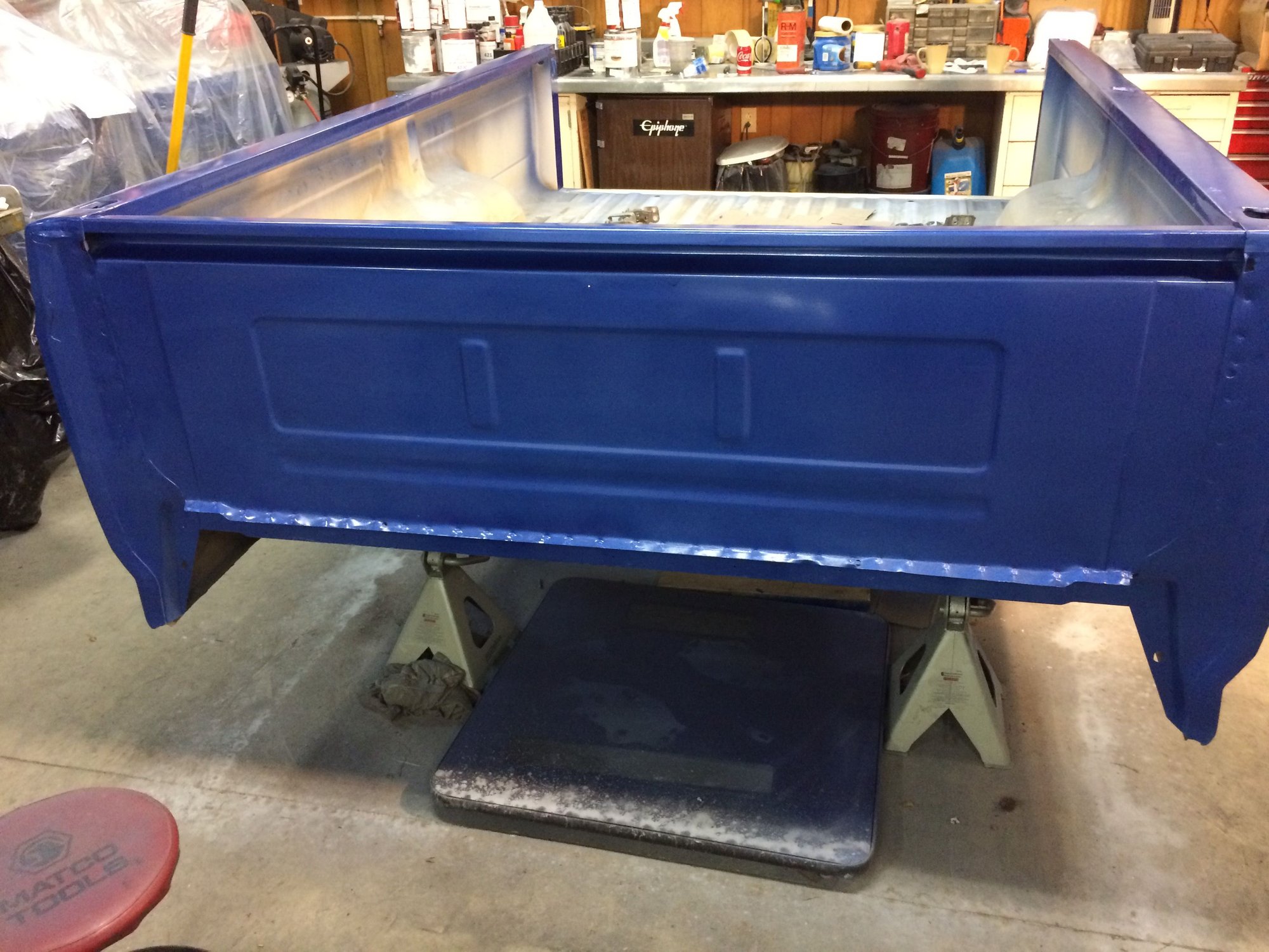

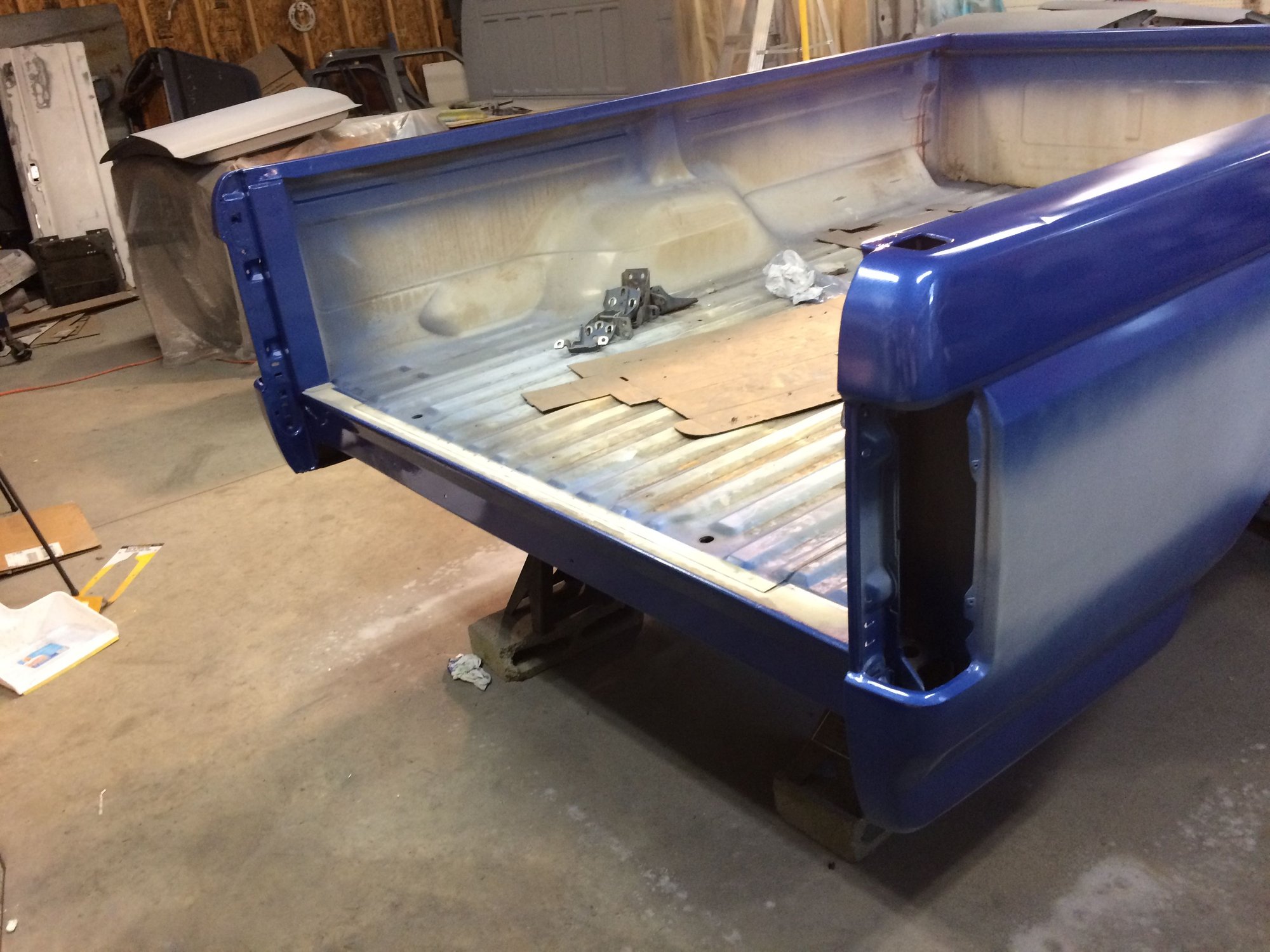

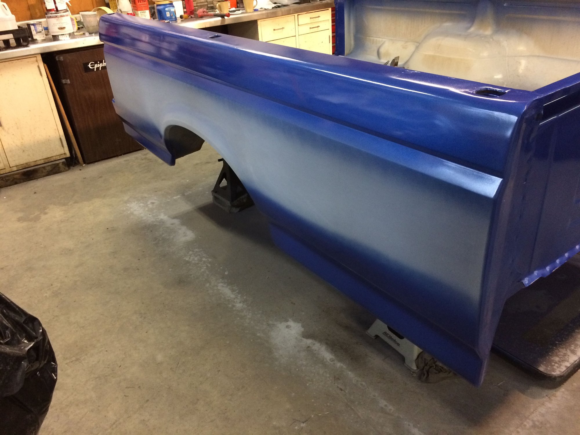

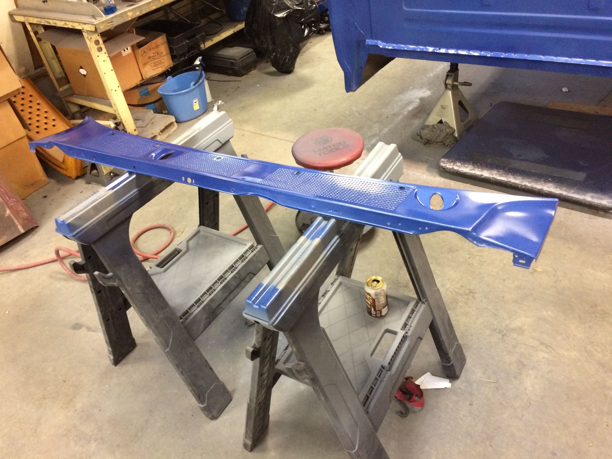

Paint is almost done. Still got a little more to shoot before the bed goes back on.

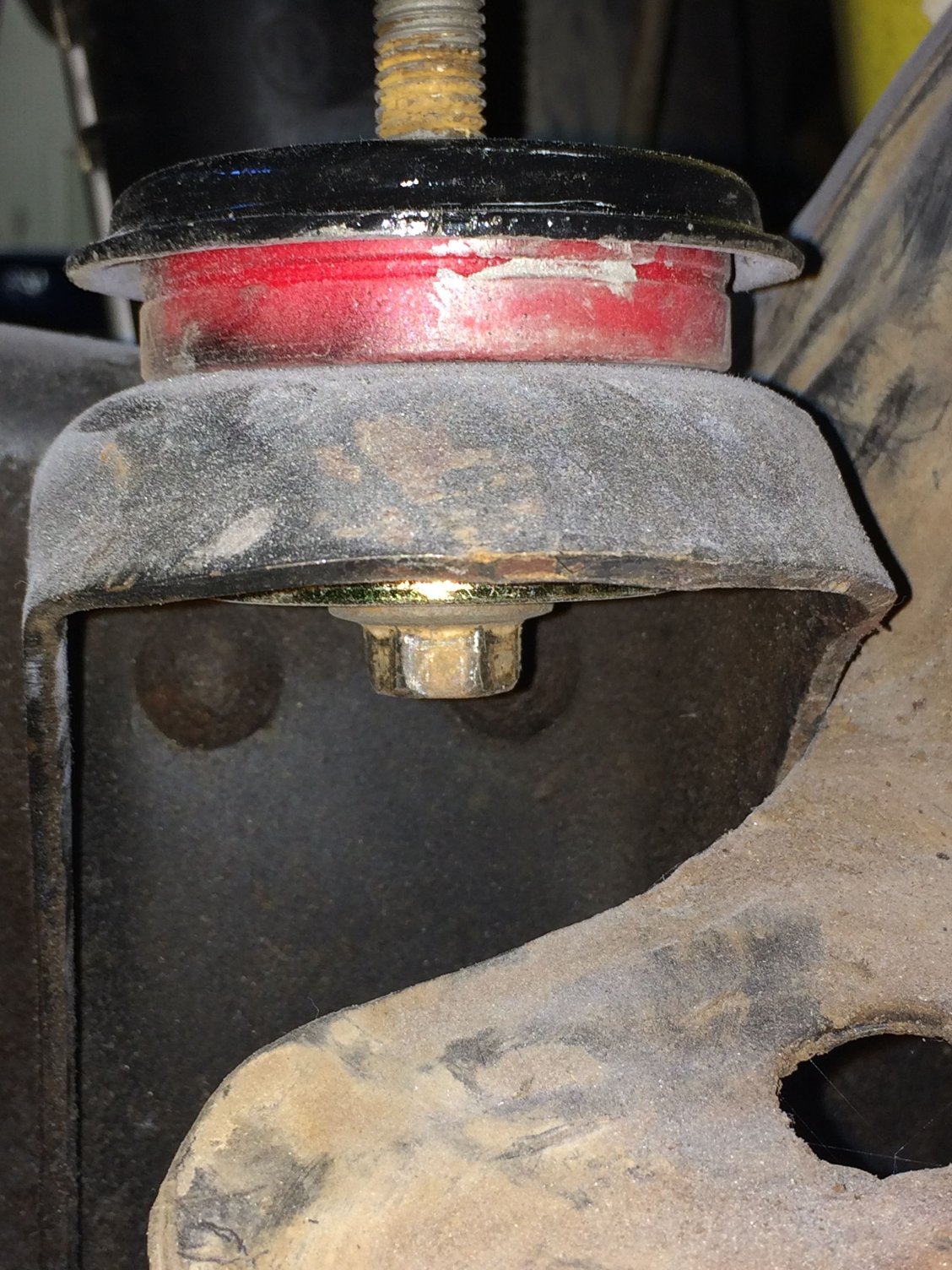

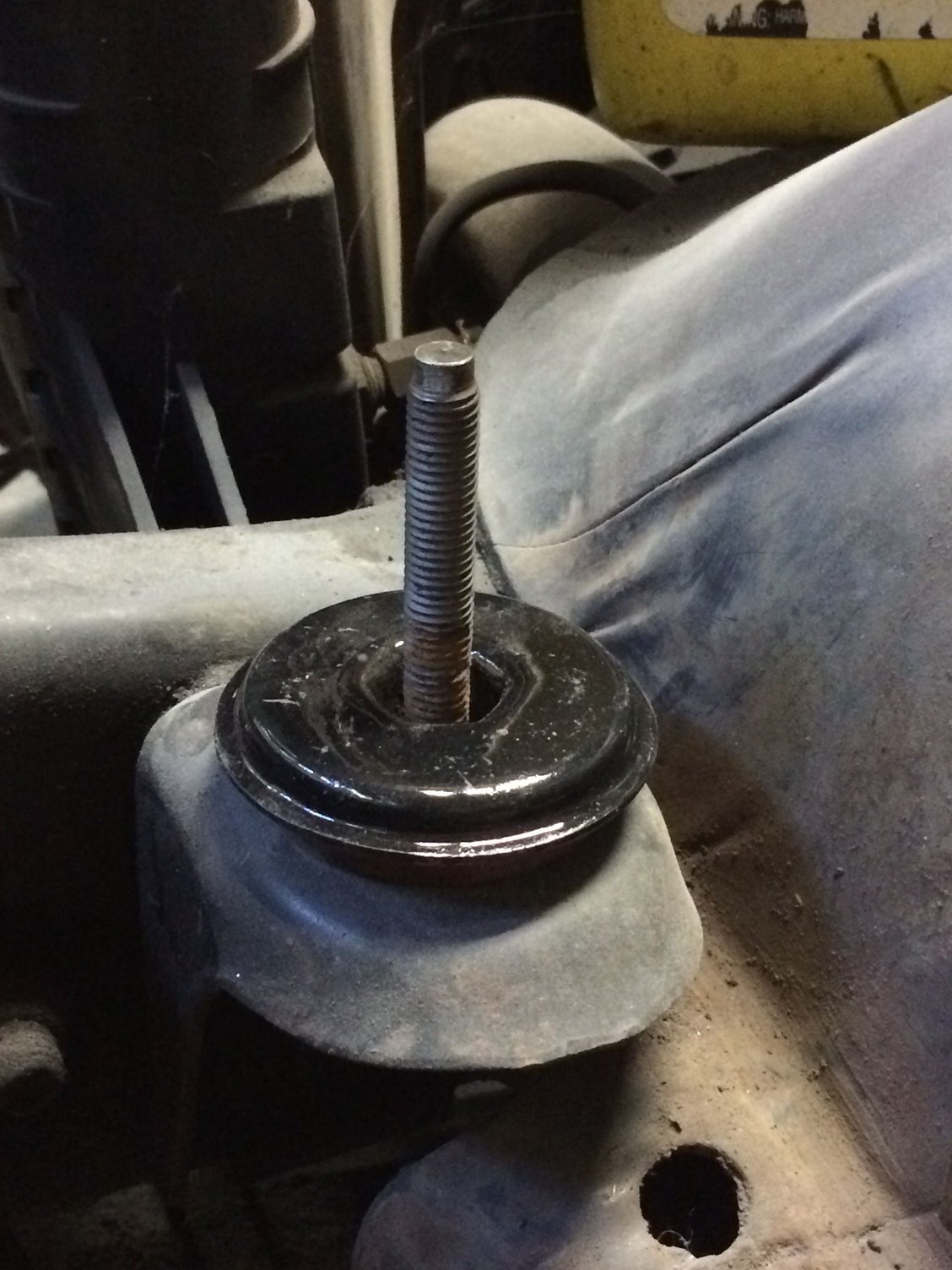

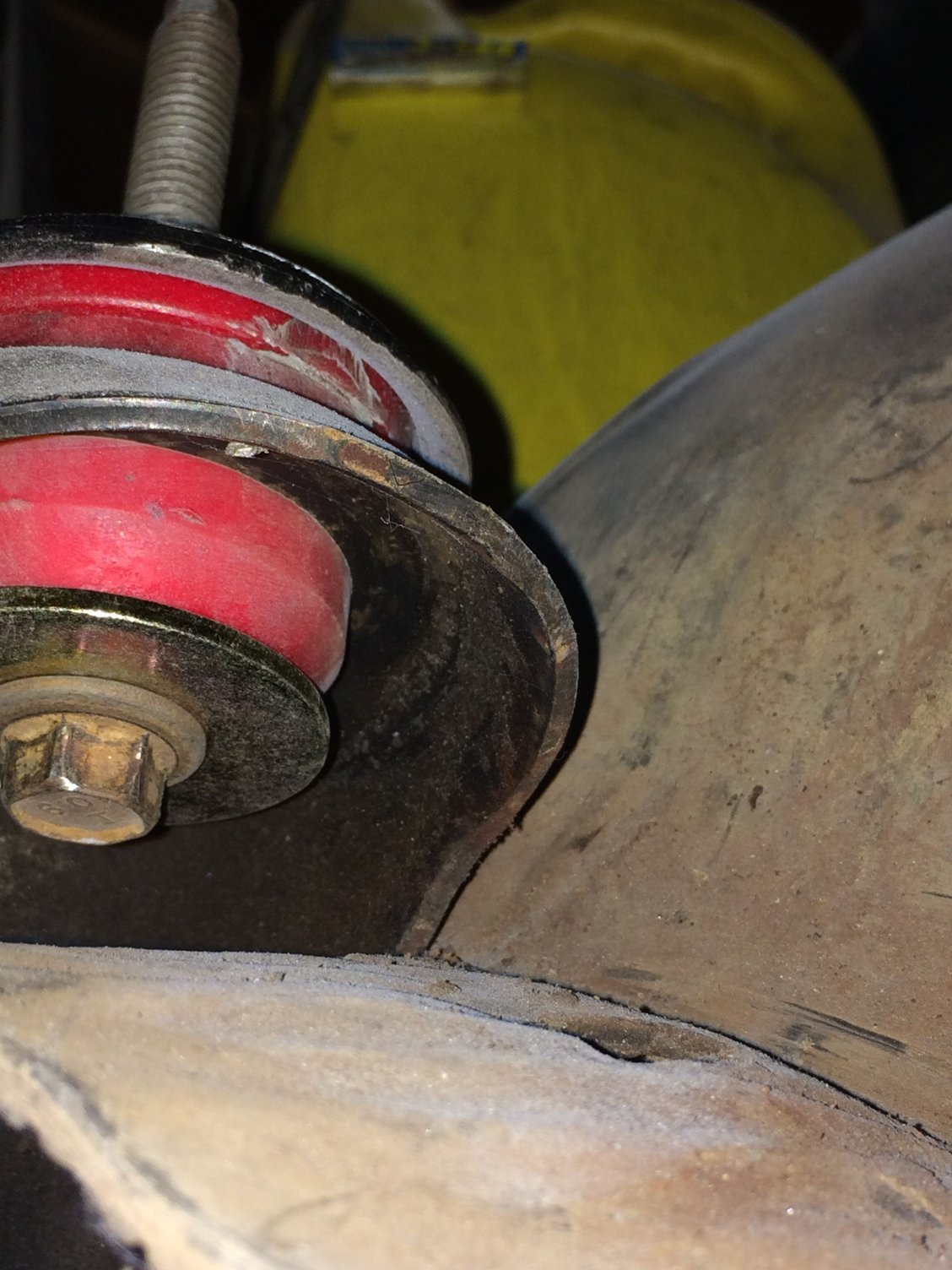

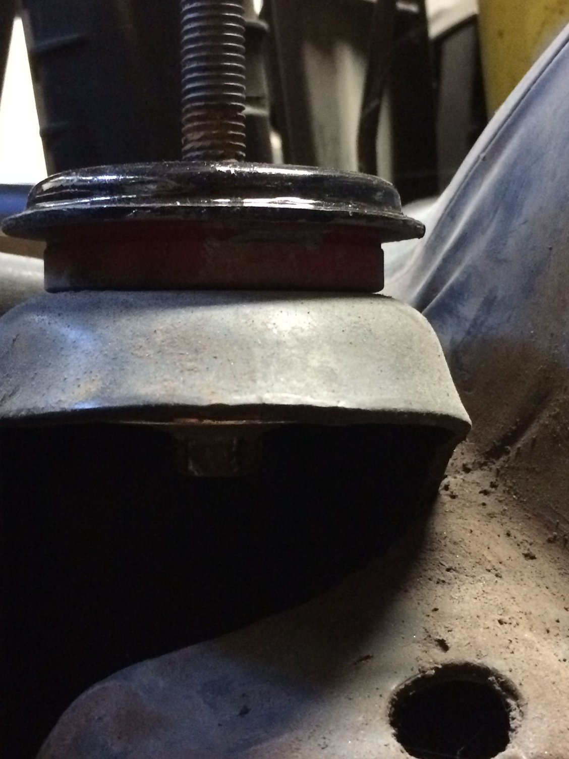

1. The Energy Suspension bushings have two pieces for the core support. However, I feel like there should be another piece. I'll post some shots of what I think it looks like. The question is. Does the core support rest on the flat washer\nut or is there another piece that goes inbetween?

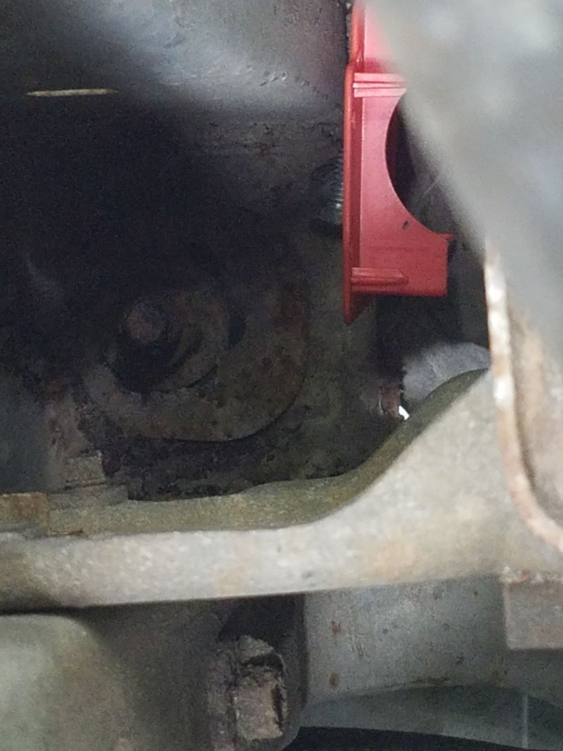

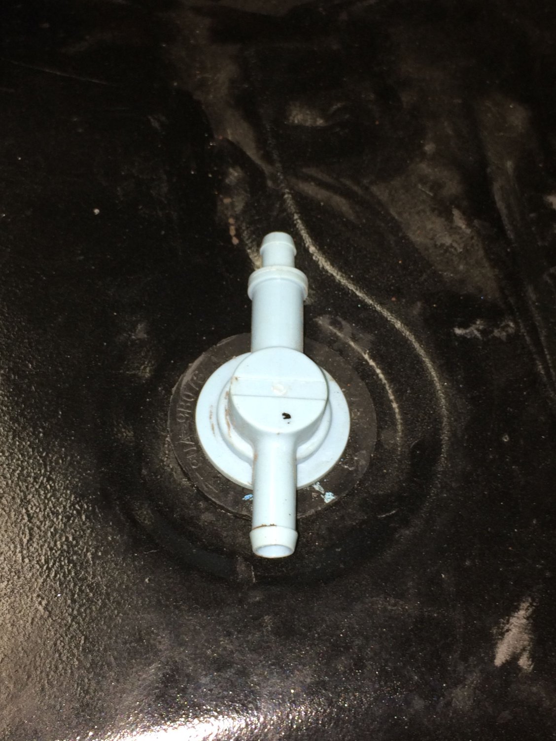

2. The evap system was completely hacked up. I've found the line that runs to the charcoal canister, and tee's off under the cab for the tanks. The tanks have 2 nipples each for the vent. Each one has a small and large nipple. Which nipple connects to the tee line for the Charcoal canister, and where does the other side of the vent go? Pics to follow.

Top
Side
Bottom
Vent connections

Thanks to 77mud for getting me this core support picture:
And FordTruckFan for figuring out the routing on those fuel tank vents. In case anyone else has the question. The large nipple connects to the vent line, then the canister the small nipple connects to a hose that ends in a vent cap.
