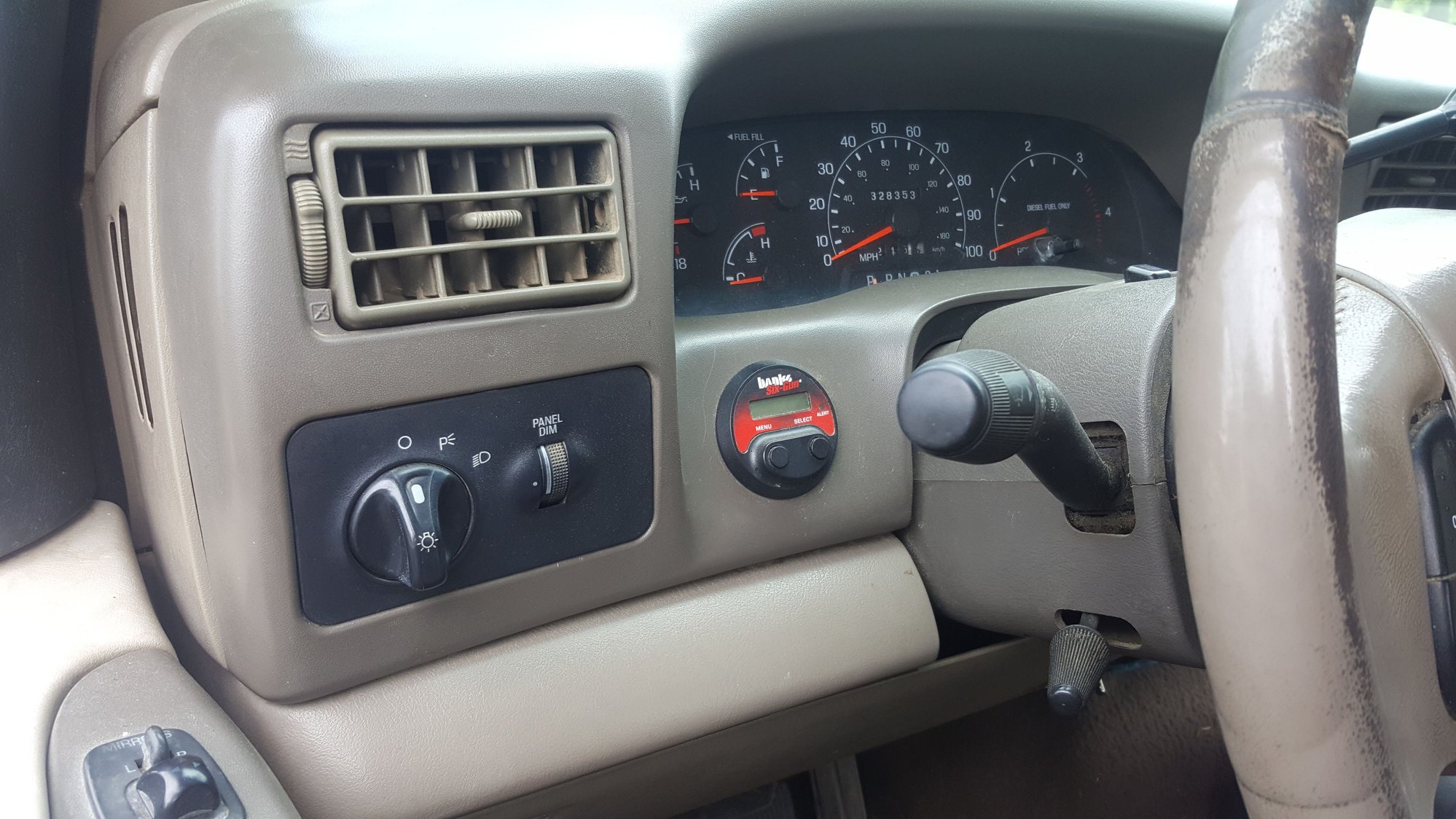

OK so I've confirmed that nothing is dragging as it rolls very easily. I am in mid Michigan to answer the mountains question. I am not towing, and it has a banks six gun tuner in it. pic attached. I've only turned it up a couple times for a short time. The display shows boost psi and it got up to I think 17 when I was really pushing it. Is that indicative of a boost leak? What should the psi read at the high end?
I have never done a boost leak test on it. I have only put about 400 miles on it since I've owned it. It doesn't put you back in the seat as much as I thought it should so I should do that. It runs really clean too, zero smoke under load and very very little on cold start. I haven't noticed any soot buildup at all.

How are you calculating your milage? If you're using the overhead monitor it is going to be far from accurate, especially with a chip or programmer installed. Have you adjusted your speedo for your aftermarket tire size? This will throw your readings off again.

The air filter is a 6637, the same a lot of guys use, including me. This should not affect your fuel economy in a negative way.
The biggest factor with fuel economy is your right foot. The harder you press the pedal the more fuel you will consume. These engines also get thirsty above about 2000 RPM's
I am not even going to mention the 6-gun at this point.....

I feel like I'm fairly conservative with the throttle. I'm not running it hard. As for the 6-gun I have it set to level 1 out of 6 which is stock settings.
