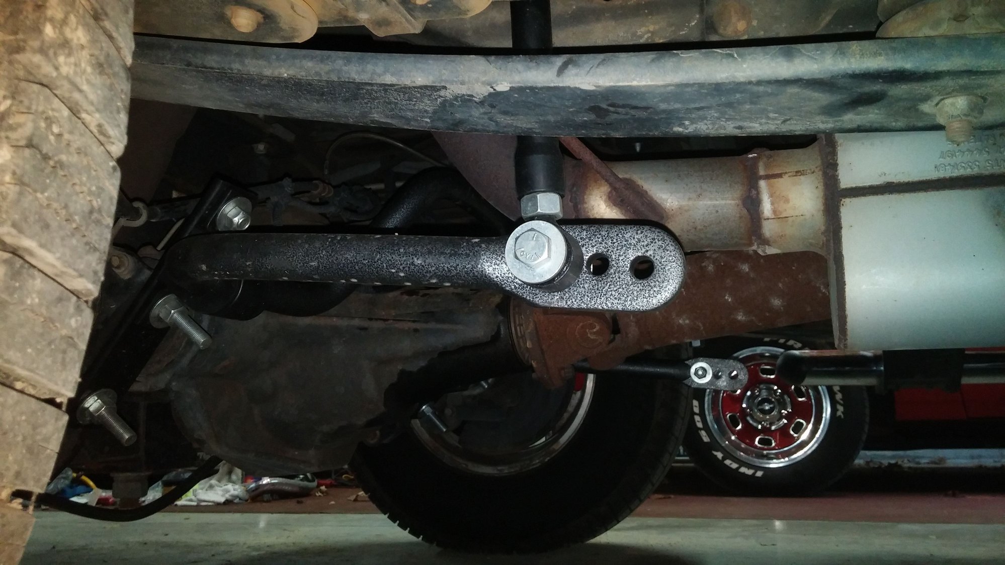

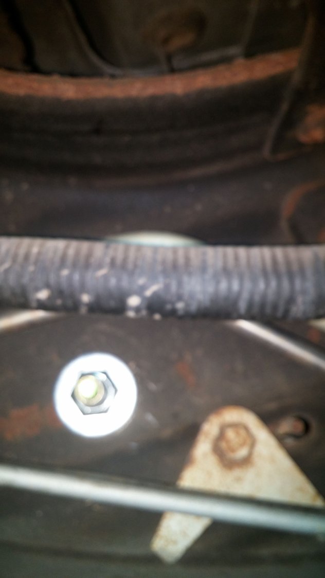

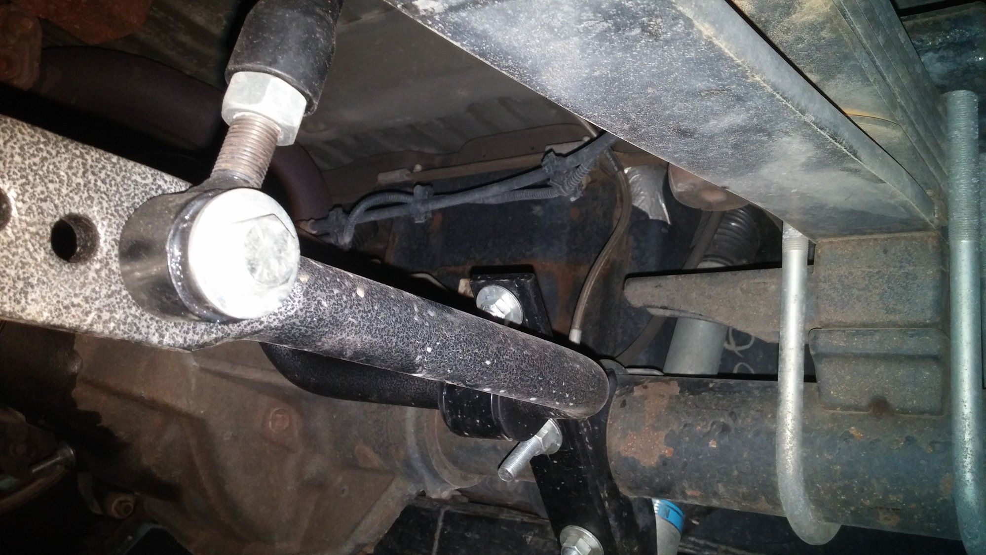

A few pictures
Originally Posted by ExxWhy
Pictures are worth a thousand words.
OK, here are a few pics of it. It seems like it's level and everything seems to be in the right spot and bolted in fine. Just the driver side end link has some threads exposed and the passenger side doesn't.
Driver side end link
Driver side end link upper bolt
Passenger side end link
Passenger side end link upper bolt

Old Jun 10, 2016 | 12:35 AM
