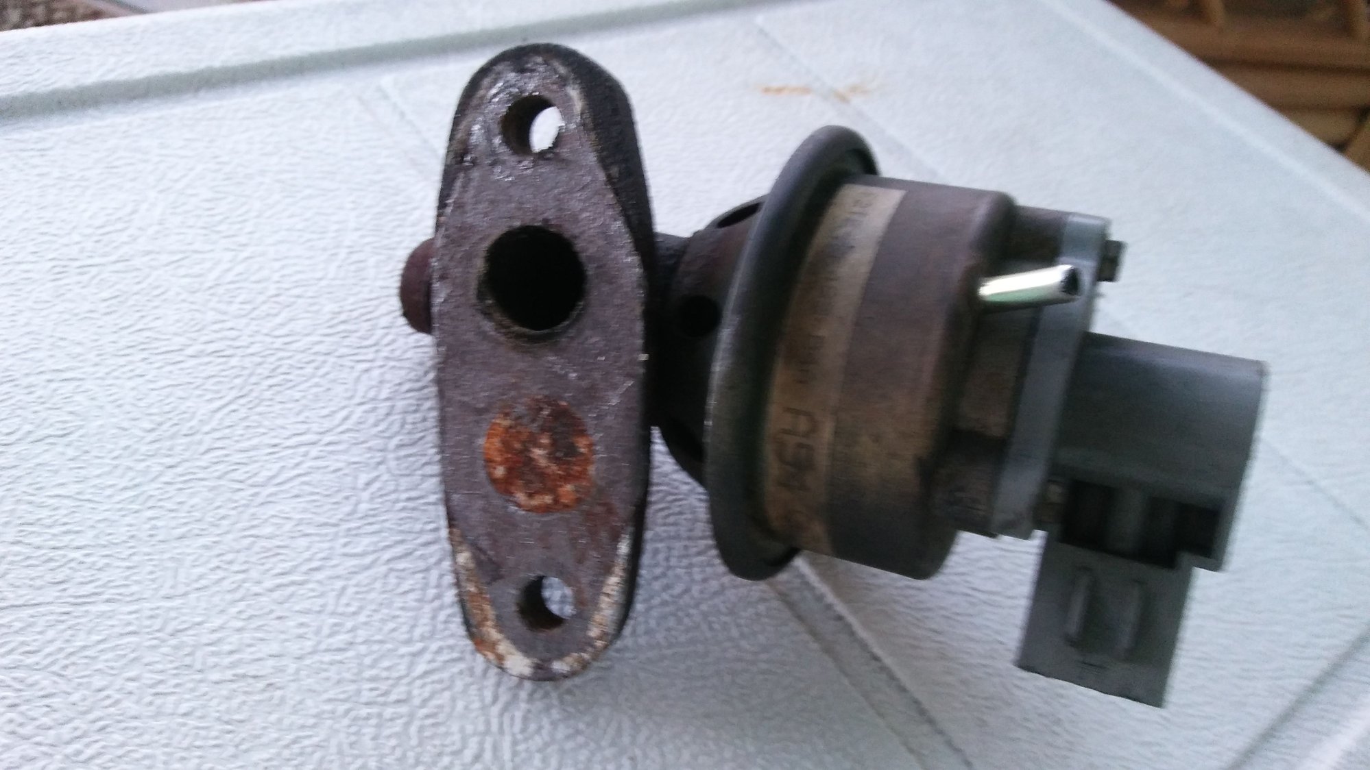

So im assuming this is most of the problem lol

So after trying to break the "carbon" out of the port... I soon realized that it is actually jb weld or some sort of epoxy maybe... But at the same time it looks like some sort of metal...
So here is my question, i guess i have to buy a new egr, but my vacuum canister is also removed. So do i have to buy both to get the system to work or is there a way i can just delete the egr and mess with the timing to get rid of the pinging.... Im not sure what to do tbh... If you guys had to make the choice what would u guys do... I have no inspections to worry about or anything. I just want my engine to be healthy and reliable, preferably with less money. Thank in advance
Sorry bout all the posts... So now i know that the egr has been like this for AT LEAST the last year ive had it. I dont think it is causing the stalling. What sensors should i check?

Does the pintle move if you apply vacuum?
Did the gasket look intact when you took the valve off?
I didnt have a way to apply vacuum so idk
No gasket lol just jb weld
