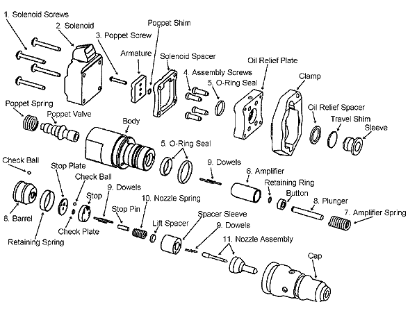

OK Guys, I have 2 Diesel trucks. Both are are 7.3L Diesels. One was made 09/96 (Non-Ca engine w/ 260,000+ miles) and the other 04/97 (Ca version w/ 160,000+ miles). I believe the 1997 7.3L has split injectors while the 1996 is single shot injectors. Do they have different sounds? The 1996 has a better low tone sounding engine while the 1997 has a higher sounding engine. Bothe engine have K&N stock replacement filter and exhaust is just down pipe till where the 2 bolts are to take off the rest of the engine. Im worried about the sounding of the 1997 split injector. I don't like the sound.
shows the difference between the 2 engines
Shows the 1997 engine sounds by its self.
shows the valve springs on the 1997 split shot.

Since you have the valve covers off what's the code on the injectors ?
Should start with AA for singles or AD for splits.

It would be AB codes for the obs Cali

Is AD the SD splits? Don't know why I had that in my head....
Old Jun 2, 2016 | 11:20 AM
fordpride's Avatar
fordpride
Joined: Dec 2009
Posts: 15,505
Likes: 18
From: Livoina,La
Yup.
AA 90cc obs
AO 90cc vans
AB 120cc obs Cali
AD 140cc SD

Code is AB. I think the injectors have been replaced or rebuilt in the past. Which is better? Single shot? Or split?

Single shoys, they require less oil than splits, the only advantage I can see from splits is that they are a lot less quieter than singles.

I frankly don't care about sound lol. I just want to do the best thing I can for the truck. What if I take the nozzles and such from the split and put them into the single shot? How would that do? More hp? Tq? Better mpg?

It can work but if you never been in these injectors then you have a good chance you'll mess them up. My Advice is leave it Alone
