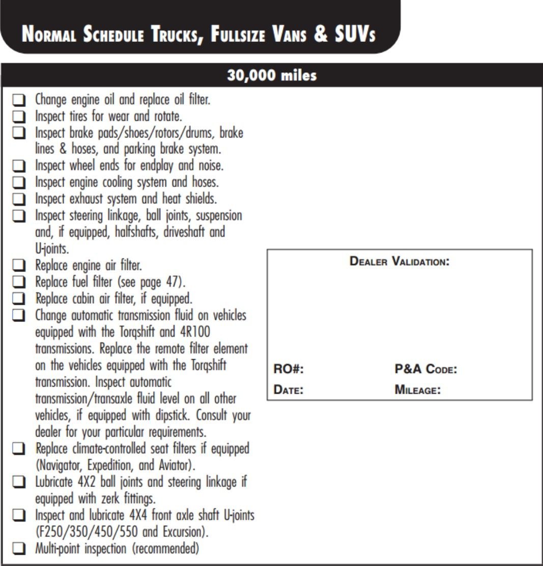

Old May 30, 2016 | 03:22 PM
Tom's Avatar
Tom
Joined: Aug 2003
Posts: 25,479
Likes: 742
From: Isanti, MN
Originally Posted by wpoldake
Good points but it appears the maint. guide shows tranny at 60k for this unit.
It's every 30,000 miles. From page 16 of your owner's guide.

Off topic, but WTH is a "CLIMATE CONTROLLED SEAT FILTER" found on Navigators, Expeditions and Aviators?
I don't even want to discuss what popped into my mind.

Part no# FS-104 filter for climate controlled seats, located under rear of the front seats one each side is a round slotted disc shaped cover about 2-2 1/2" on older models there is a cotton type fabric filter.
On new models it is just the slotted disc no fabric filter just clean to be free of dust/ lint.
He COULD put the 08+ pan and internal filter in and leave the remote filter canister empty...... then it could be every 60k.
