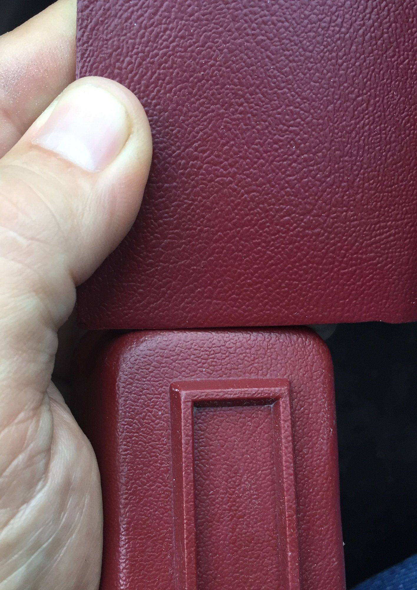

When it comes to re-painting interior plastics, the 80-86 Bullnose forum has some of the best write-ups and informative threads on the web. I am so glad I found these (threads) and read them before starting my interior refurbish. What I wish to contribute here are a few things I have learned that may be helpful to others who are working on Canyon Red interiors (interior color code "D").
From my initial reading it seemed like there was no stock color match for Canyon Red (from any paint company), only a few custom mixes for 80's Mustangs... the problem being that mail order aerosols have ridiculous shipping charges, and the availability of the custom colors is sometimes sketchy. Both of these are very unattractive drawbacks when you don't know how well it will cover, how many cans you will need, or if it is even the right color (before you order enough to do the whole job).
Soooo... since I plan to repaint everything, I decided instead to try some "close" colors that are available at local retailers. I tried the cheapest first, Duplicolor "Burgandy" HVP110 fabric and vinyl paint from Autozone. It is a high quality paint with great coverage, fantastic opacity and it is an absolutely horrible color! It is far too purple, and lacks the warmth of the Canyon Red. It has a flat, chalky finish and reminds me of very dark blueberry yogurt. The tonal value (light/dark) is correct but the hue is way wrong. Even if your taste varies from mine and you like the color, it looks atrocious next to the carpet and fabrics. Nice try but $8 wasted... sort of... (keep reading).
My next try was SEM ColorCoat Napa Red 15273 from a local auto paint supplier. Not cheap, but not mail order expensive either. I have read all the threads about it being too dark, way too dark for most 80's red interiors. Indeed, the internet pictures I found made it look like an extremely deep plum color. But I thought the hue was more like Canyon Red and I took a gamble thinking it might at least play nice with the carpet and fabric colors. To my surprise it came out extremely close to the color of my non-faded, molded red interior plastics. Canyon Red is ever so slightly more brown than the Napa Red, but I saw far greater variation between interior pieces than between the Napa Red and the piece of sheltered seat trim I was using as my Canyon Red color standard. The finish has a nice semi-gloss luster that looks identical to the original molded plastics. Napa Red probably isn't going to blend in with a 30+ year old fading interior if you want to color match a single piece, and it may not satisfy a high budget restoration, but I think it is perfect for a guy like me who just wants quality stuff that looks nice and isn't a nightmare to source.
Now for the "bad" news. The Napa Red ColorCoat is not very opaque. It goes on translucent, and while a single medium coat seems fine over red parts, be prepared to apply several layers of the stuff if you are doing a color change. But wait... remember the can of blueberry vomit from Autozone? It is very opaque, and one medium coat of Napa Red over top of it yields the desired results. This is how I will re-color my perfect tan dash pad to red. Depending on how many parts you need to re-color, this may be a money saving option since the Duplicolor covers in one coat and is less than half the price of the SEM.
I did notice some conflicting information about which kinds of plastics we have in our trucks and which adhesion promoters to use. I did my own acetone test and found that the only plastics that reacted were the brittle pieces: A-pillar covers, dash face, ash tray and glove box lid. The A-pillar covers are the only acetone sensitive plastics that are molded out of matching colored plastic. The dash pieces are painted, but both the paint and underlying plastic become soft with the application of acetone. For these I bought SEM sand free adhesion promoter. I have not tested it yet, but I will try it on a spot behind the instrument cluster to make sure I like the results. For the rest I bought SEM's regular adhesion promoter for plastics. Since it even claims to work on glass and chrome, if the surface is clean the paint should stick.
I don't have any finished results to show yet. I still need to order the SEM soap and the SEM plastic prep and vinyl prep solutions. More plastic adhesion promoter and more Napa Red now that I know it will work. Doing this job correctly is not inexpensive... but I have done enough junkyarding to see the ghastly things that happen when people just grab a rattle can and go for it.
I do have one question perhaps someone can answer. My A-pillar covers have some of the horrible black windshield glue on them. Since the plastic itself dissolves in acetone, what can I use to remove the black gunk without harming the plastic?
Edit: Lighting is EVERYTHING when it comes to photographing color. Note that the piece of seat trim is the same piece in all photographs and did NOT receive any paint. Now that all the photos are displayed in one post the results look deceiving. I will follow up with better images of the Napa Red vs. Canyon Red. The important point is the relative appearance of the two within the same photo.
