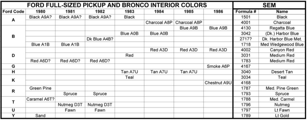

My own interior is Canyon Red (Trim code D) in my 1985 F150 Lariat. I personally love this shade. It's like a dark red/orange/brown combination...very unique. It goes great with my Medium Fire Red (Trim code 51) exterior color.
I went to my local PPG paint store and had them mix me up a batch of SEM Canyon Red last Summer when I repainted my own interior. It wasn't cheap, but it was a *perfect* match. This stuff works FANTASTIC!
First thing, awesome post and great information! I'm always scouring the forums to get notes of what I can do to make my truck better on my own. (Of course with help from y'all) My door panels are whitish/pink because of the fading.
Secondly, is this paint that Diesel_Brad and Lariat 85 the same thing? Trying to learn which paint to look for when I refurbish my doors at some point.

Originally Posted by Gary Lewis
Dave - Decode your certification label here: Certification Label - ???Gary's Garagemahal. The body code is what you are looking for.
Thanks, Little brain fart on my part as I was looking for "trim code" and not "body".
So when the chart has "red" I would not know what color red till I try and match it with the can. I see posts for different reds but Gary's chart only has red how did you come up with what color red to use?
Dave ----
Did you find the Interior colors page?
^^^^ What he said.

Thanks, will go hit the local auto shops again and see if I can find anything close to those codes. Just went by the catalogues they had and the Reds were very bright Red.

Don't expect the Ford factory paint codes to be of much help today; these trucks were built 30-some years ago before computers were as prevalent as they are today, and this information was contained in paper manuals/books back then.
I ended up comparing offerings from a few local paint supply stores (places that supply paint & products to auto body shops) and got my SEM Color Coat color-matched and custom mixed; it's not inexpensive (about $75/quart) but I got exactly what I wanted.
