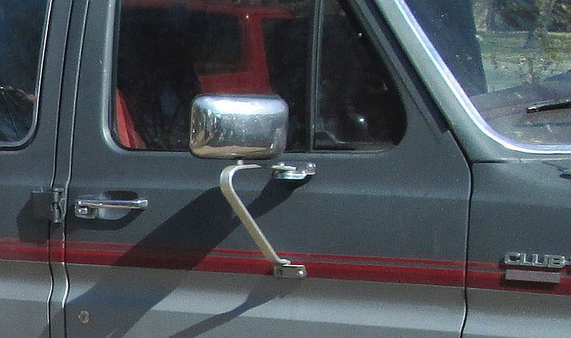

My '88 had the those factory hangers on it with a plain flat mirror. I mounted a rearview wide angle camera on the hanger and the monitor on the inside mirror. Great view of everything on that side. The camera was about 20 bucks on Amazon. jim
