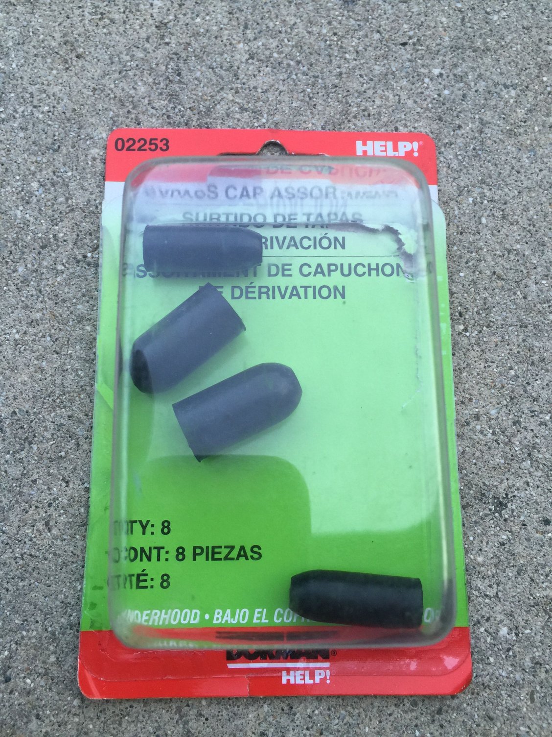

This is not perfect, but it is what I did today. Cost was $5.69
You can see on the manifold, that two hoses come off and another from the water pump.

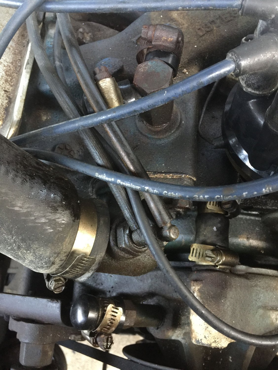

And you can see them installed here

Wow, you basically removed the entire flow for the heater. Are those caps strong enough to hold that temp and pressure?

It says that it is designed for it, it is blocking a water pump outlet.
My heater core, housing, ducting, everything, was removed by the previous owner so until I get that all sorted, there is no reason to have any deteriorated hoses running around.
