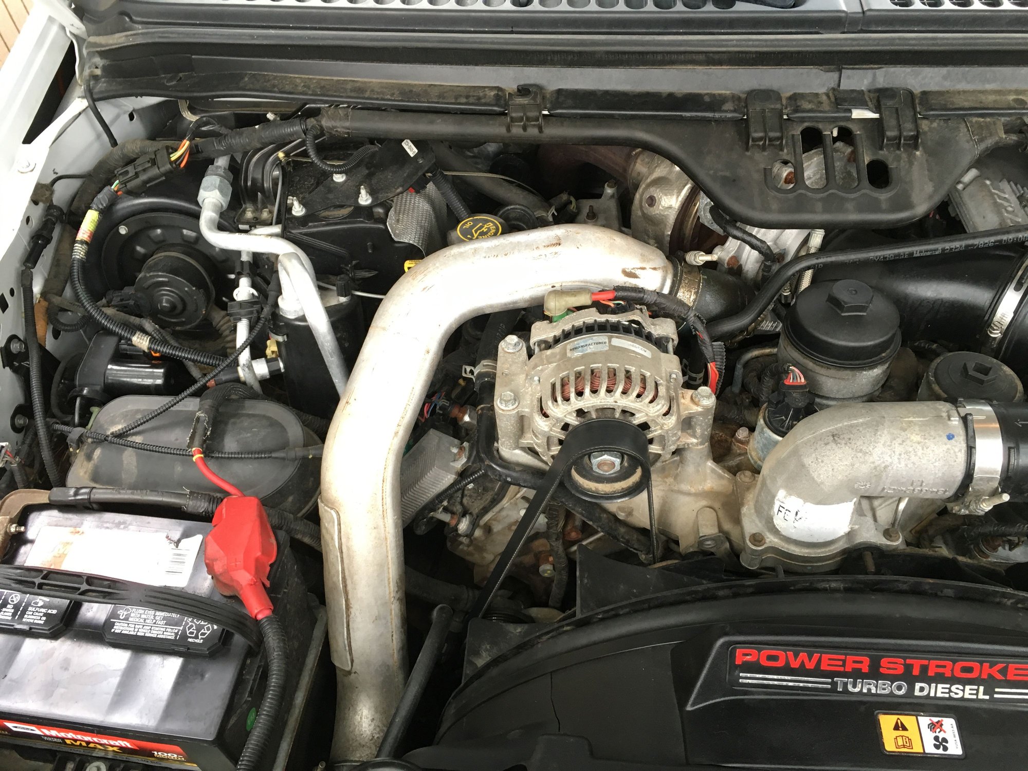

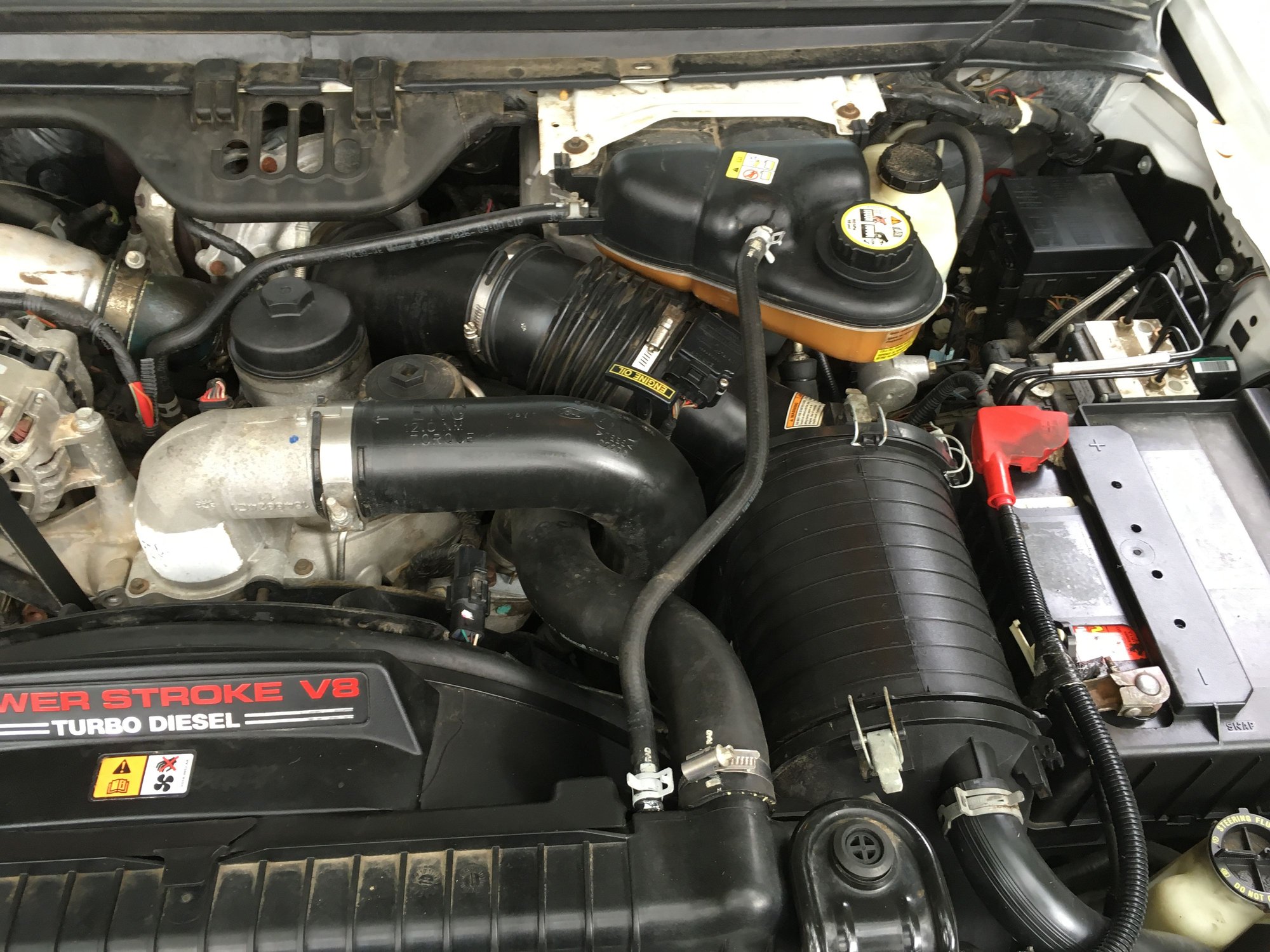

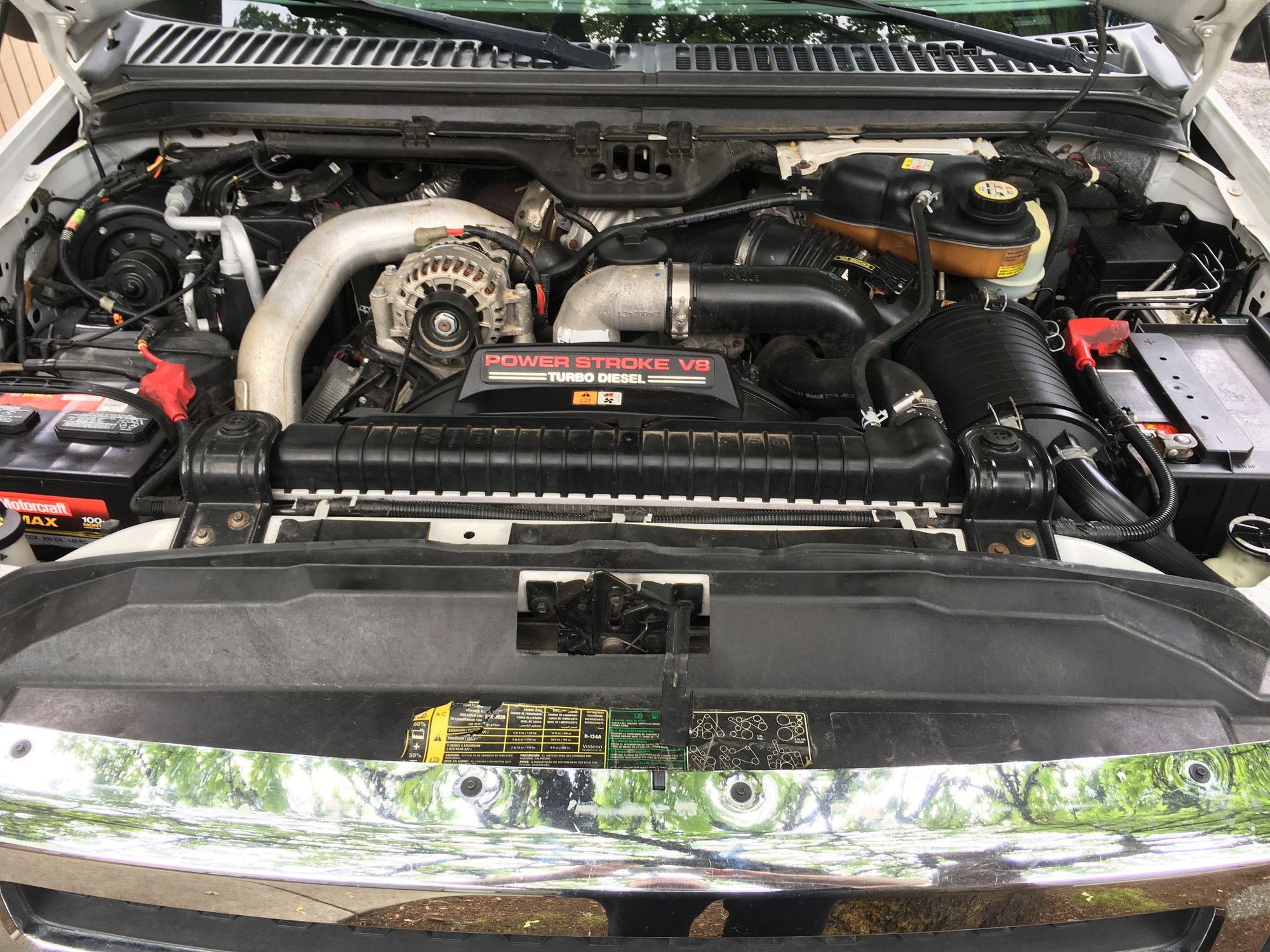

Hey everyone. Just got this truck over the weekend. Some of you guys suggested I post picture of under the hood. Take a look! Pretty sure it's all stock in there. Was thinking about getting an cold air intake system. What do you think?

Congrats!
Looks pretty clean under there.
I would skip the CAI, but that's JMHO.

The engine bay looks good, nothing out of the norm I can see.
I would not get a CAI, the stock air system is good for up 500hp, and it filters better than anything else out there.

And get rid of that plastic intake tube.

Another vote for stock air inlet. Look at it, it already does a good job getting cold air. I would however get something to read data. LOTS of options here. I like torque pro app for sat phones with a bluetooth adaptor, under $25.00 total. I went wit a SCT TS programmer for my dedicated reader. Can look at 12 pids at a time, comes with "canned" tunes or you can download custom ones. Reads and clears trouble codes, prefomance tests, tire and gear ratio changes, among many other features.
