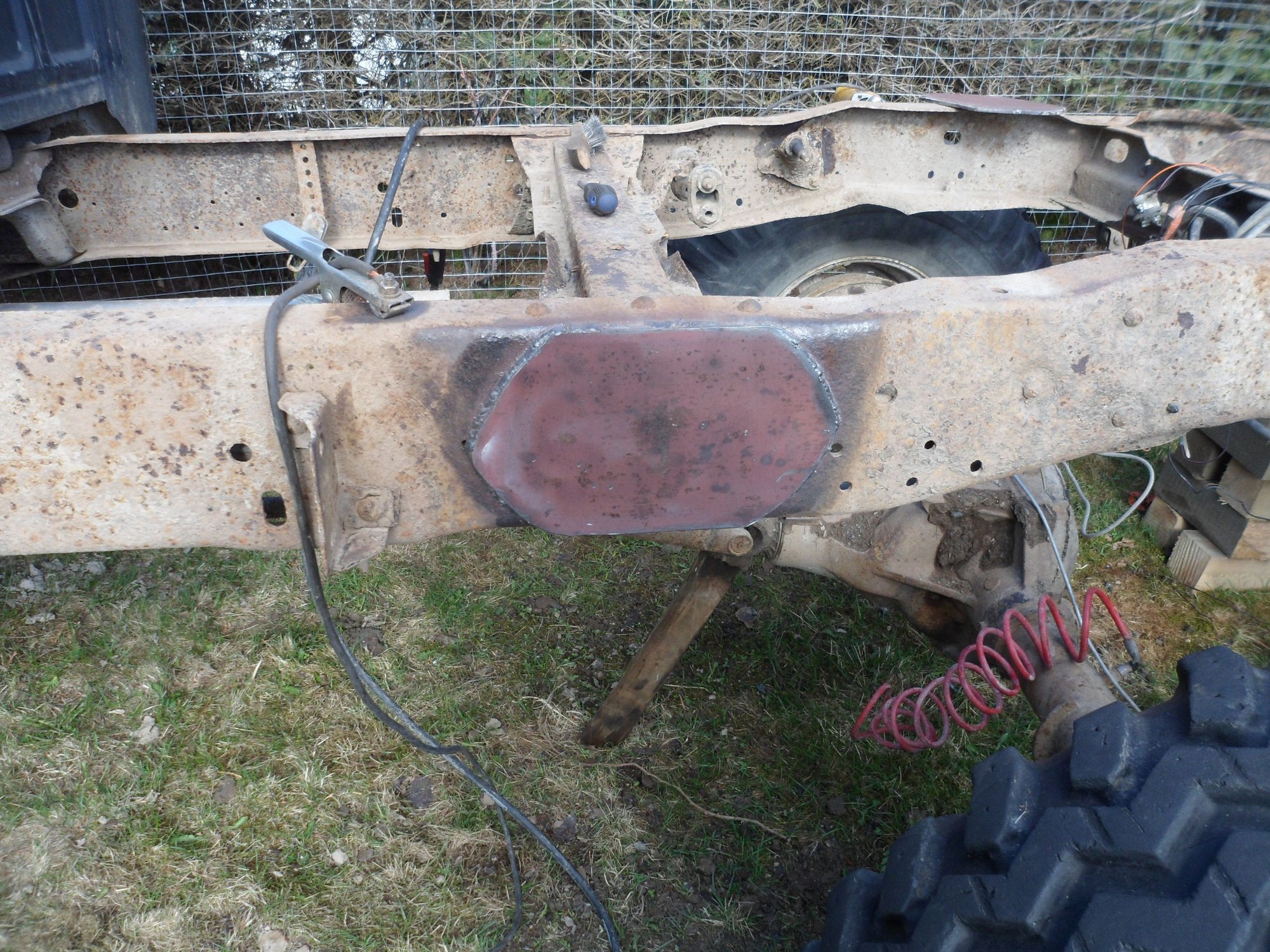

TIG is great for thin/rusted away metals, you can gradually add filler and heat as needed to build the metal out. I don't have any pictures of things done "the right way" but i have an old pic of my dad's 70 cougar that had the hood hinge bolts ripped/rusted out, i repaired them running at like 30amps, before i had a gas lense, with a 3/16" tungsten and 3/16" rod. Before i knew any better. With a thin rod and tungsten you could repair a soda can if you wanted to.

A 120v flux core welder is great for portability and is fine around 3/16" steel. If you just need to quicklley weld something, cant get something near a 220v outlet, or don't feel like setting anything up you can just grab it and go. The welds arent awful with them
