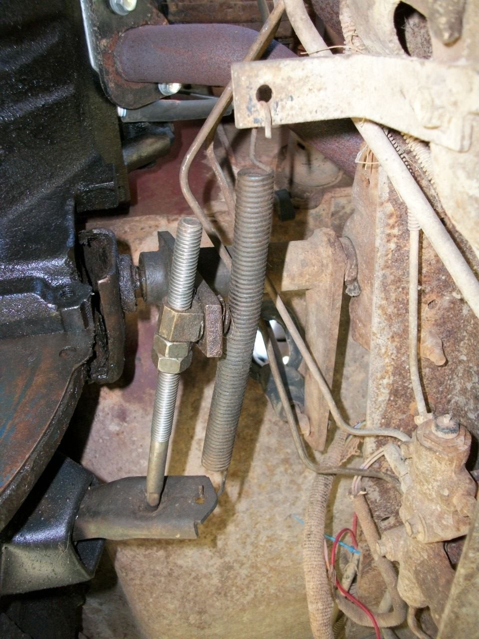

Was putting in a new brake line and temporarily unhooked the end of this spring that goes through the clutch fork. While installing the line, the spring fell off and I never did see what the other end attaches to. Can't figure it out. Sorry for the crappy pic, doing the best I can under a 2wd. Lol.

Oh some kind of frame bracket? Anyone know where the heck it is, exactly? I didn't see it anywhere down there but I'll look again tomorrow.
Edit: that diagram says 4x4, mine is a 2wd, not sure if that makes a difference. The combo valve is right around where the spring looks to want to attach.

I found this pic on the Internet, but if you compare to my pictures, my setup looks a little different?

Mine simply hooks into a hole in the cross member.
Clutch spring 2wd 1979 351m f250
Rotate image 90 degrees right for up and down perspective.

Ok that's what mine looked like. Let me see if I can find that hole!

Thanks for the pic, helped me find it. It wasn't quite where I had been thinking. Got it hooked back up and headed out for gas now.
