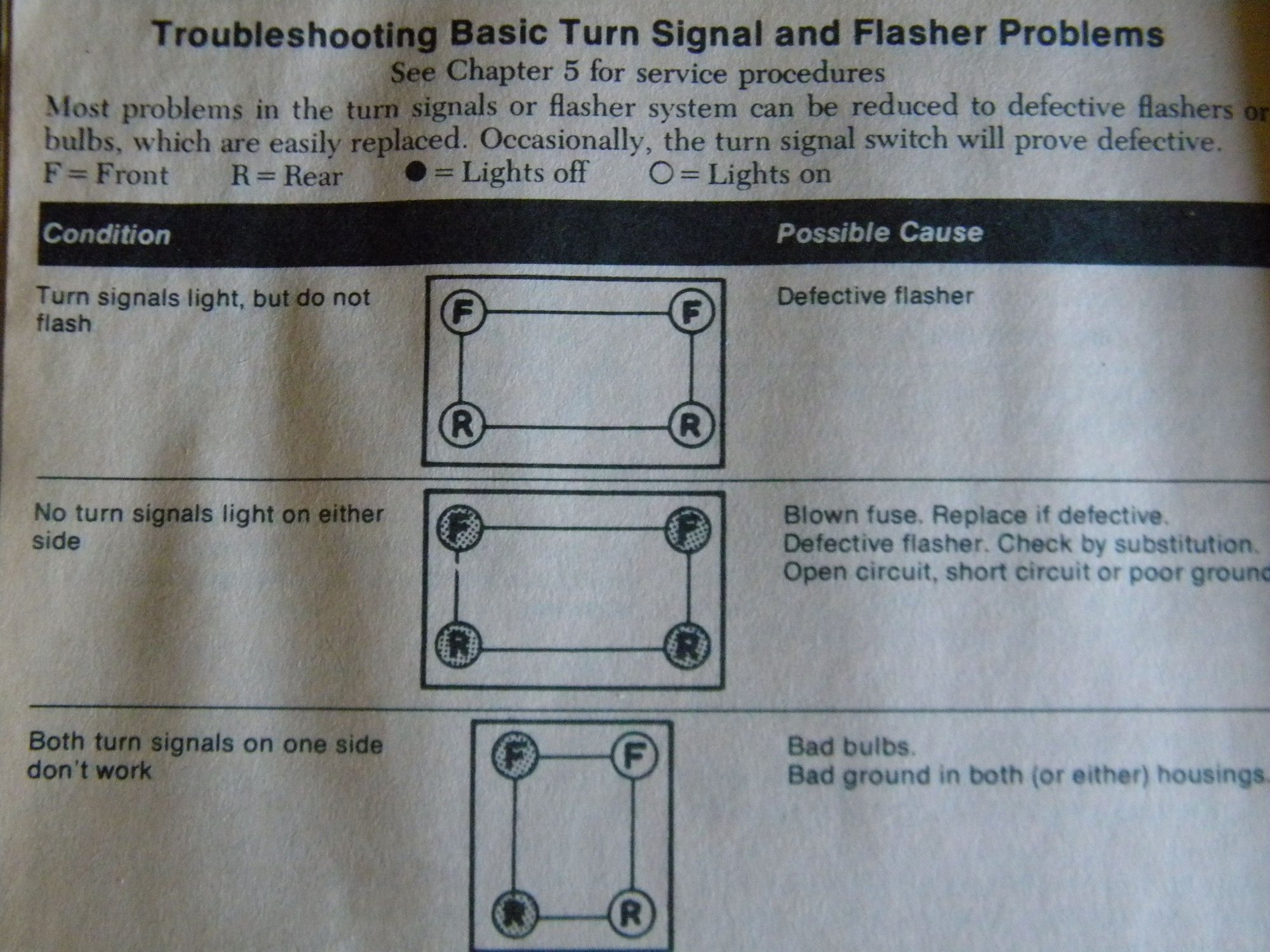

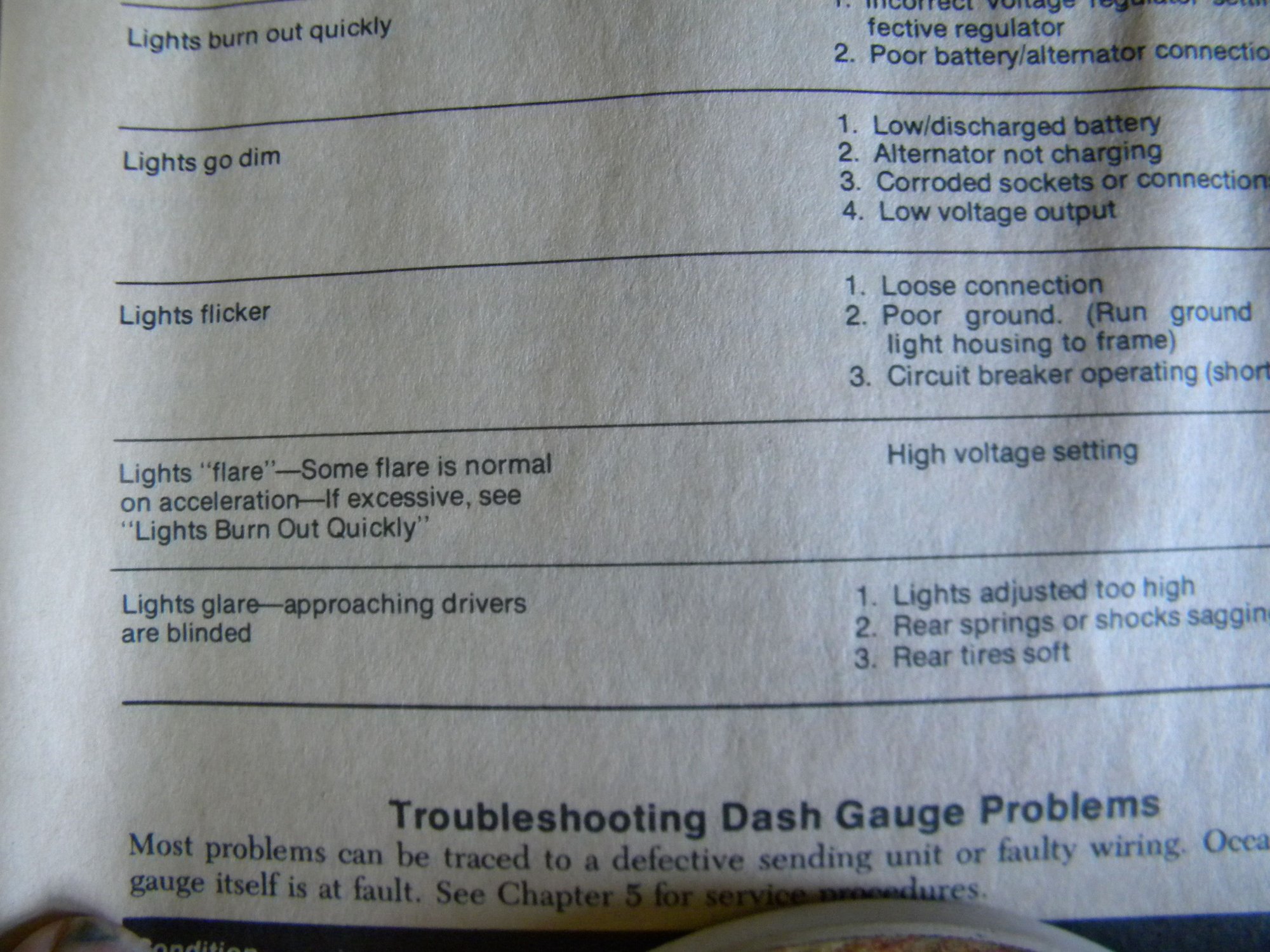

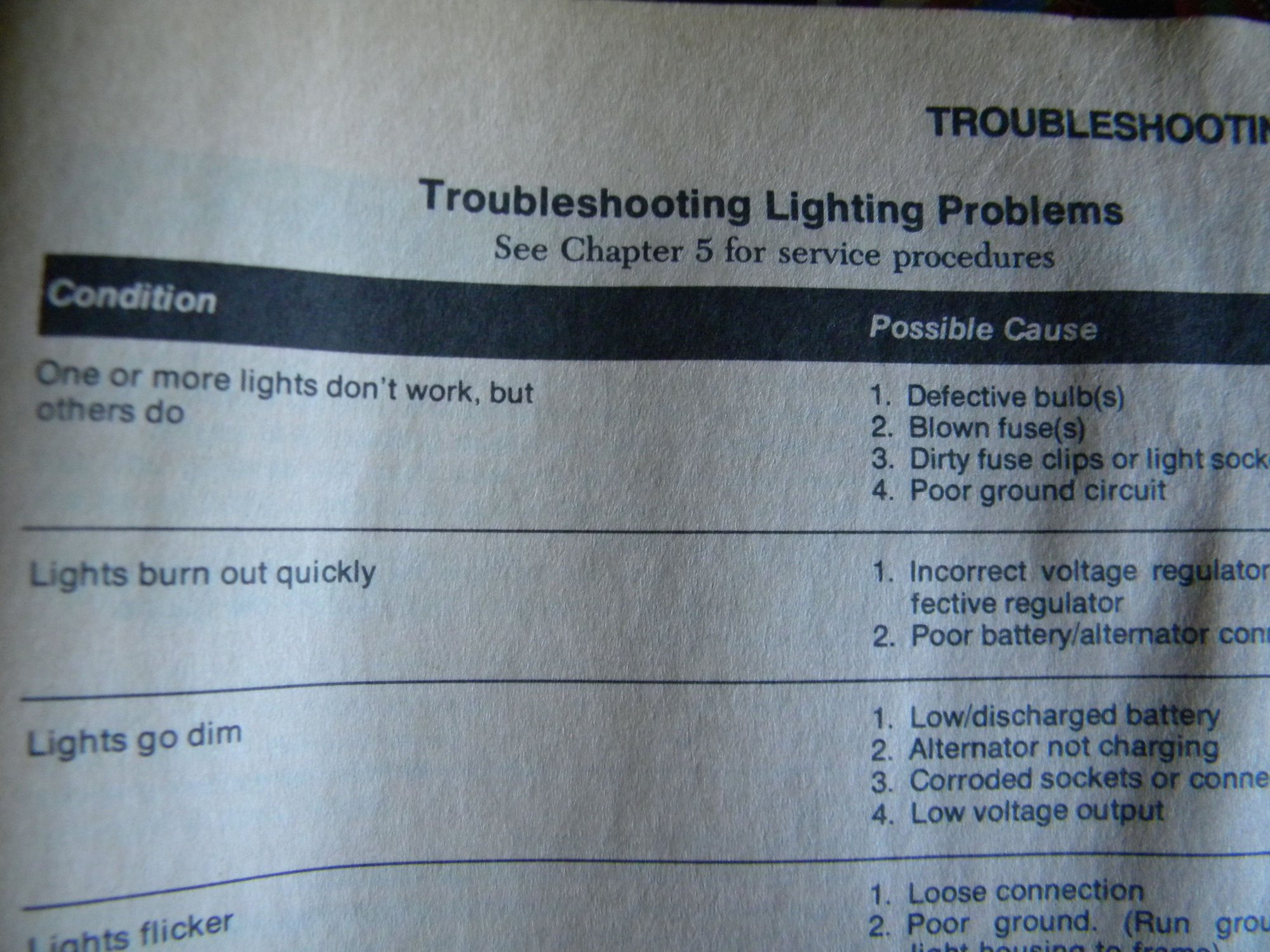

MANUAL, MANUAL MANUAL
Get a Chiltons or a Haynes MANUAL....
they REALLY do help
