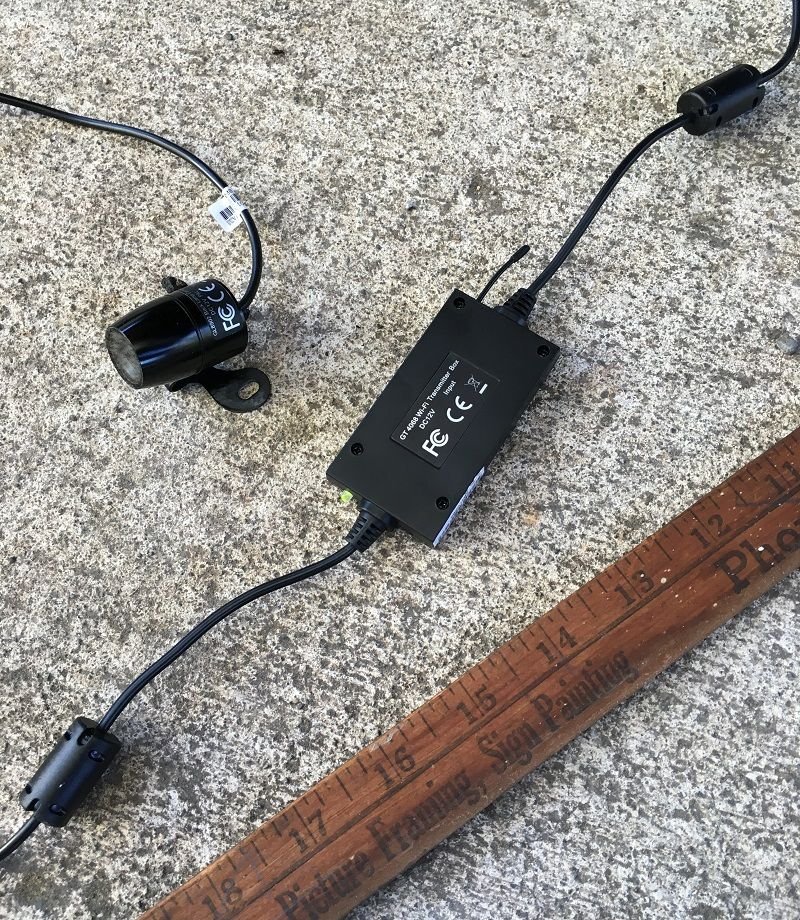

Here's an overview of the camera and wifi transmitter. There is approximately 3 feet of cable between the camera and transmitter, with a slim disconnect in the middle for easy routing. Although the camera is advertised as waterproof, I doubt the transmitter is, so plan to install it out of the weather. The disconnect plug will pass through a 7/32" diameter hole:

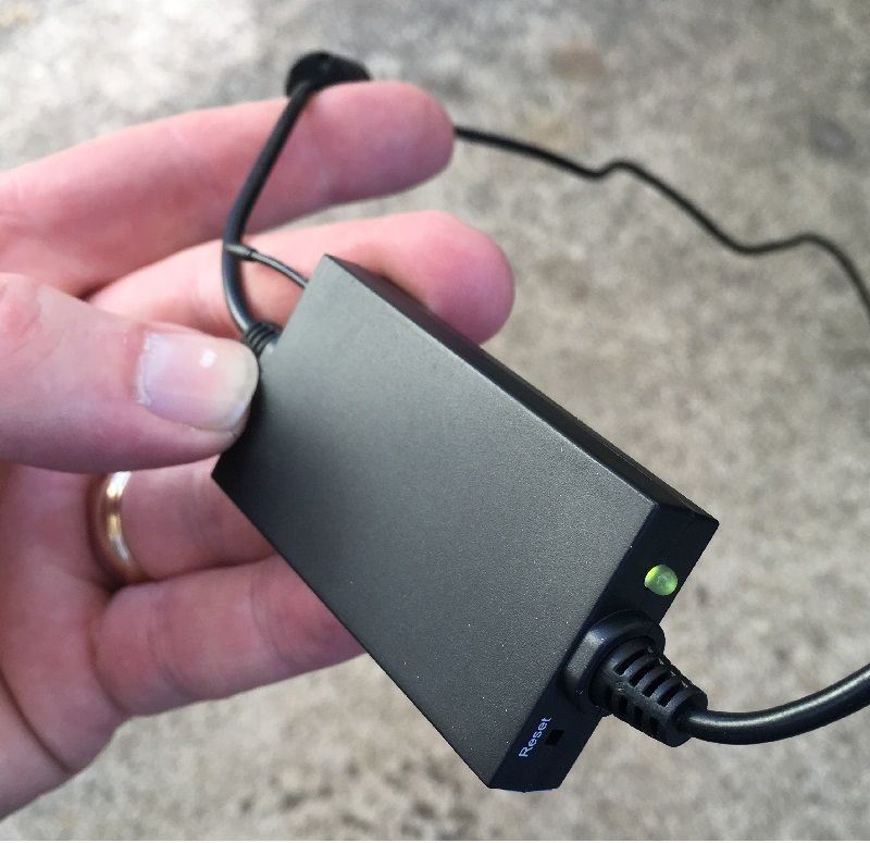

This closeup shows the transmitter. Note the green LED indicating the unit is powered and ready to transmit. It's not really a big deal, but the transmitter does not have any mounting provisions. I used adhesive-backed Velcro on mine. The only wiring you need to do (other than connecting the plug to the camera) is tapping into 12V power and a ground. The instructions recommend using your backup light circuit, but I chose an ignition-switched power source instead so I wouldn't have to wait for the unit to power up when preparing to back up:

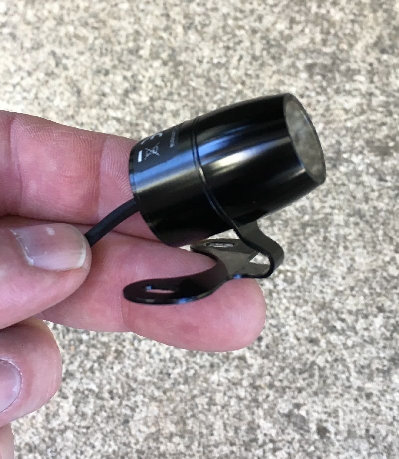

Here's a close-up of the camera. At first I was disappointed with the adjustment method (you bend the metal base) but it is actually very sturdy:

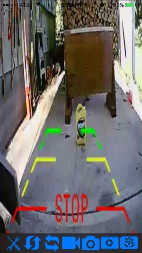

You will need to download a free app from the manufacturer to interface with the camera and transmitter. If anything, the app was the only disappointing part of the whole set-up. You can play around and flip the image side-to-side or up-and-down, depending how the camera is installed. Unfortunately, the app has no way to remember your preferences, so you'd have to set it up again each time you power it up. I didn't have to mess with this, but in some cases you might, so keep that in mind. It's not really a deal killer, but that would be annoying.
Here's a screenshot of the camera view's of my carport, as displayed on my iPhone. The camera was mounted 32" above the ground, and is angled down slightly. For reference, the yellow antifreeze jug in the middle of the picture is approximately 6 feet away. The green, yellow, and red hash marks (including flashing STOP legend) are fixed and cannot be turned off:

I played with the camera a bit more last night. I can safely report the advertised "night vision" feature is a bust. In the dark, the night vision tells you it's dark out. That's it. Even with the backup lights on, the display was pretty much black and of little use.
Eventually I'd like to keep an eye on my Jeep under tow, so I also tried turning on the camera while driving after dark. With some ambient light from streetlights, etc., the display was useable. However, any headlights within a few car lengths would wash out much of the display.
Typically, my camper is off the road by dark, so the poor night vision is not really an issue for me. The camera is still pretty slick in my opinion, especially for what I paid, as long as you are aware of these limitations.
