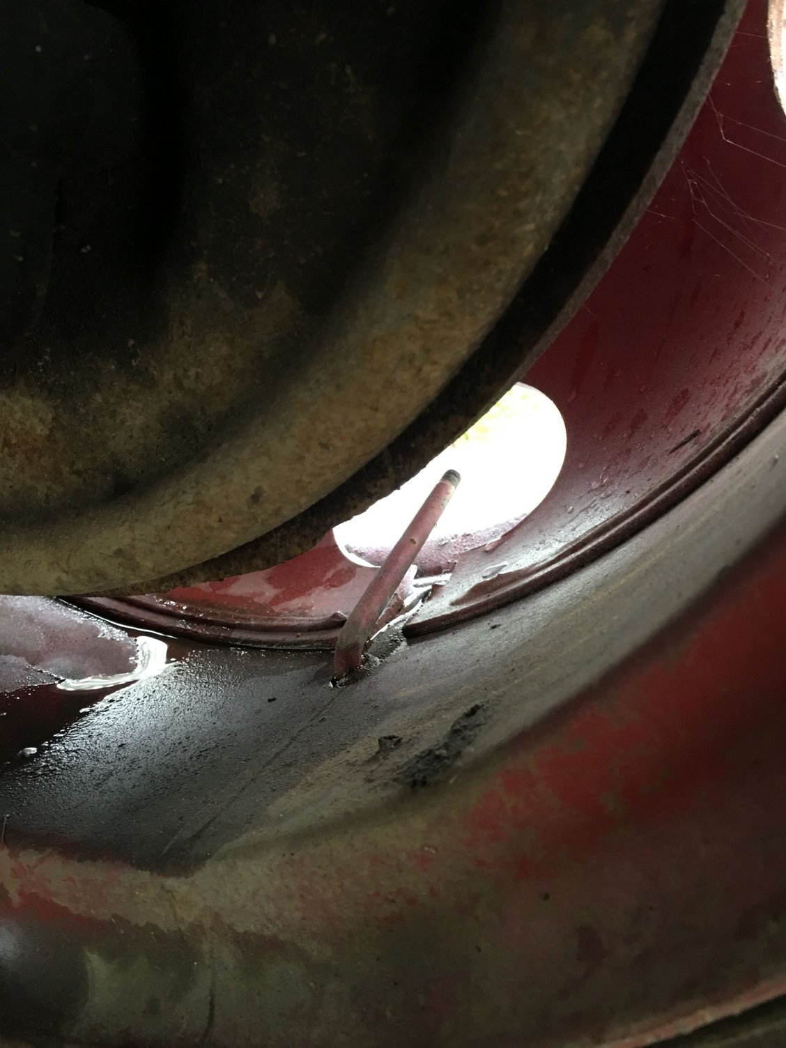

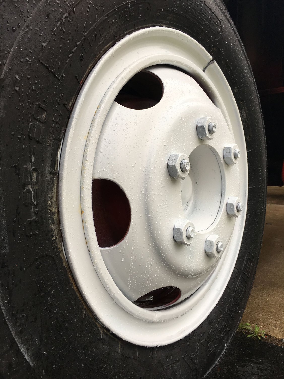

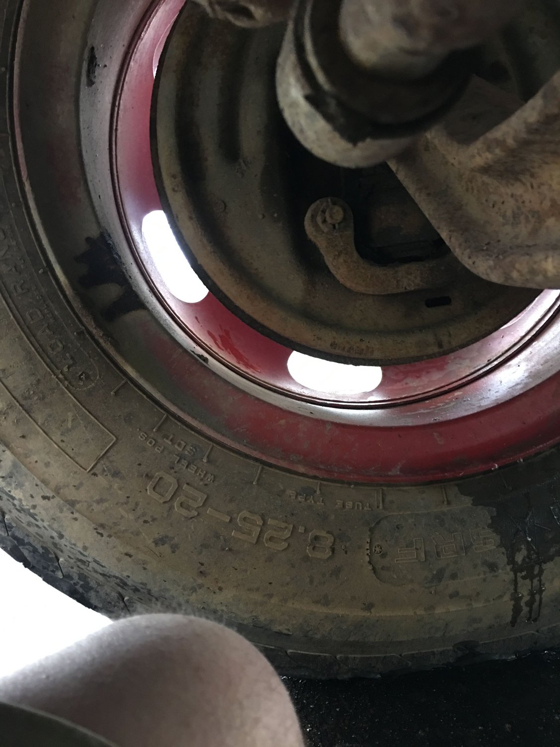

Are these widow makers?
1974 f600. Thanks

Only when they experience catastrophic failure...

Those are "split rims" and in some places no one will work on them anymore. They are generally only dangerous when seating the bead and most shops that sell truck tires should be seating them in a safety cage these days anyway.

Widow makers? I don't think so handled correctly. Used successfully for many years. If very rusty they can let go. Yours look OK from the pics. Tire mounting and initial air up needs to be handled correctly as mentioned. Also need to find a tire store that will work with them... as mentioned not all do. It is also important to run a wheel liner so the tube does not get pinched.
If you are running a lot of miles and changing tires you can probably find a tubeless (not split) rim in your size or close as replacement.
