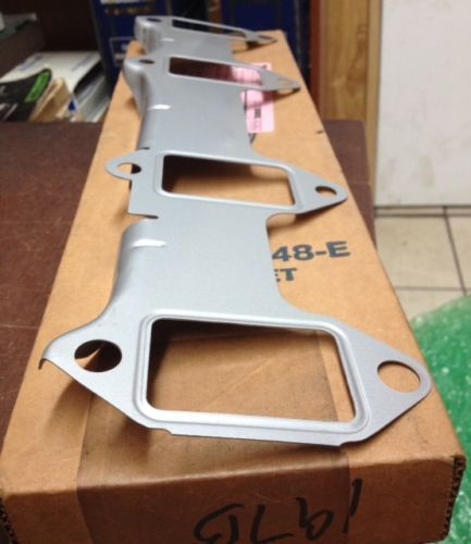

Put in a good timing roller chain as the oem replacement one's were retarded to meet the EPA liking.
Also to cut to the chase, I'd pull the heads and get hardened exh. valve seats installed
as it's just a matter of time that the unleaded gas causes them to over heat and burn the valve seat then the exh. valves itself. Any kind of towing does them in faster.
The old lead additive which helped some but did not stop erosion of the seats but just slowed it down and foul the plugs if used to much at one time.
These trucks were designed to run reg. 91 octane gas and with today cost for a gal. of gas is a far cry from the day of .035 cents a gal. so most people put in the cheapest gas that is like 87 octane which makes these engines rattle & ping unless the timing is backed off some.
And if you plan on not running headers the use the stock exh manifolds but the heat shields all stamped steel sheet metal type gaskets. As you'll notice the exh bolts have locking tab bolts. If these are not reused or stage 8 locking bolts not used the bolts will slowly loosen that will cause the exh. manifolds to leak and soon make a exh. leaking noise.
This is what the heat shields look like in below picture..
