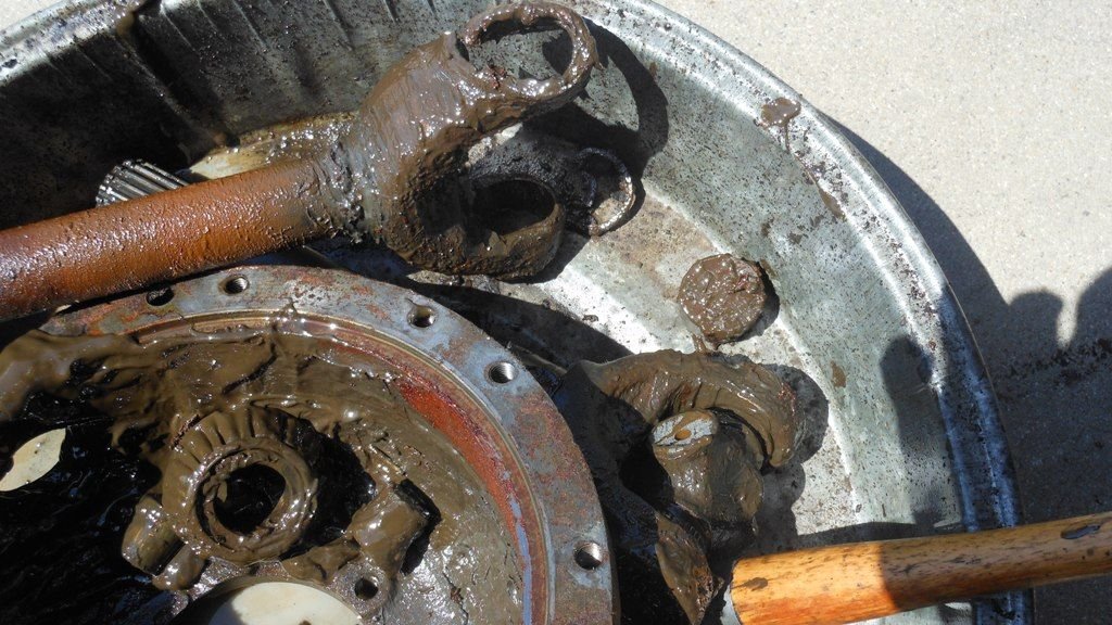

Haven't looked at the front axle yet, but pulled off the rear cover to see what happened there. No metal pieces fell out. Turned the ring gear and spider gears multiple times and everything looks good. Removed the drivers side axle. Nothing I can see there.
Seeing I was backing up while pulling, you think something with the brake hardware hung up and made the popping noise?
Old Apr 30, 2016 | 04:56 PM
mikepo's Avatar
mikepo
Joined: Jul 2015
Posts: 44
Found the culprit. As bad as the driver's side is, I think I better pull the other side apart and check it out.
