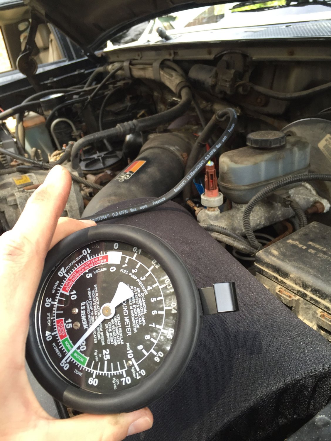

Old Apr 22, 2016 | 12:13 PM
kyle j's Avatar
kyle j
Joined: Jul 2010
Posts: 486
From: Cape Cod Ma
So this is where I'm at? What's next? Really hurting for money right now and can't continue to throw parts at it?

Was in a pinch for money and time couldn't do both sides the same day, fixed the problem replaced the vacuum pump yesterday
