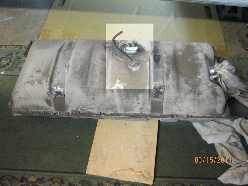

That was my system, JW. About a 3/4 inch hose plus the 3 inch filler hose, connected to steel pipe on each end with gear clamps. NO flap in the gas tanks (dual tank system), and a vent hose on the top of each tank attached to a roll-over valve. The valve is just a ball on a spring weighted to close if the tank goes on end or upside down.
The thing is, the vent hose in the fill neck is 3/4 inch, this thing is maybe 3/8 and goes to the charcoal canister. It was designed to pull vapors from the fuel.
I had a theory that the gas pumps had two sensors, back pressure and excessive fuel feed (in case the pump nozzle fell from the car or the hose got cut). I think it was too much fuel flow that caused the shut off but I could never prove it. jim
1988 front tank E150
