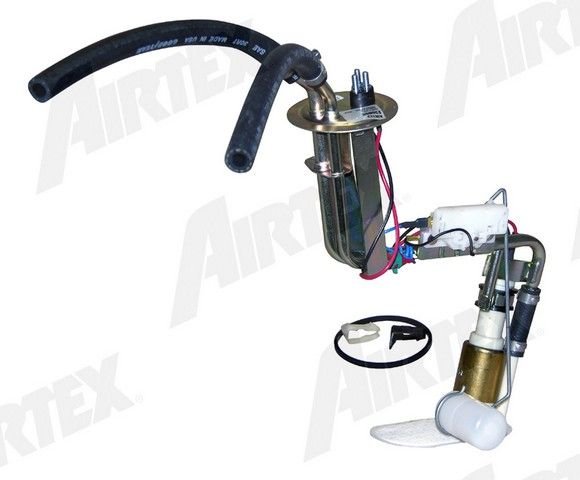

Another option would be what I did and use an Airtex E2089S (from 1984-85 F350 7.5L).
Only low pressure internal pump on it so you would still need an external pump (I used a 90's Ford frame rail one). But at least it drops into the rear tank, the level sender outputs the same range, and has a return line provision.
Only other detail was that I couldn't find a pigtail to connect to the 3 pin flange connector so I modified a 2 pin one to get power to the pump.
Ideally a setup completely within the tank would have been awesome, but since i have a plastic front tank I had to go with this type of solution as a high pressure in tank pump won't fit through the tank hole, and can't exactly weld in a newer setup...
