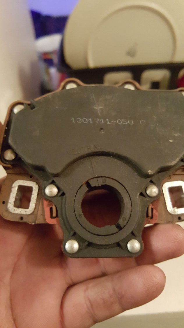

Swapped out the sensor, problem solved. I still do need to align my gear indicator though. Can't seem to find the wheel thing behind the dash near the column.
-feels like a brand new transmission.
-softened shifts a tad
-holds gears longer now
-less "gear searching"
-better power response due to proper gear selection
-torque converter lockup is happening at the proper times and not early or in and out of lockup.
For those of you looking to change this, here's what you need to do. I may add some pictures of my old connector and create a short video detailing how to PROPERLY remove wires from connectors like these.
1. Detach the cable by hand from the shift lever.
2. Remove nut holding shift lever on and set aside. I used an adjustable crescent wrench for this. Mine was stuck on pretty good. Should you have any issues, don't force it. Spray it down with liquid wrench or another similar penetrating oil, and use an appropriately sized box end wrench to avoid stripping.
3. Remove the 2 8mm mounting bolts.
4. Disconnect electrical connector and set aside old MLPS.
Note: before removing the wires from the old connector, take a picture of how and where they go in.
5. This step requires a gentle touch. You need to remove the connectors from the old electrical plug to put in the new updated plug. To do this, use needle nose pliers to pull the face of the plug off (by face I mean the plastic insert in the front of the ply. It just presses in).
From the front of the plug you should now be able to see the connectors which make contact with the blades on the MLPS sensor. To remove the wires and their conductors, use a small flatheaded jeweler screwdriver to push them from the front side out the back. They should come out easily.
DO NOT PRY, BEND, OR FORCE. YOU WILL DAMAGE THE CONNECTORS. They are fragile, and splicing a scavenged or new end onto your harness is time consuming and irritating. Just take your time.
6. Once you've got them out, it's time to put them in the new connector.
Note: Look at the and look at how they make contact with the blades on the MLPS. Ensure you insert them properly oriented so they are able to make conact. You may damage your new parts should you orient them improperly.
To insert the wires in the new connector, use needle nose pliers to pus them into their appropriate positions. You'll feel I slight click when the lock in, give them another gentle push forward to ensure they're seated all the way. Push your foam insulation and cap back on, you're all done with the connector.
7. It's time to mount your new sensor. Line the two dashes up like the picture above and install. It will likely wind up looking similar to the one you took off once adjusted.
8. Reinstall shift cable and tighten all bolts. (Anti seize is always a good idea on bolts).
9. Test by attempting to start in neutral and park.
10. Go drive it. If your sensor itself was failing, you may notice some of my aforementioned changes after I switched mine.
