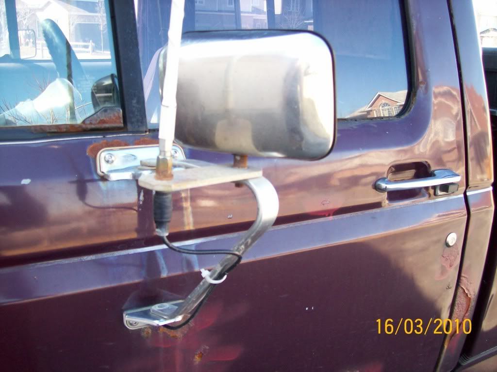

have you thought about mirror mounts ?

I cant look at the mirror mounts as my '82 has the small single point mount car style mirrors. If I had the larger trucker style mirrors I would just mount them on the mirrors and be done.
