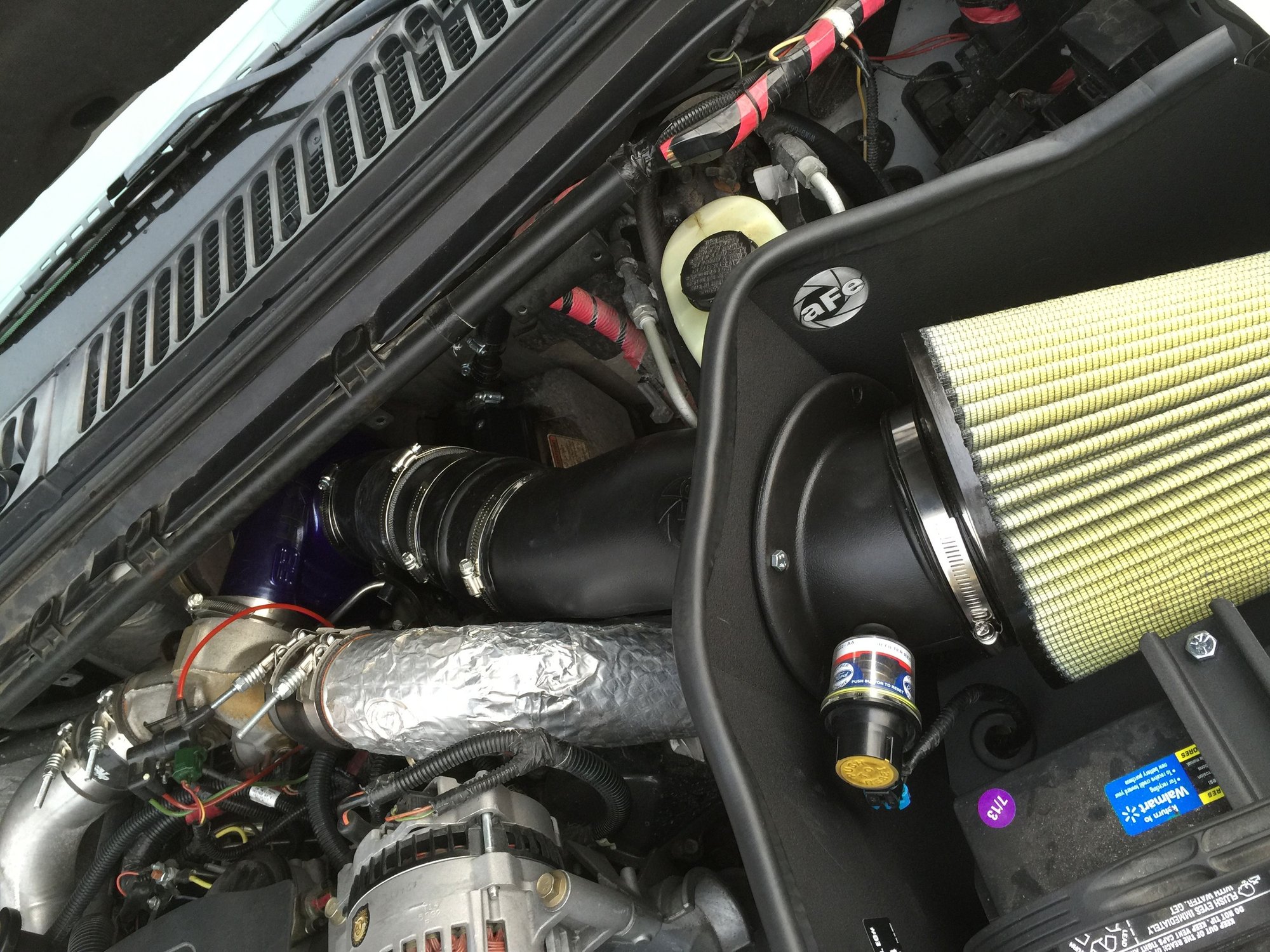

If you do that zoodad mod or whatever it's called you might consider a closed off one instead of an open element. I like the sound of the open element filters but I also have a banks monster muffler so it's still not loud enough to **** my neighbors off.
That filter didn't stay that nice yellow color for long, it's so faded now I need a sleeve. Looking back I would have rather done the 6637 or an S&B or the AIS, that AFE was waaaaay to expensive and the hp gain the intake manufactures hype about is nonsense.
