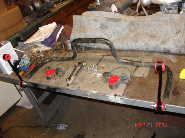

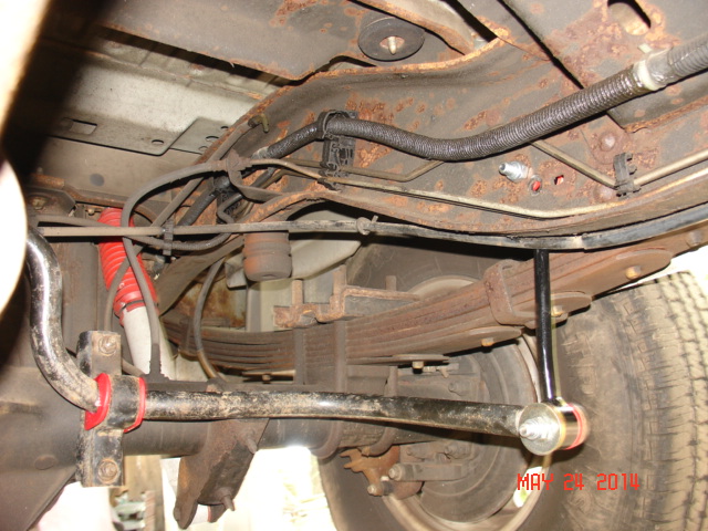

A sway bar helped my 2wd quite a bit ( a noticeable and satisfying amount). I got mine out of the 04 6.0 in my sig. I put a new bushing kit in while it was out.
Attachment 289135
Attachment 289136
