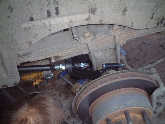

They are bars which clamp on the rear axle and extended up to the front of spring perches where they attach to metal plates you have welded on. Had them on my 01, 05 and just need to install on the 04. It helps with wander and rear steering. Basically it keeps your axle in align with the rest of your vehicle.
I love em!

radius rods
a 4x4 excursion uses a 1/2 leaf spring anti wrap bar to control axle wrap in 4 low or during full throttle acceleration from a stop, the RR are a replacement product that does the same thing. they are not going to help with body roll or trailer sway.
