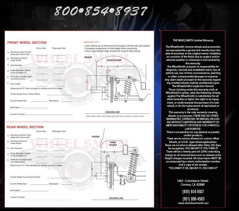

Here is the worksheet from WheelSmith that might help you:
